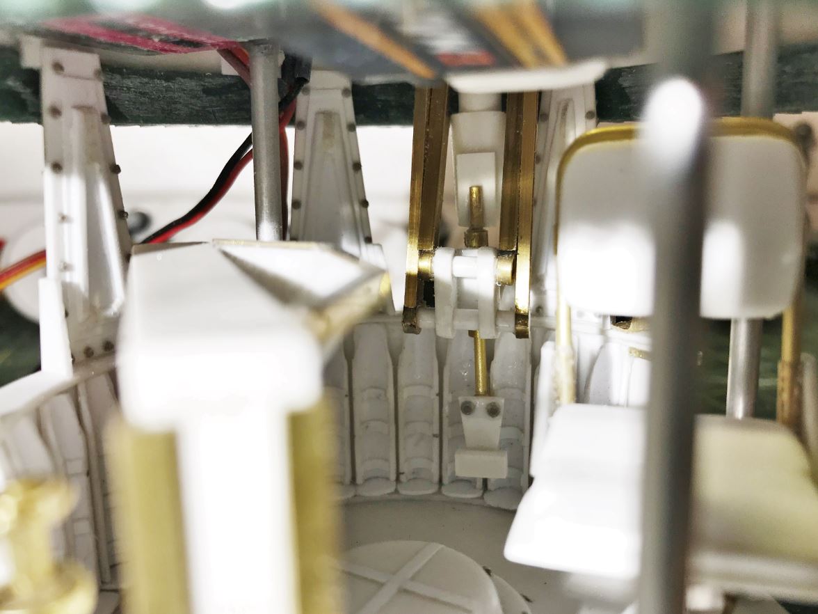

Thank you, but it is far from perfect. The plan is still to create a basic interior in order to have something interesting to look at through the doors and hatches. I want to time box this because I do not want to spend months on it.
This is the dreaded BMP auto-loader and its rocket propelled ammunition on their rotating chain.

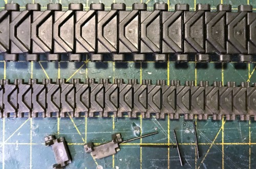

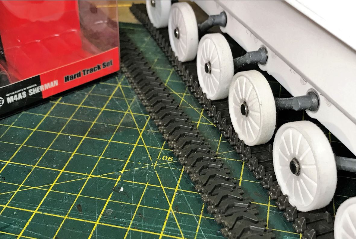

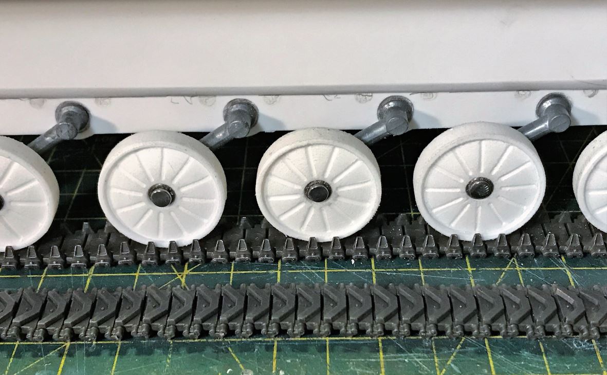

Change of plans for the tracks. I will not spend 20 hours cutting Heng Long Sherman individual tracks links to reduce them to a 17.5mm width, redo their chevron, etc, with unknown results. I found that VS 1/24 M4A3 RC tracks are a pretty good fit for the BMP. they have a width of 17mm, which is almost perfect. These are the Hard Track Set with individual links and metal connector, not the soft track set.Two packs are required and they sell for about $15 each.
BMP-1 1/16 RC build
BMP-1 1/16 RC build
These will obviously not be accurate BMP tracks because of the chevron and number of links, but they fill a big gap that I am happy to have resolved for $30, minus shipping.

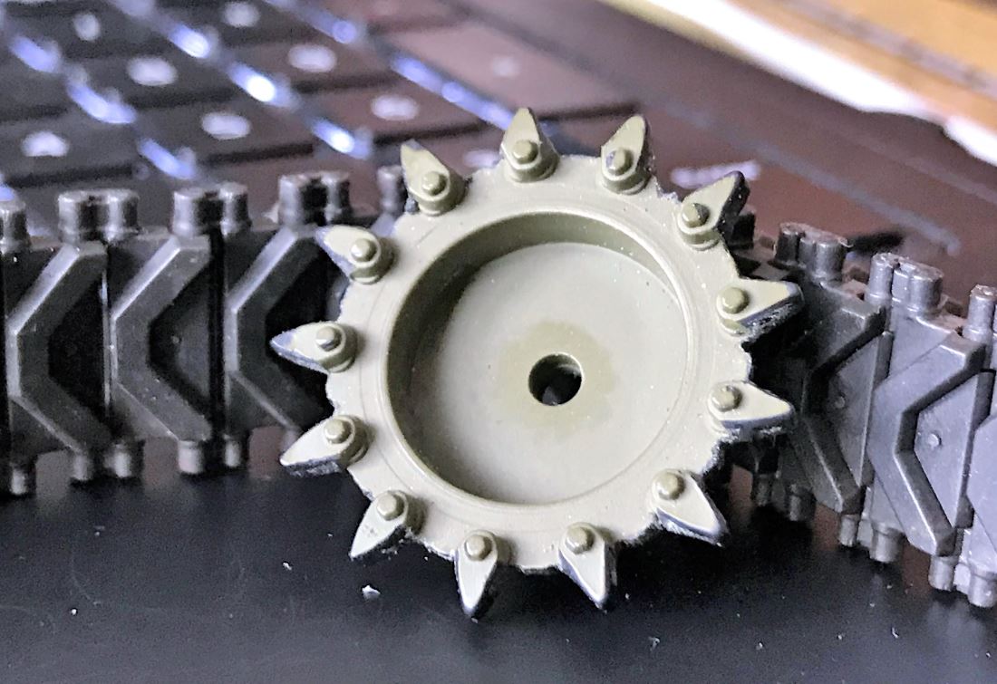

Now the challenge is to reduce the 1/16 Sherman sprockets to fit their size. It will take some engineering. I concluded that I prefer to rework 2 sprockets than hundreds of individual track links.
BMP-1 1/16 RC build
BMP-1 1/16 RC build

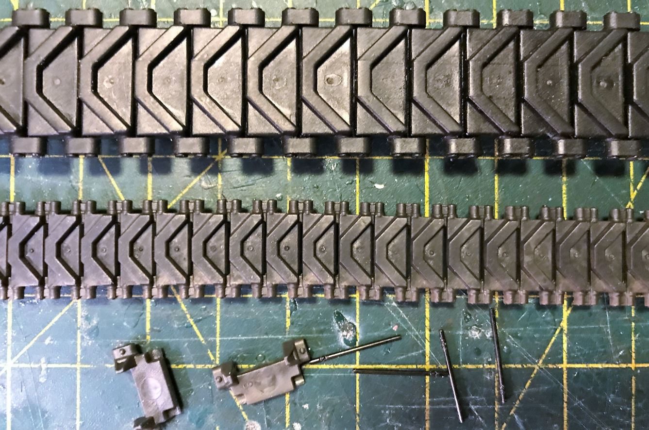

Comparison of the VS 1/24 and HL 1/16 Sherman tracks. Also present are the two spare links to show the individual 1/24 links.

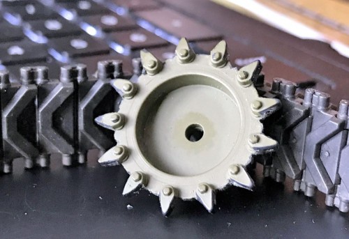

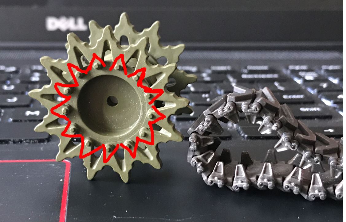

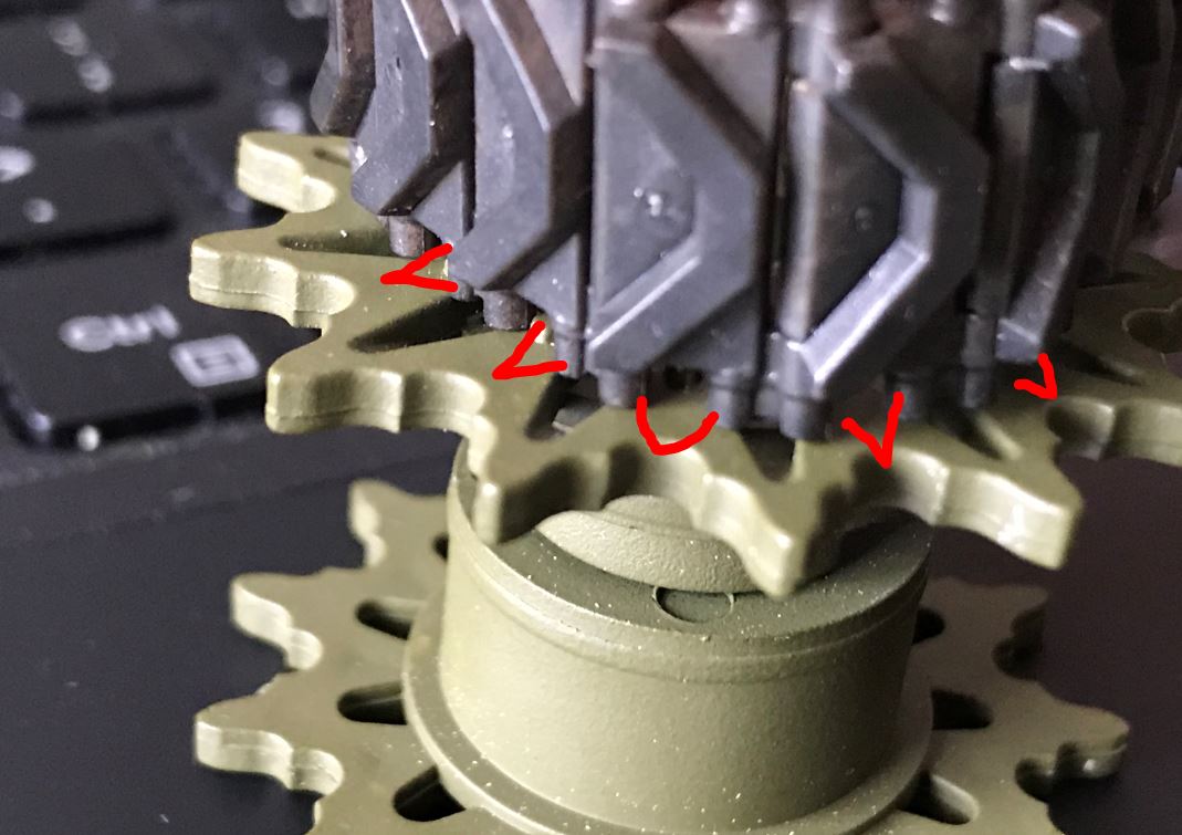

I will keep looking but it does not seem VS was selling a Sherman sprocket on its own. Plan B is to reuse the HL sprocket, I made a rough prototype below to see what it would look like.
The reduction needed is pretty drastic
Sherman 1/24 VS tank tracks

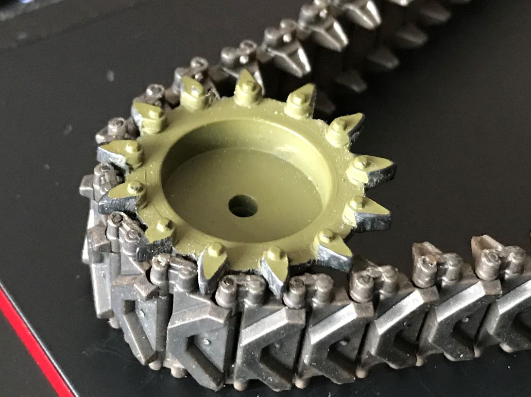

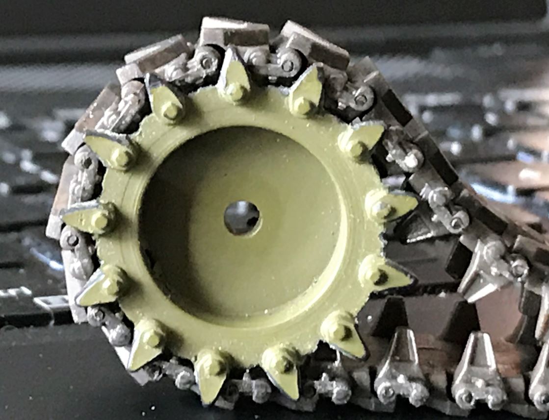

This is the single face prototype after 20 minutes of Dremel and file sanding. Looks like it would work. But the BMP sprocket is really close to the Sherman so I will keep on checking for VS sprockets but chances are low. I have not seen any in past 2 months. I will investigate other options further.

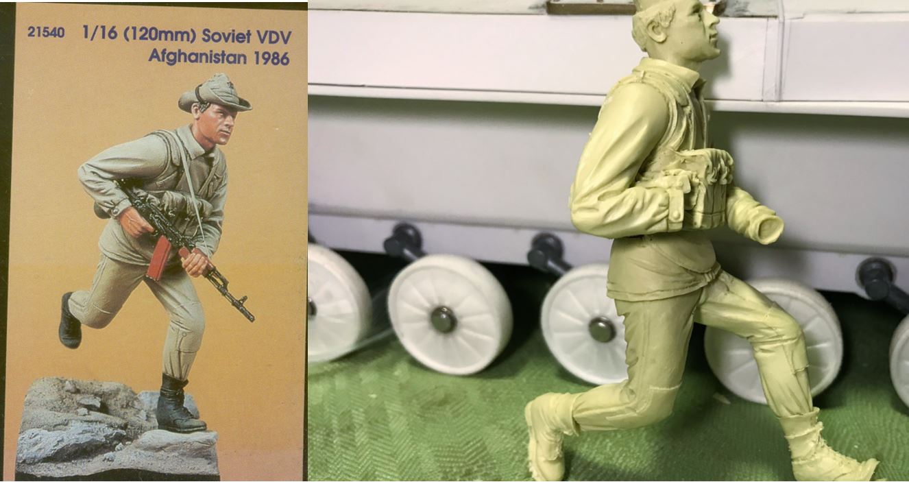

There are no Afghanistan era Soviet tank rider figures available so the plan is to convert that is available. The bulk of the infantry (3 to 5 men) will be made of the Kirin VDV trooper below. Although the pose is of a running man, it can easily be modified into a sitting position because the legs are folded. He is armed with an AKS-74, the folding stock version of the 5.45mm calibre AK-74, not the older 7.62mm AK-47 or AKM. He wears a boonie hat, body armor, magazine pouches on the front torso, a water canteen and bayonet.

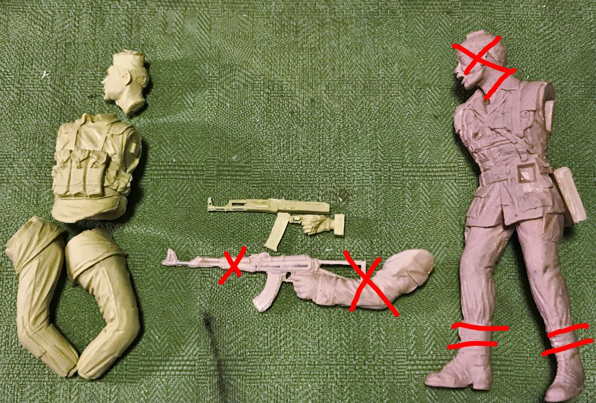

Below are the parts coming with the Kirin figure. Although of fine quality, the major disappointment is the weapon, partially moulded within the hand and not molded stand alone. More equipment and grenades would have been nice too.
BMP-1 crew and infantry 1/16

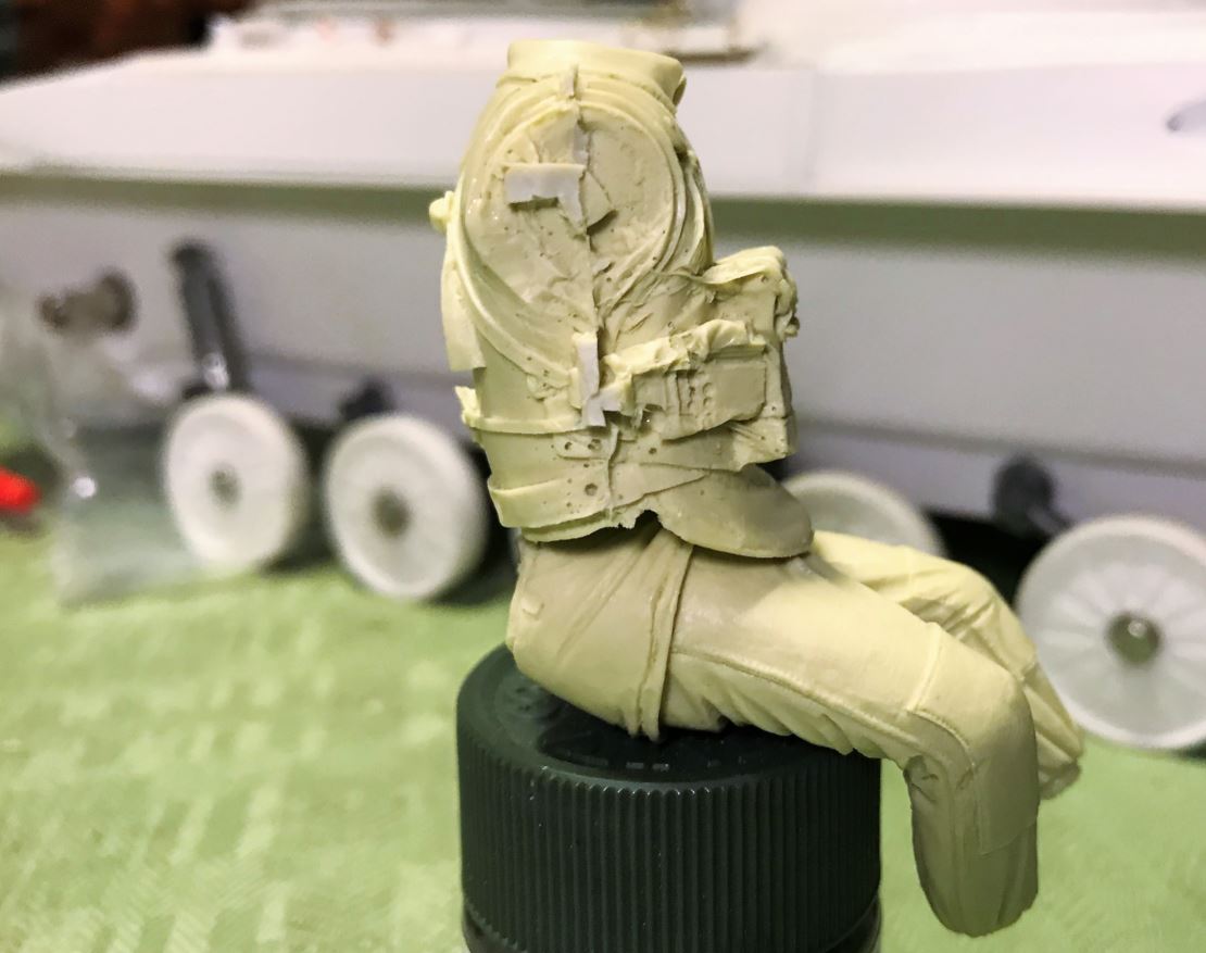

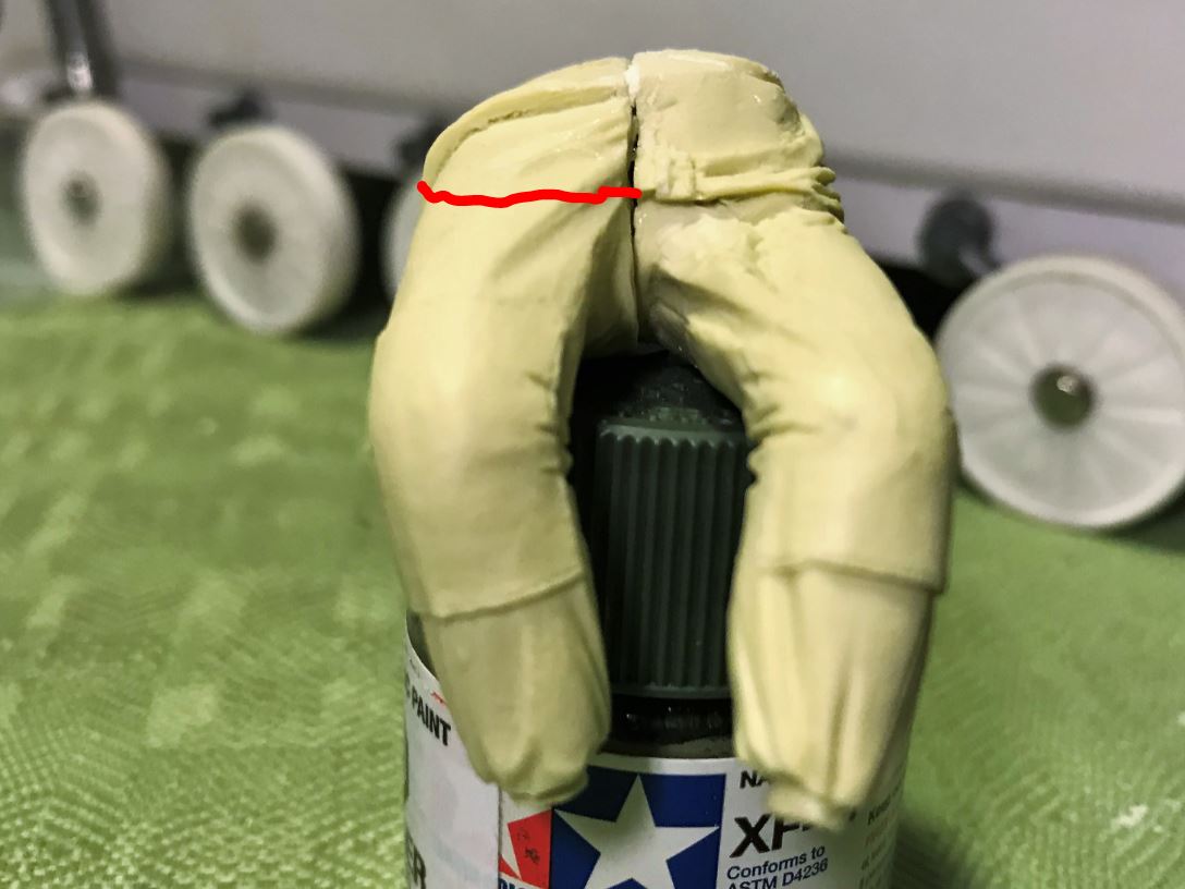

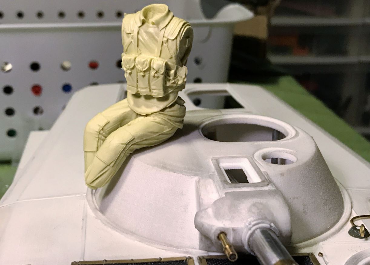

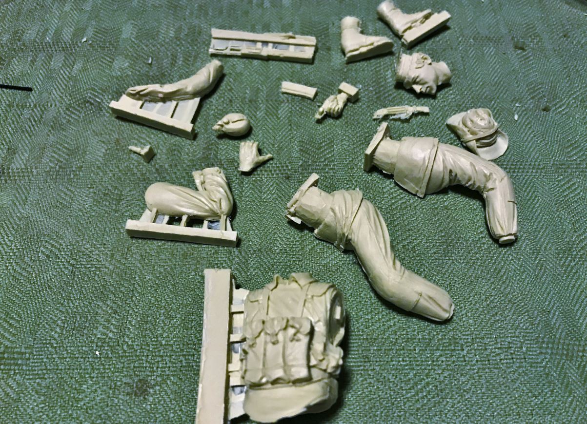

To make a sitting figure, all is required is a realignment of the legs at various angles for each men, basic rearrangement of the upper pants and lower jacket, and putty to fill in the gaps.
Dry fitting tests with the uncleaned resin parts just to see.
Various poses can be created.

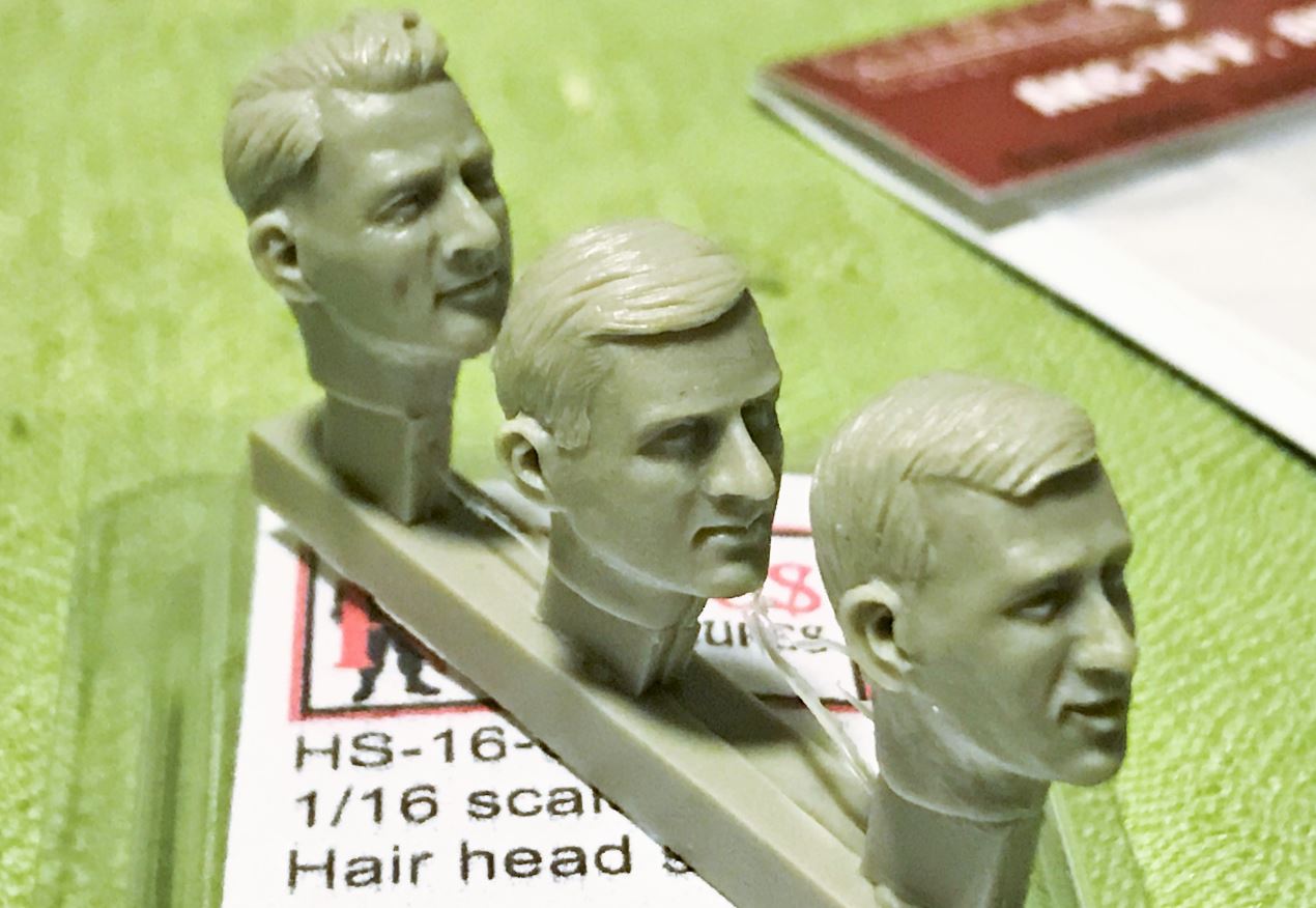

I find a resemblance with George W Bush... Separate 1/16 heads were ordered to create different figures.

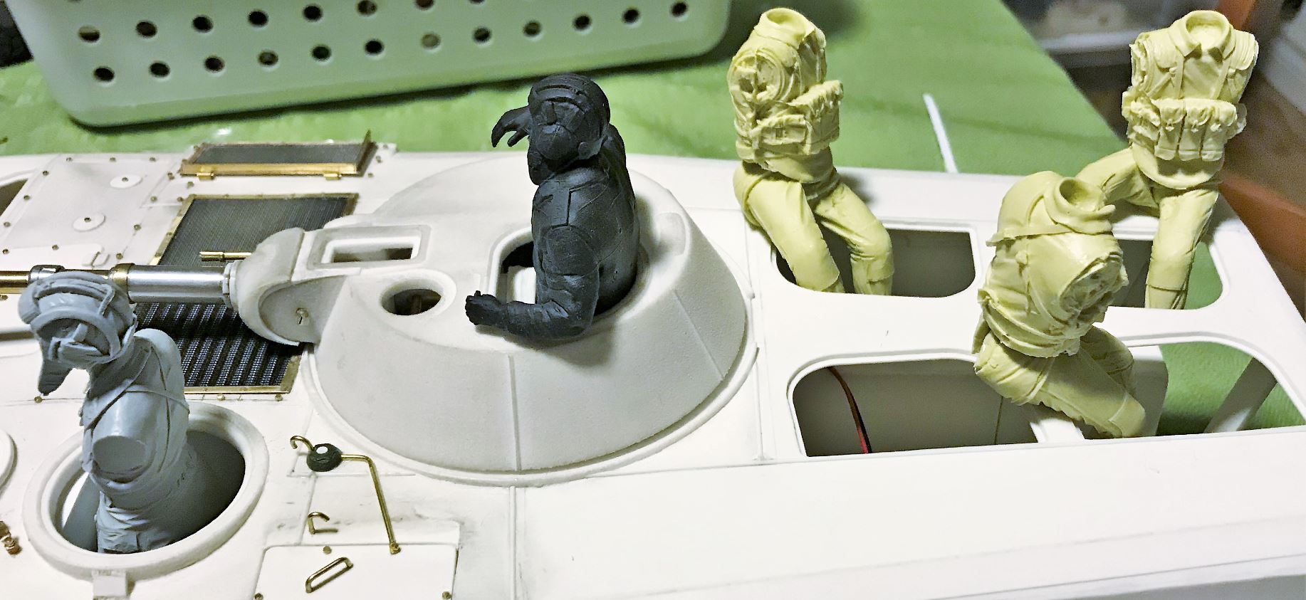

Various arrangements will be studied, first need to install all hatches and finish the interior.

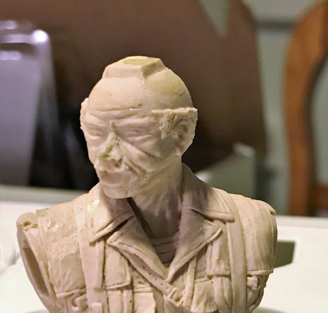

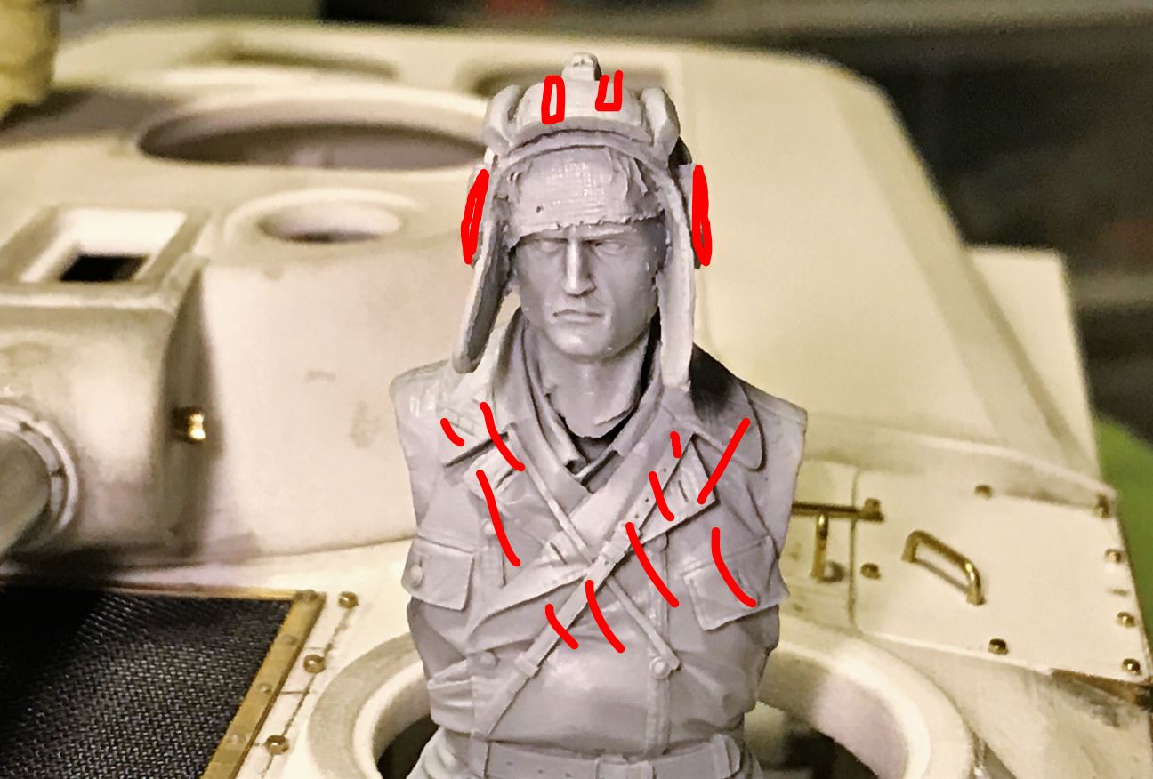

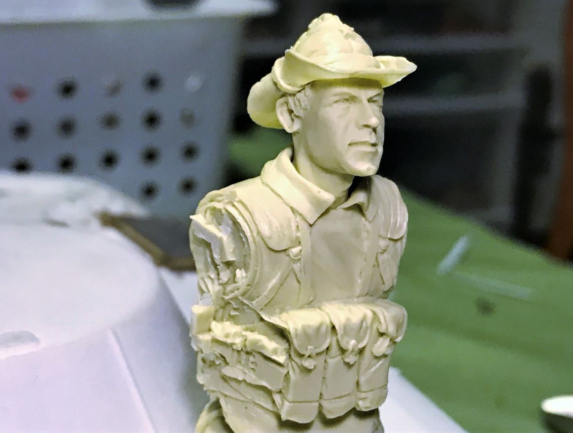

I needed a commander figure. The Maim T-72 figure presented earlier this month will be used as the turret gunner. I have selected the excellent Quasar Soviet WW2 tank commander as the base for modifications into a lightly wounded more modern BMP commander.
continuing on following post
Re: BMP-1 IFV - Soviet army, Afghanistan 1980s - Build
Its tanker helmet will be modified into a more recent version, similar to the one used on the MAIM figure. The uniform will also be simplified into a standard field jacket and pants.

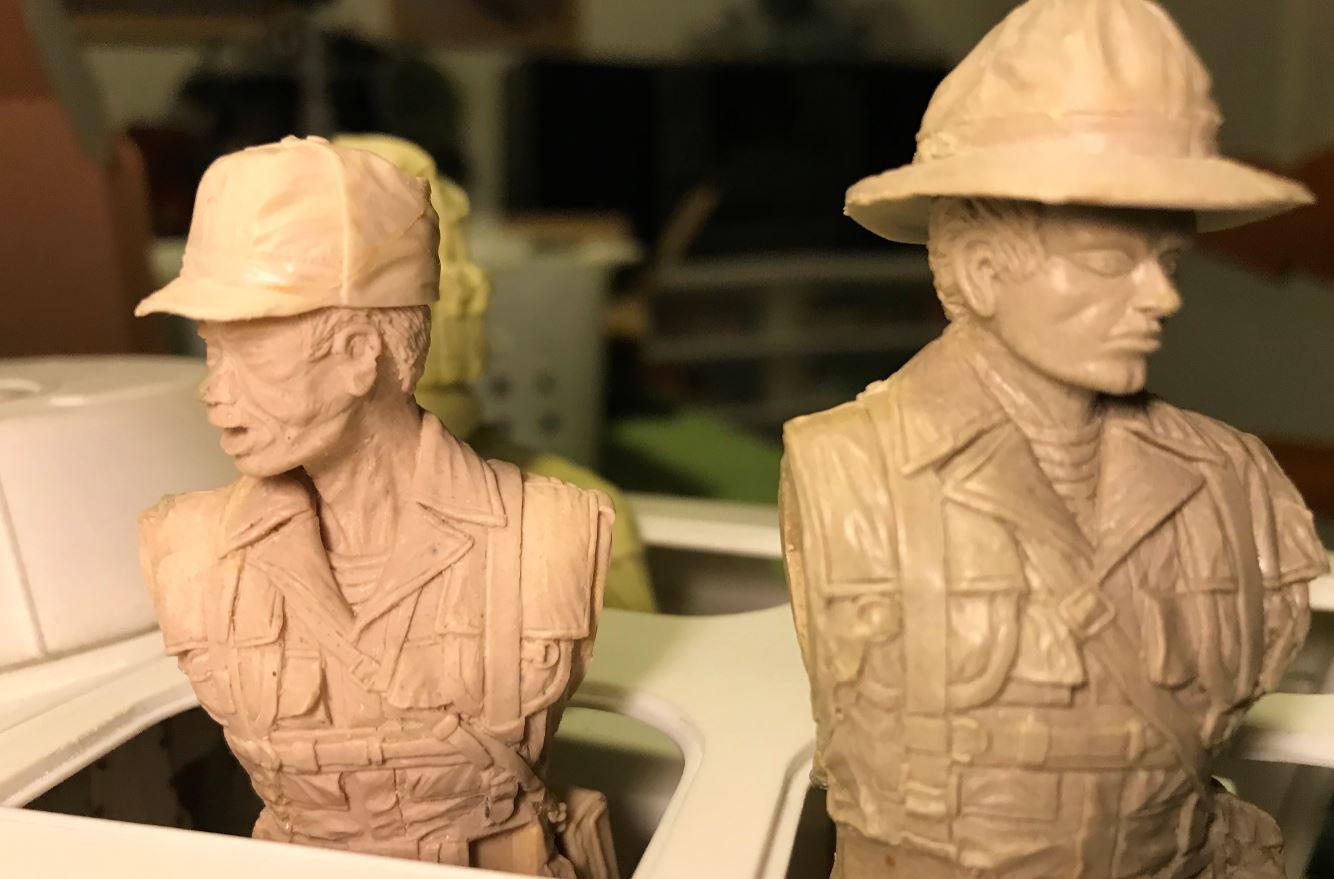

Their heads are not good and need to be replaced or improved in some ways. The plan for the figure on the left is to make this guy an embedded Afghan DRA (Democratic Republic of Afghanistan) trooper, with cap and AKM rifle. The plan for the one on the right is to make it the squad leader, armed with an AKS-74U, the shortened version of the AK-74.
Soviet BMP-1 crew and infantry 1/16 RC

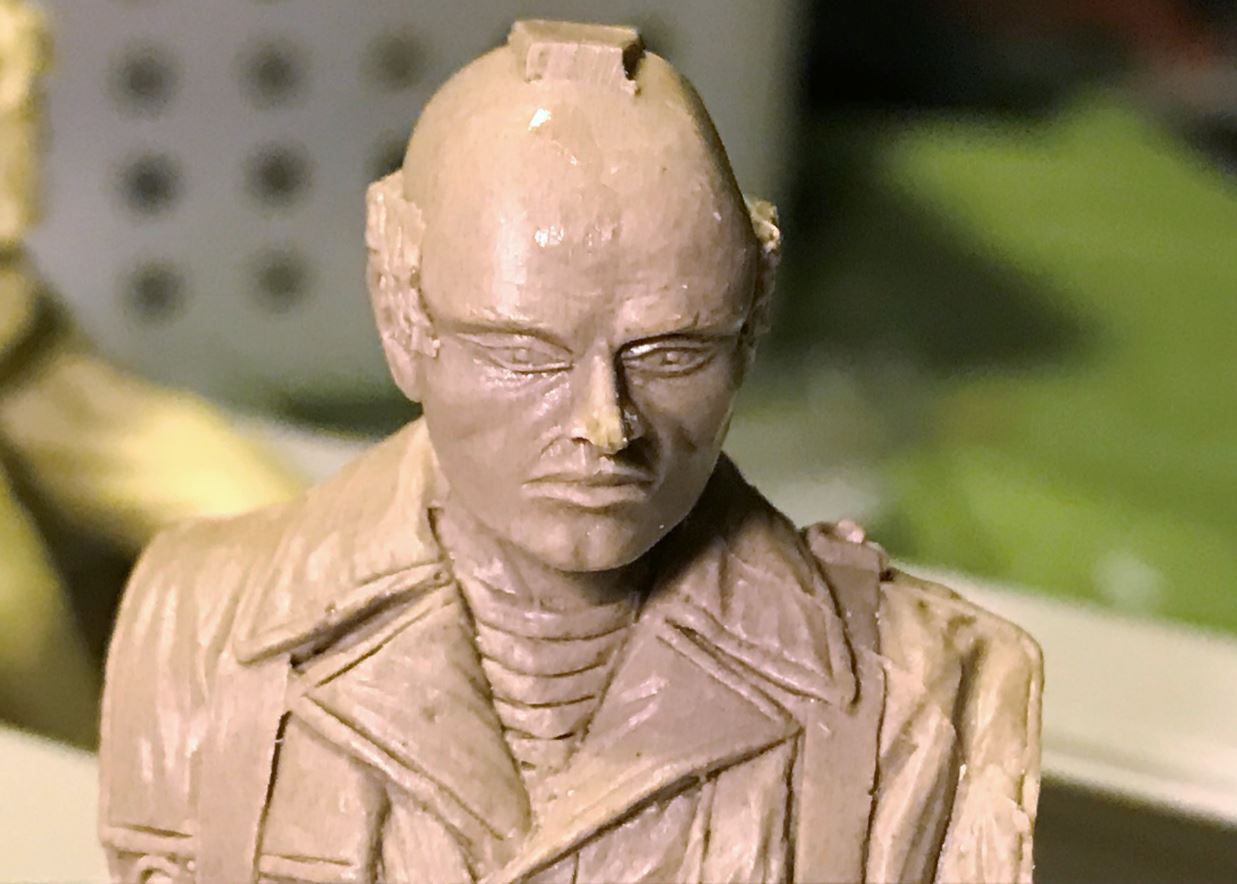

The carving on this face was either badly designed, or had some casting issues. He has a moustache but the facial lines are not realistic as they are.
This face on this one is a bit better but the eyes could be improved.
The CIFI figures and all its equipment are oversized compared to the Kirin figures. Legs will need to be shortened. The AKM rifle that it came with is also oversized, or maybe it is the Kirin elements that are undersized, likely both. The use of these two CIFI figures will be based on a comparative study with the Kirin figures. If I find there is no way to integrate them well, they will not be used.

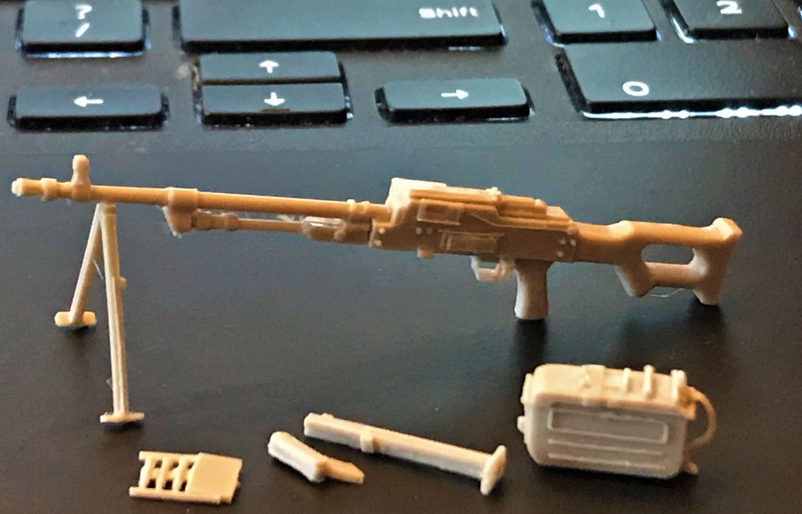

This is the Reedees PKM infantry machine gun that will be used on one of the Kirin figure as a Soviet Rambo, with cool ammo belts around his neck.

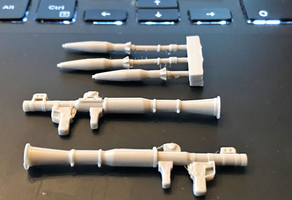

I search for a Dragunov SVD sniper rifle and the portable RPG-26 AT rocket in 1/16 scale but none are available. This Reedees RPG-7 will be used with the Afghan DRA soldier, in addition to his AKM.

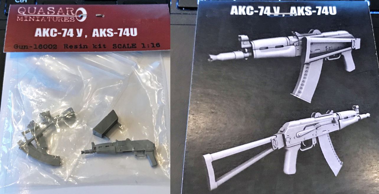

Finally, this is the Quasar AK-74U short version that will be used by the squad leader. The Soviet designed it as an equivalent to the US M-16 (XM-177) Commando version.
