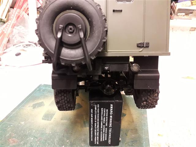

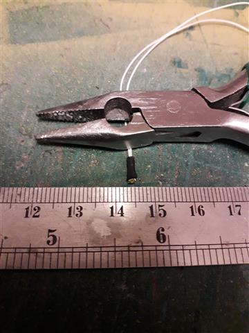

Re: Wpl ural truck
Hi chaps.
Just hollowed out the rear light clusters on my Ural and fitted 1mm red leds and then fitted clear lenses so from the rear they appear transparent but then light up red when switched on.
Regards
Sub.
Regards
Sub.
