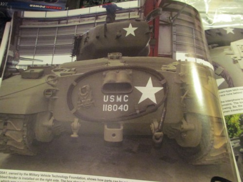

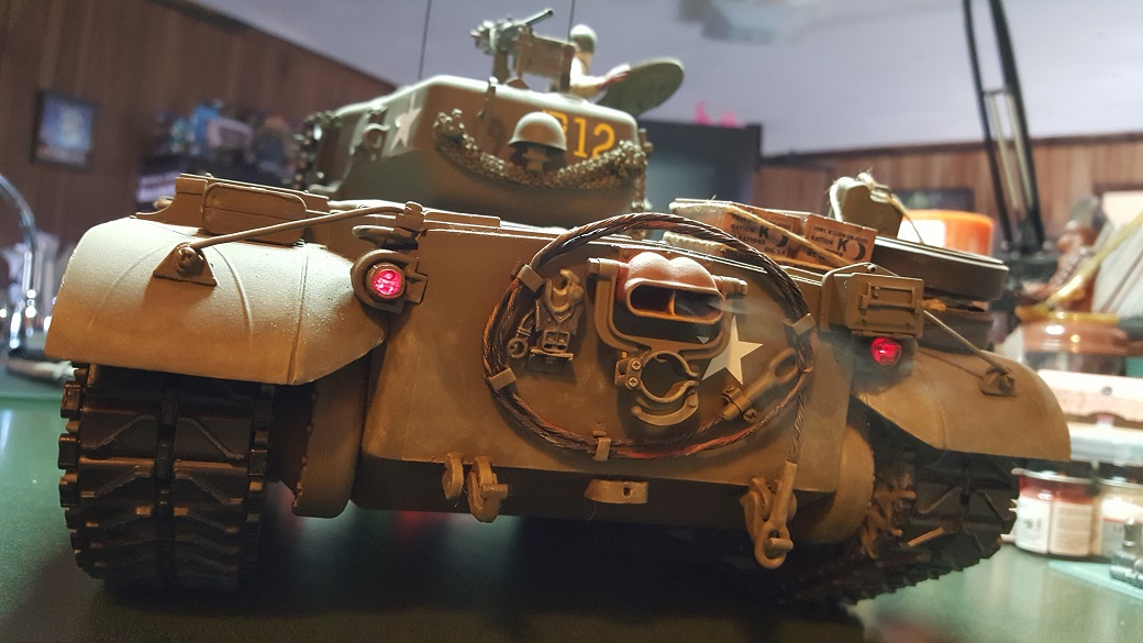

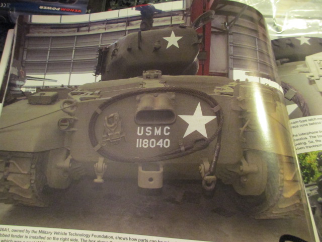

Tom, The SP is really, really coming along. The only thing that I can even think that you might add is a little more detail to the rear plate. Maybe some styrene strip to make holders for the tow hook, etc.? The tank is such a beauty as is.
1950 Pershing Rear Bulkhead

As we've come to expect, Tom, the standard of finish is top notch. Of all the various detailing gems, I particularly like the rust, indications of heat, and the pitting on the exhaust 'outlet'. I'm not sure how else to describe it, as it resembles a manifold, rather than a twin exhaust pipe. But it's certainly very eye-catching. :thumbup: Whose product (or products) did you use to get that effect?

Painless, sadly I think I'm too far along but something to consider for future builds
Looking at my reference though the hook should really be fitted! But there doesn't seem to be a mount, strange!
43rd the rust is a product by deluxe materials call scenic rust, it comprises of very fine iron filings, a binder (seems to be thinned PVA) and an accelerator (copper sulphate maybe or just vinagar!) You mix the binder and filings and brush on, once dry apply the accelerator and it creates real rust! I've only tried it on exhausts but it looks from others work very versatile in the effect you can get.
Now here comes the scary part, the final dull coat. I've read soany horror stories of projects having a final coat and the lacquer blooming so much the model goes white and is a write off. With buttocks suitably clenched I tested on a wheel. Hmm was that a hint of lightening. No just the lighting. So took the plundge and did the tank. I'm pretty happy with the final result. Will let it properly cute and then on to mud glorious mud!ImageImageImageImageImage

I built the tow hook mount on mine from a reference book from Squadron. Following along, Doc. The SP was a rare beast and you have done it complete justice.
A picture from the M26 Pershing Walk Around book
