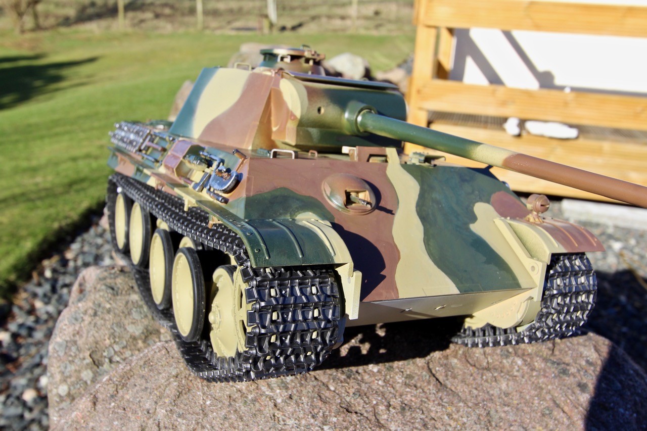

Using the rattle can, I make camo templates/ stencils out of the absorbent sheets of paper you'll often find scrunched up, and used as packing, in Amazon boxes.
Here's a pic of me working on my Tamiya panther G. The Tamiya Panther is the unwilling recipient of the infamous 'Old Rope'...
Rattle can painting- masking a Panther. Pic A
Ignore the bits of paper dust and detritus on the hull.I forgot to blow it away before taking the pic.. :/
Incidentally, I've discovered since that wetted jeycloths are a good means of holding down curling paper templates. Effective, this is, so long as the paint they're sitting on is already dry.. ;)
Rattle can painting- Panther Pic B
It might not look it, but it's almost Zero degrees out there (Midwinter). I snatched an hour or two of midday Sun to air these. I don't want to have to wait until late Spring or early Summer to use my airbrush; but i have little choice. :problem:

Still a way to go with the painting. Touch ups and corrections, here and there, as well as some weathering down the seams and on the 'bolt on' accessories. Obviously, I still have the lower front plate to do. The rear is untouched as well. I don't want to tri-tone the wheels; but I'll simply age and 'grease' the bolts and wheels caps. :think As usual, click to ENLARGE the photos:
Rattle can painting- Tamiya Panther Pic B
Rattle can painting- Tamiya Panther pic A
As might be apparent from the first photo, the rattle cans are Tamiya's own brand.
