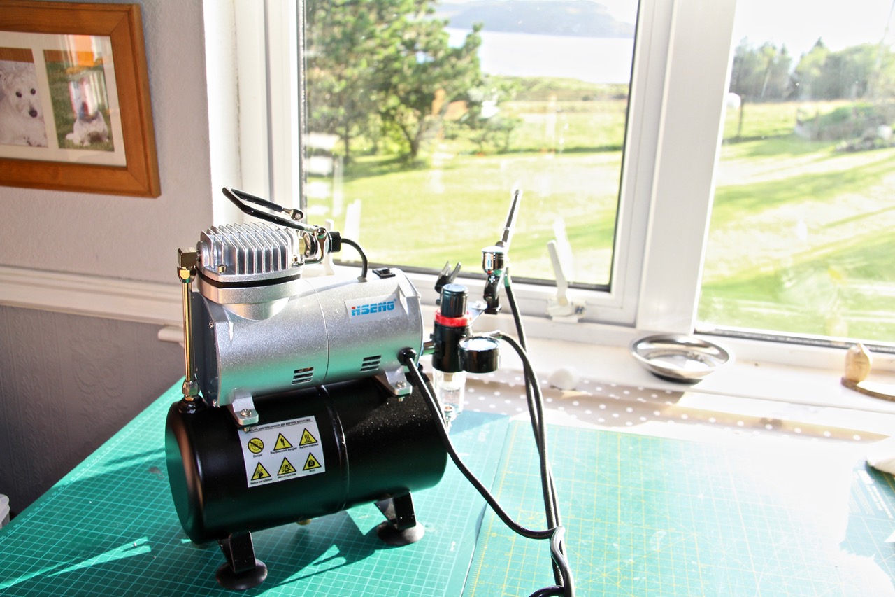

I favour the approach you've just outlined, Gary, that is; one of working from light to dark. Until now, I've been mainly concerned with finding primers that do what they're supposed to. Tick. Then, I've been finding ways to lay on topcoats from a rattle can (Tamiya mostly) by using home made paper stencils to help create Camo patterns..tick.. and then to mask areas off that don't need painting. Tick. At this time of year..and not having a heated workspace (shed is too cold), it takes too long to set the airbrush up. Cross. At the same time, it doesn't like cold weather. :thumbdown:
This, by the way, is my compressor:
Current compressor and airbrush..
Midwinter in the Highlands, is not ideal for painting in any medium, but the airbrush suffers most. I can do a couple of (warmed) fast sweeps with a Tamiya rattle can in my porch, with the windows open and a mask to prevent my lungs from being coated with Dunkelgelb... 8O . Even then, it's not easy. I really need to be able to use the Airbrush for finer detail, not rattle cans, but that will have to wait until the Spring... :problem:

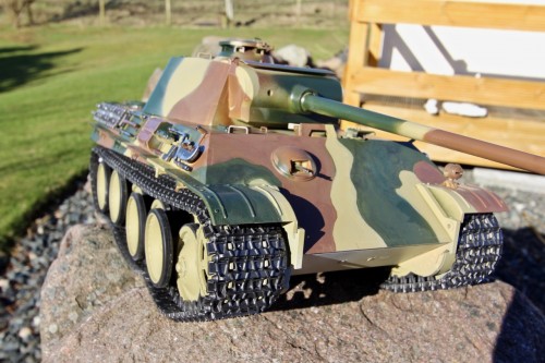

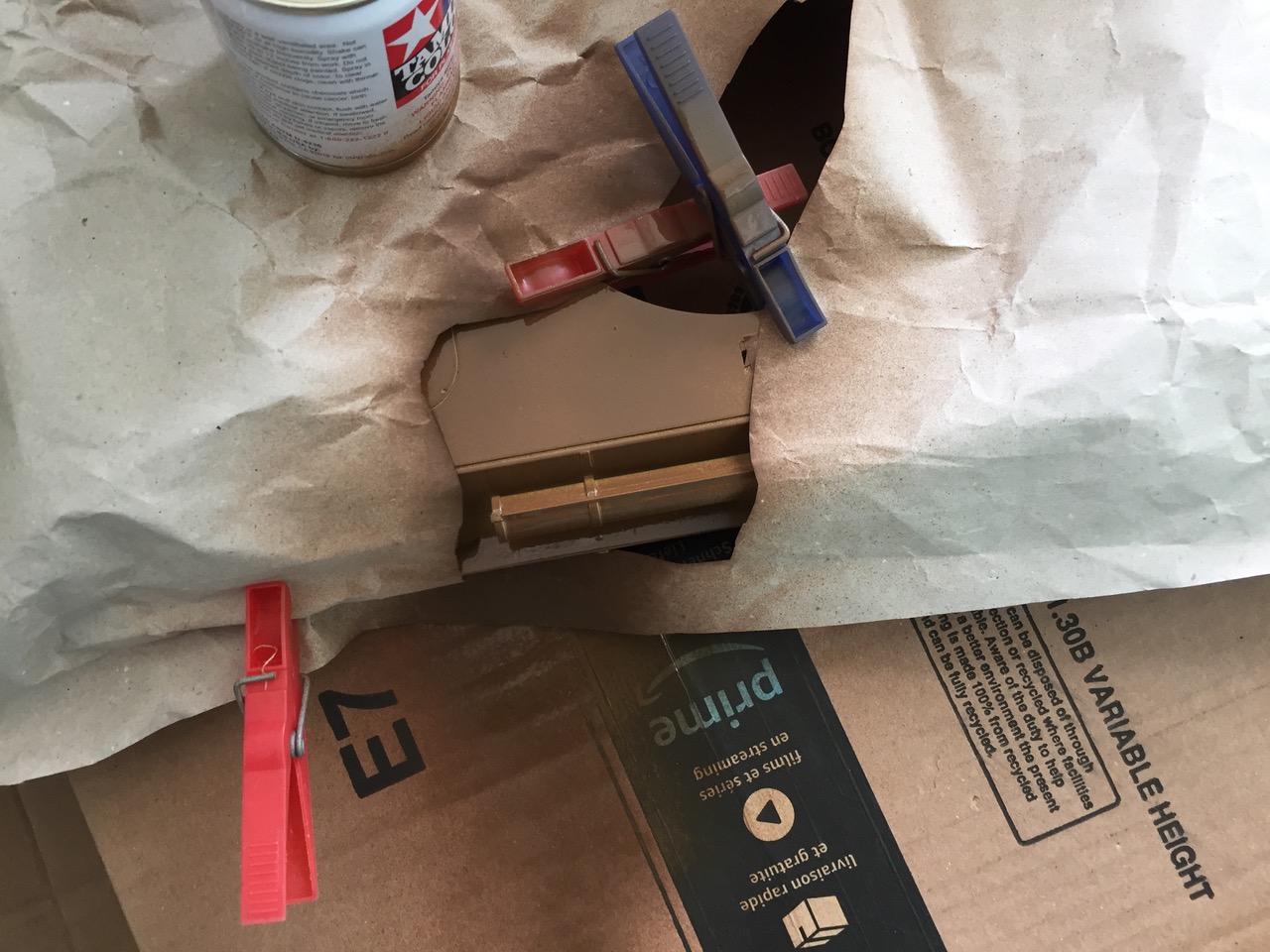

Using the rattle can, I make camo templates/ stencils out of the absorbent sheets of paper you'll often find scrunched up, and used as packing, in Amazon boxes.
Here's a pic of me working on my Tamiya panther G. The Tamiya Panther is the unwilling recipient of the infamous 'Old Rope'...
Rattle can painting- masking a Panther. Pic A
Ignore the bits of paper dust and detritus on the hull.I forgot to blow it away before taking the pic.. :/
Incidentally, I've discovered since that wetted jeycloths are a good means of holding down curling paper templates. Effective, this is, so long as the paint they're sitting on is already dry.. ;)
Rattle can painting- Panther Pic B
It might not look it, but it's almost Zero degrees out there (Midwinter). I snatched an hour or two of midday Sun to air these. I don't want to have to wait until late Spring or early Summer to use my airbrush; but i have little choice. :problem:

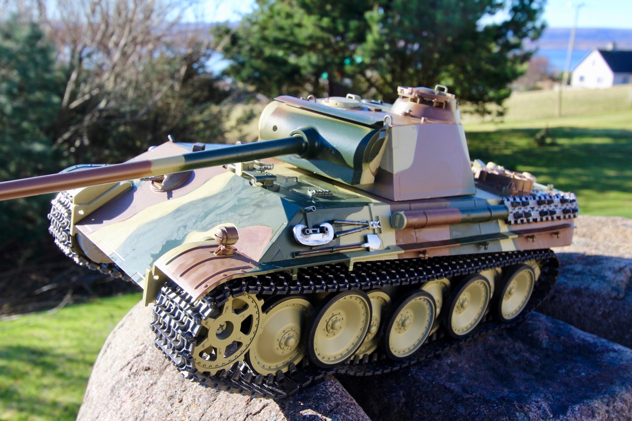

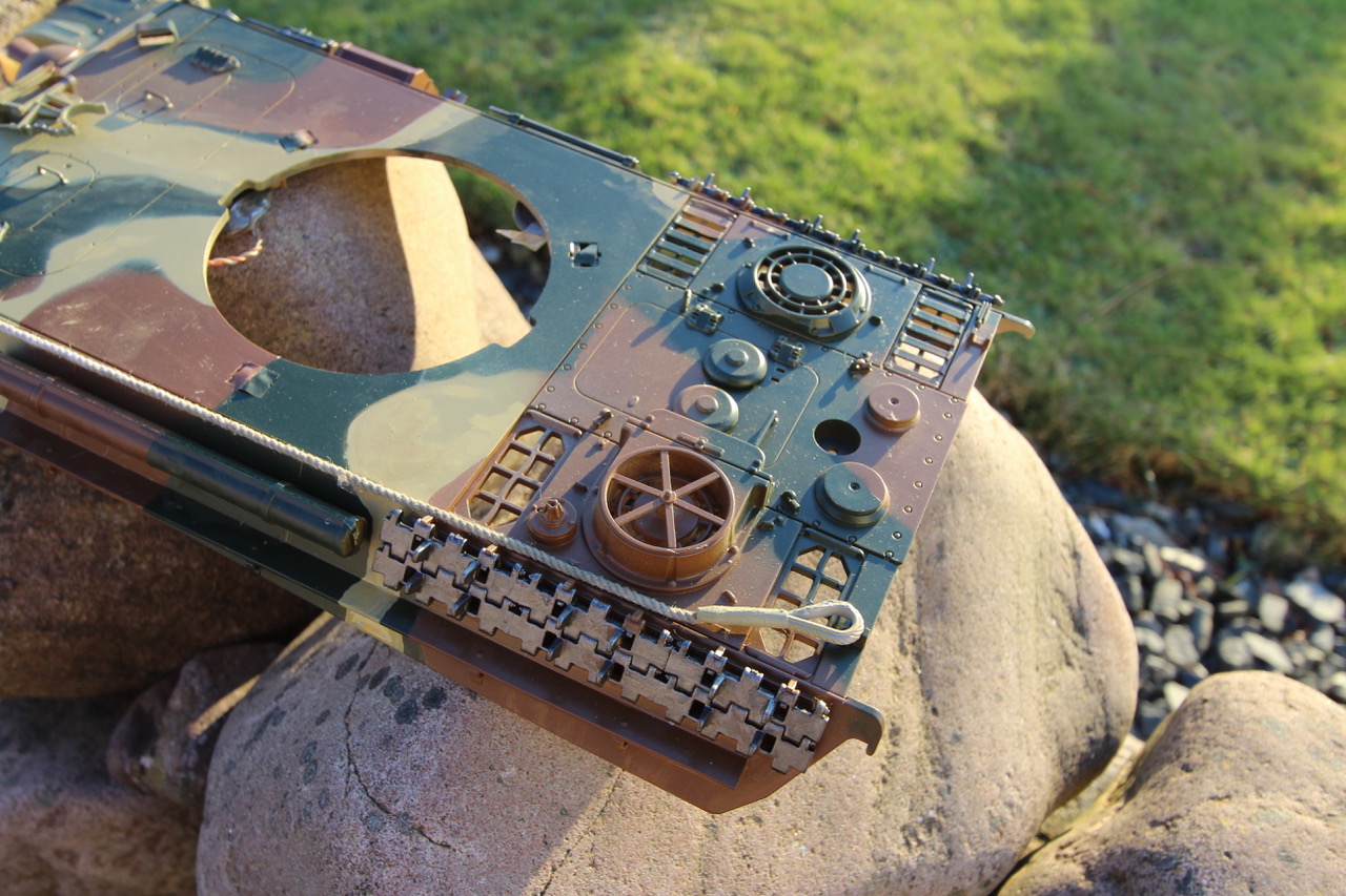

Still a way to go with the painting. Touch ups and corrections, here and there, as well as some weathering down the seams and on the 'bolt on' accessories. Obviously, I still have the lower front plate to do. The rear is untouched as well. I don't want to tri-tone the wheels; but I'll simply age and 'grease' the bolts and wheels caps. :think As usual, click to ENLARGE the photos:
Rattle can painting- Tamiya Panther Pic B
Rattle can painting- Tamiya Panther pic A
As might be apparent from the first photo, the rattle cans are Tamiya's own brand.

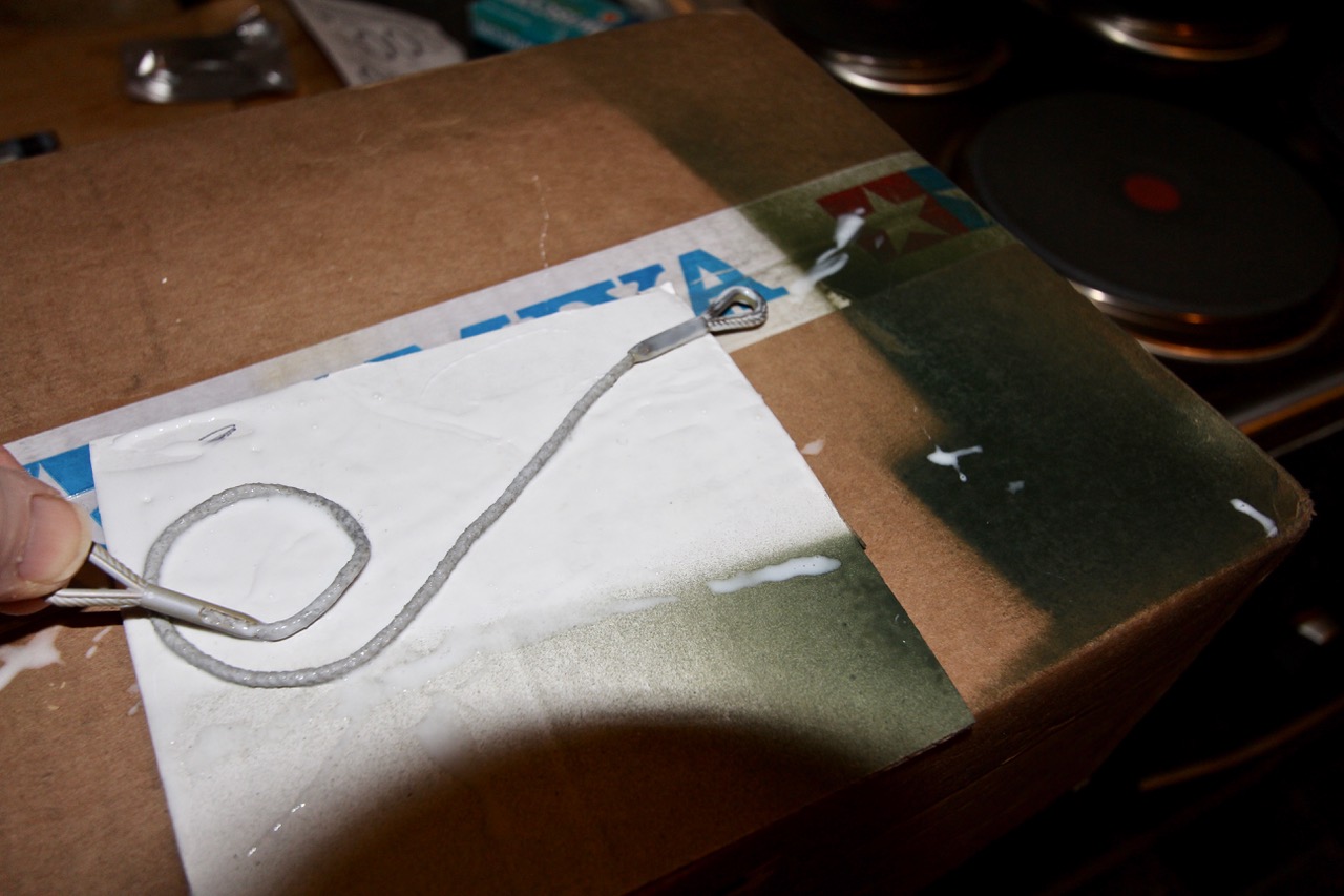

As the saying goes: 'what goes around, comes around. So, here we are back with the 'Old Rope.'
Following the earlier suggesting that the string can be sealed with PVA glue, I made a small pond of it to drag the string through:
Old Rope trick- and PVA white glue

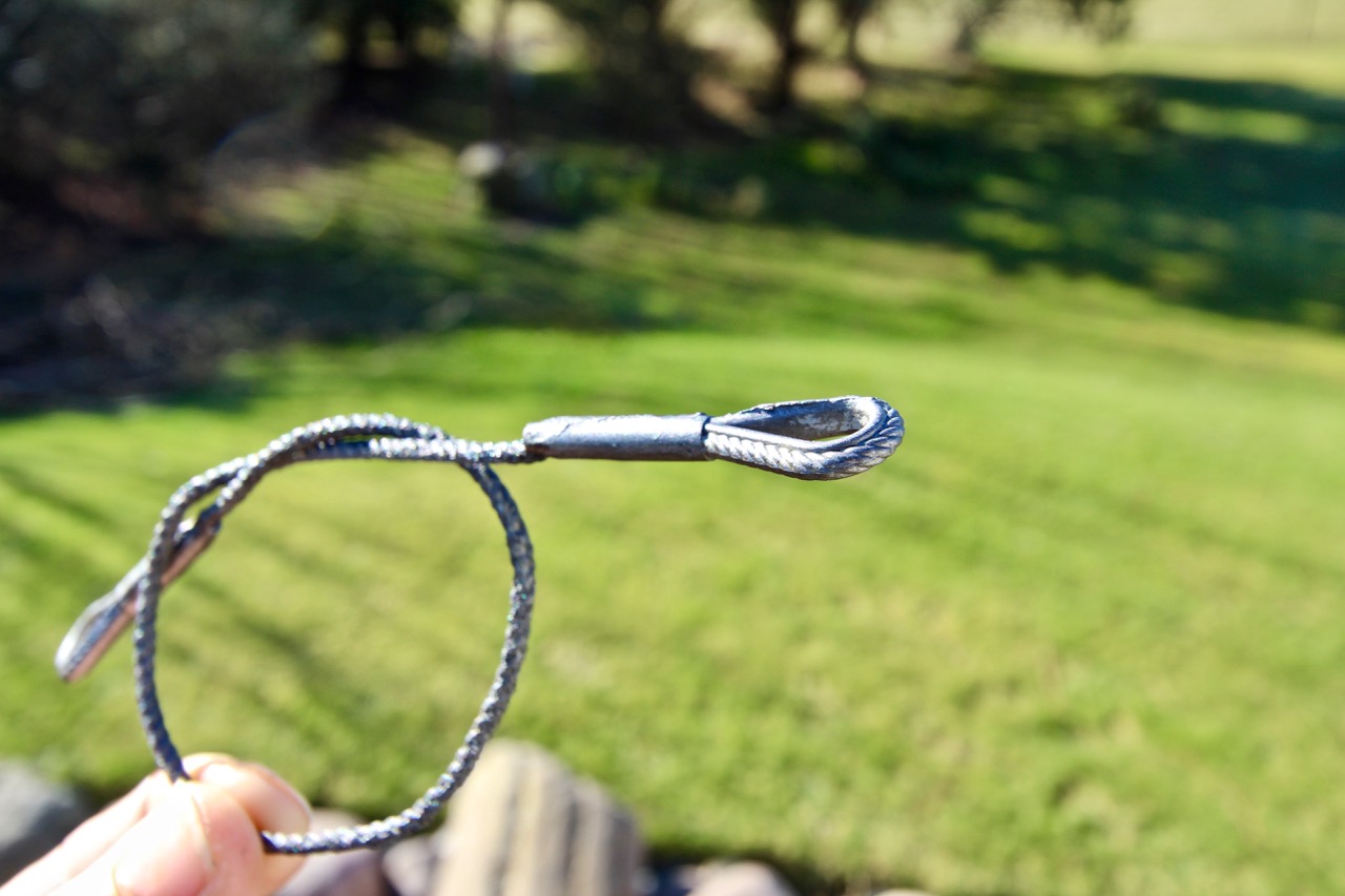

and...this is the result (superior to effects of the infamous 'blue pill' some abdominal thrill seekers crave..not my thing, personally :lolno: )
Old Rope- after PVA treatment

..and now after the wonders of PVA enhancement, It's possible to use Tamiya's cheapo 'cable' to do this:
Indian rope trick with Tamiya string
:eh: :lolno:
Re: Tamiya-money for old rope?

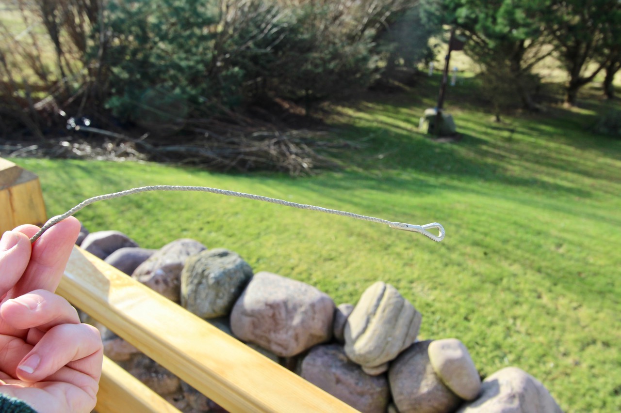

Here's the finished item, though, painted with XF-Metallic Grey
Old Rope painted with XF-56- Metallic Grey
But here's the catch. After treating the string with PVA, the damned string thing has shrunk @) . Previously (and you can see it fitted in an earlier pic), it was cut to the length suggested by Tamiya in the Panther build instructions, and it actually fitted on the Panther correctly. Now it's 6mm too short :wtf: :lolno:
Solution? Well, I've ordered a brace of cables for the Panther G from Steve at Welshdragon.... :/
What goes around, comes a round...but a little shorter every time :haha:
