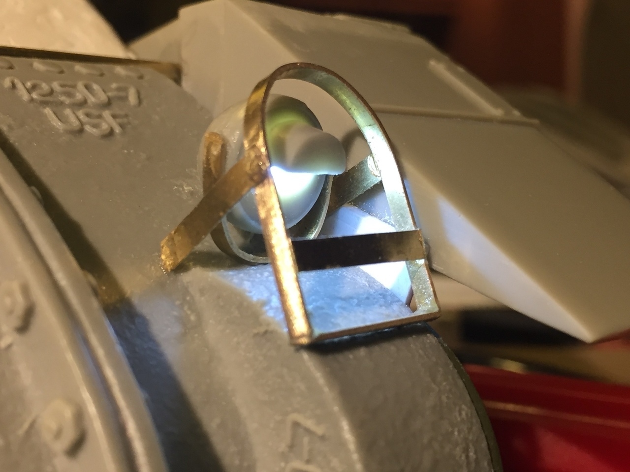

These are the head lamps and guards, both totally different than on a Sherman.
Vandra Ram II tank
Vandra Ram II tank
I had difficulty finding references on them. Research is complicated by the fact that there is no surviving Ram tank that still have these intact. We're left with some blurry wartime pictures to interpret and no measurements available. I saw 2 Kangaroos that have them but they show a different installation, one Kangaroo has the guards strait up at 90 degrees, the other one showing it inclined. Modellers need to be careful when using restored vehicle as reference, the restoration may or may not be accurate, which one is... or maybe there were many arrangements... I decided to put them inclined as it seems to make more sense that obstacles would slide over them instead of crushing head on.
Vandra Ram II tank
Vandra Ram II tank
The solid resin Vandra head lamp parts were drilled and a 3mm white LED was inserted inside. I wish they were in metal but I left enough resin so it is not too trans lucid.
Vandra Ram II tank
Vandra Ram II tank
Vandra Ram II tank
Vandra Ram II tank
I will need to put a metal plate in front of this one to mimic the light only going through the slot.
