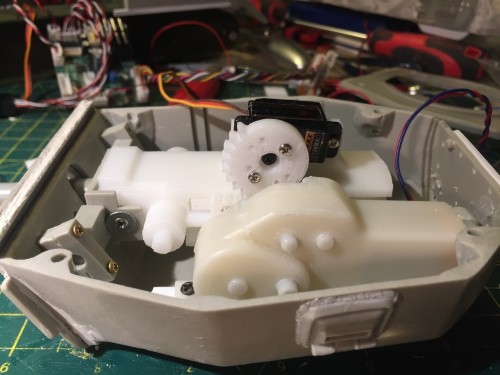

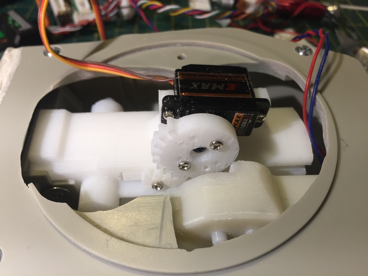

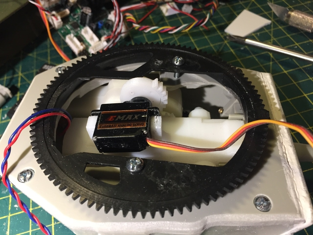

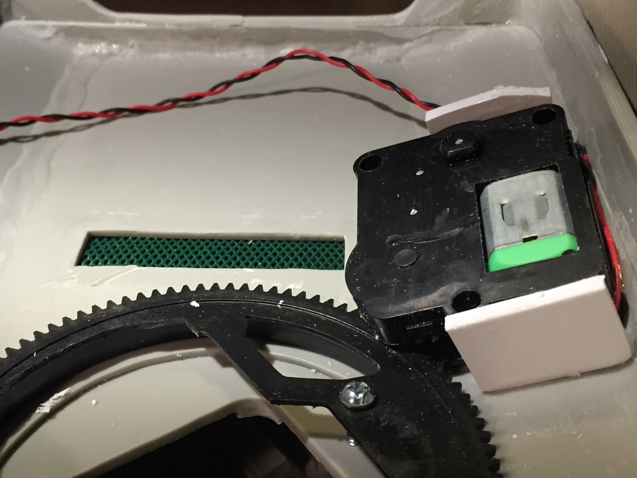

This is the electronic and gear installation for the turret.
The turret is quite deep into the top of the upper hull and the only way the dents of the HL rotation unit could reach the turret ring is by placing the rotation unit at this angle, on the back side.

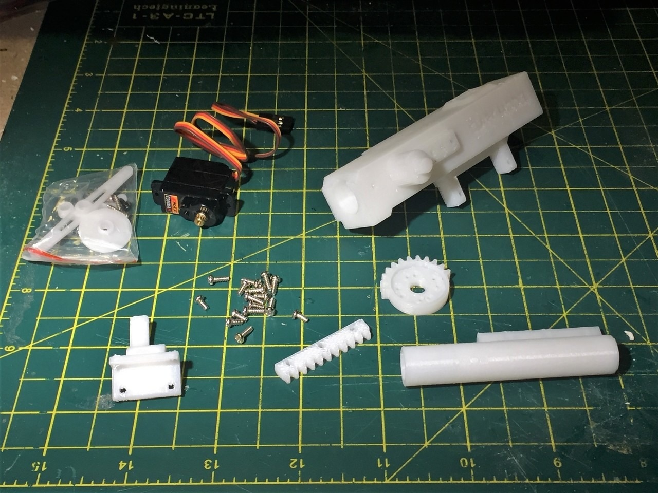

The Clark Model 16011 universal recoil is quite simple to assemble. I was happy to see that all the parts are cleaned up, just need some sanding.

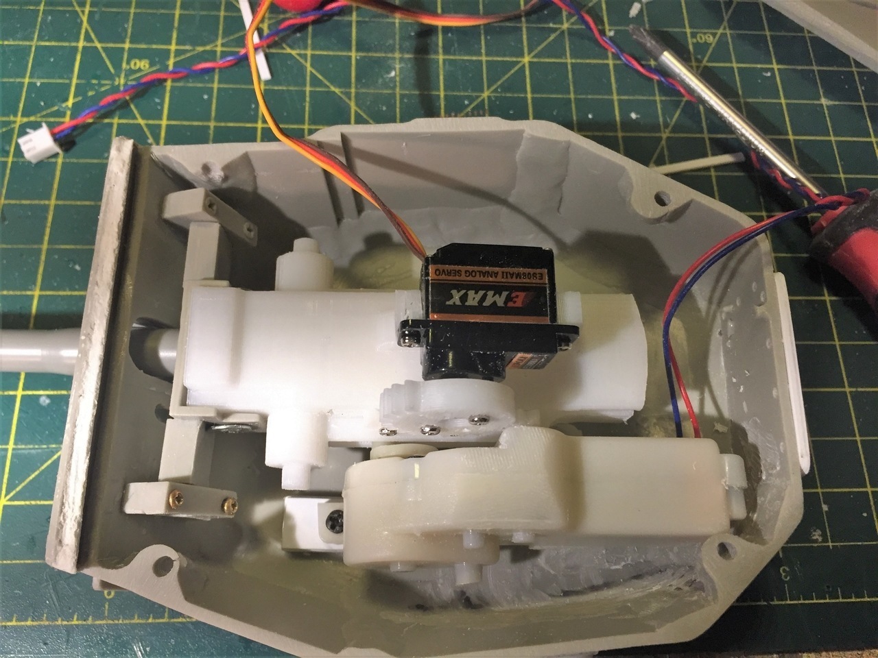

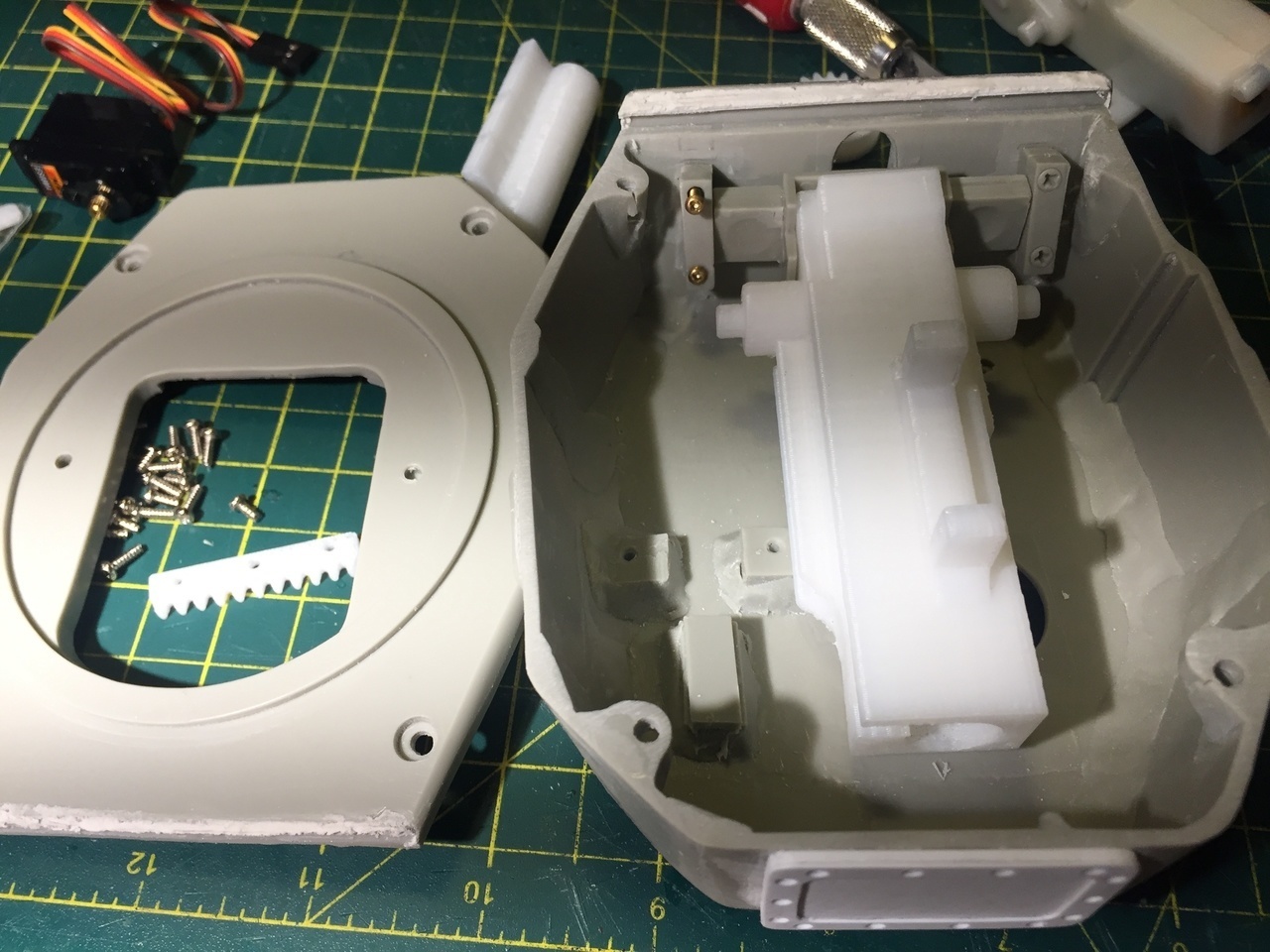

The Clark recoil unit fits well into the Vandra gun mount without any adjustments. The recoil unit is a bit too long though and minor surgery to the unit and turret bottom is required for the gun to elevate without being blocked by the turret ring. The elevation unit base that Vandra molded on the turret roof need to be removed so that the elevation unit is properly aligned with the clark elevation slot.
Clark universal recoil 16011
I removed about 1cm of the Clark unit at the end of it, it does not impact the recoil operation at all.

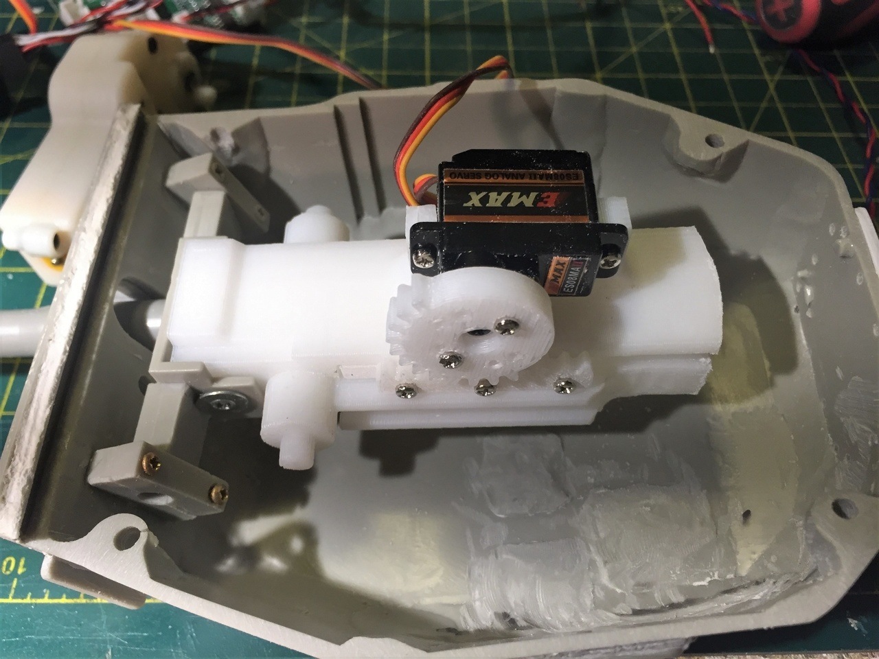

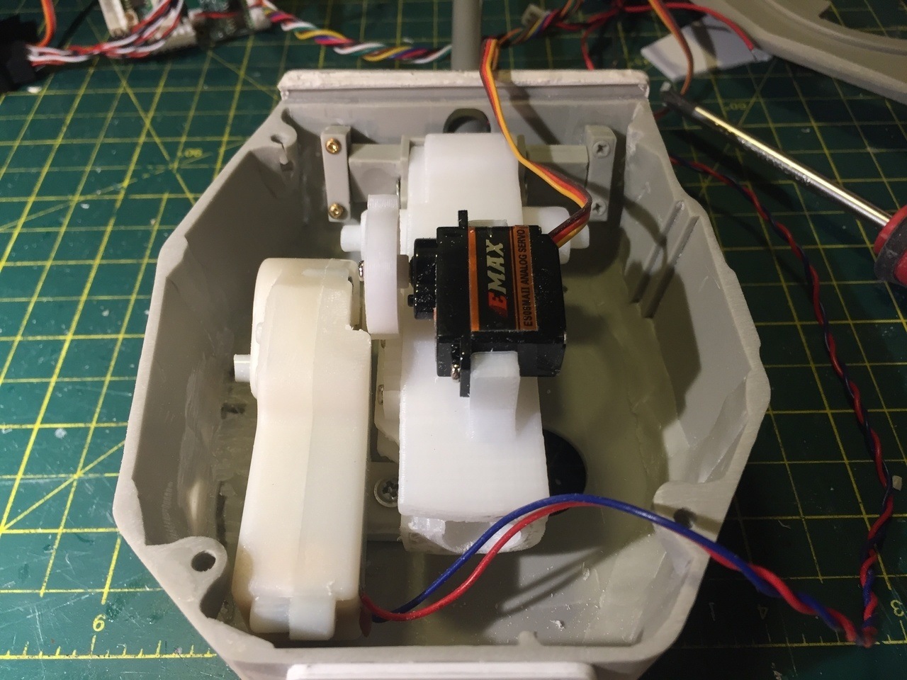

Elevation unit is installed on the left of the recoil unit, but new mountings need to be created.
I wonder why everyone of my models are always so cramped inside... Its tight but it fits. The elevation unit is a bit high and I needed to remove some of the resin material molded on the inside of the turret bottom to make room.
I also needed to relocate one of the screw to fit the dented ring in place. The whole installation was quite simple, taking 3 hours of work end to end.

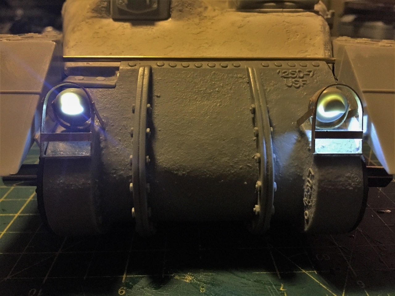

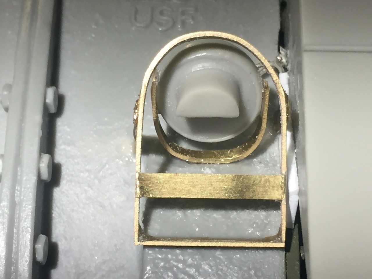

These are the head lamps and guards, both totally different than on a Sherman.
Vandra Ram II tank
Vandra Ram II tank
I had difficulty finding references on them. Research is complicated by the fact that there is no surviving Ram tank that still have these intact. We're left with some blurry wartime pictures to interpret and no measurements available. I saw 2 Kangaroos that have them but they show a different installation, one Kangaroo has the guards strait up at 90 degrees, the other one showing it inclined. Modellers need to be careful when using restored vehicle as reference, the restoration may or may not be accurate, which one is... or maybe there were many arrangements... I decided to put them inclined as it seems to make more sense that obstacles would slide over them instead of crushing head on.

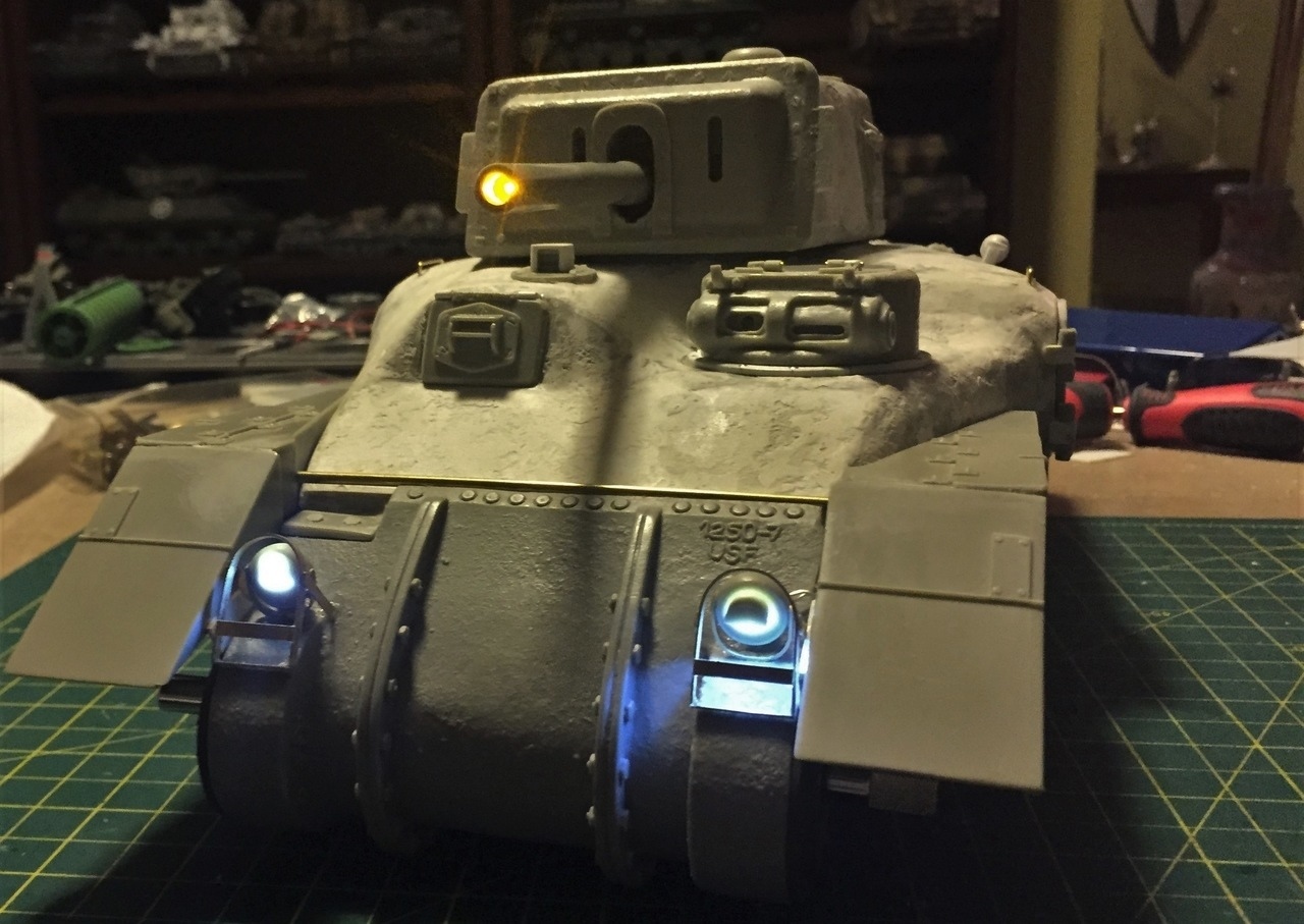

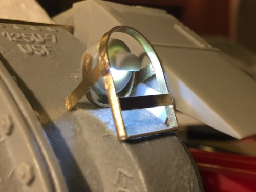

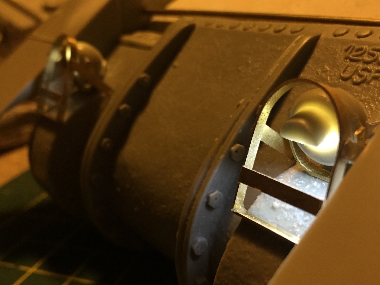

The solid resin Vandra head lamp parts were drilled and a 3mm white LED was inserted inside. I wish they were in metal but I left enough resin so it is not too trans lucid.
Vandra Ram II tank
Vandra Ram II tank
Vandra Ram II tank
Vandra Ram II tank

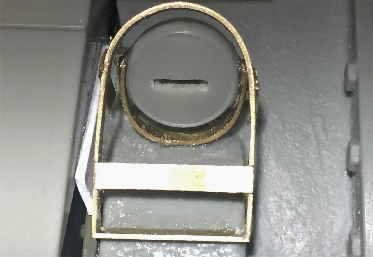

I will need to put a metal plate in front of this one to mimic the light only going through the slot.

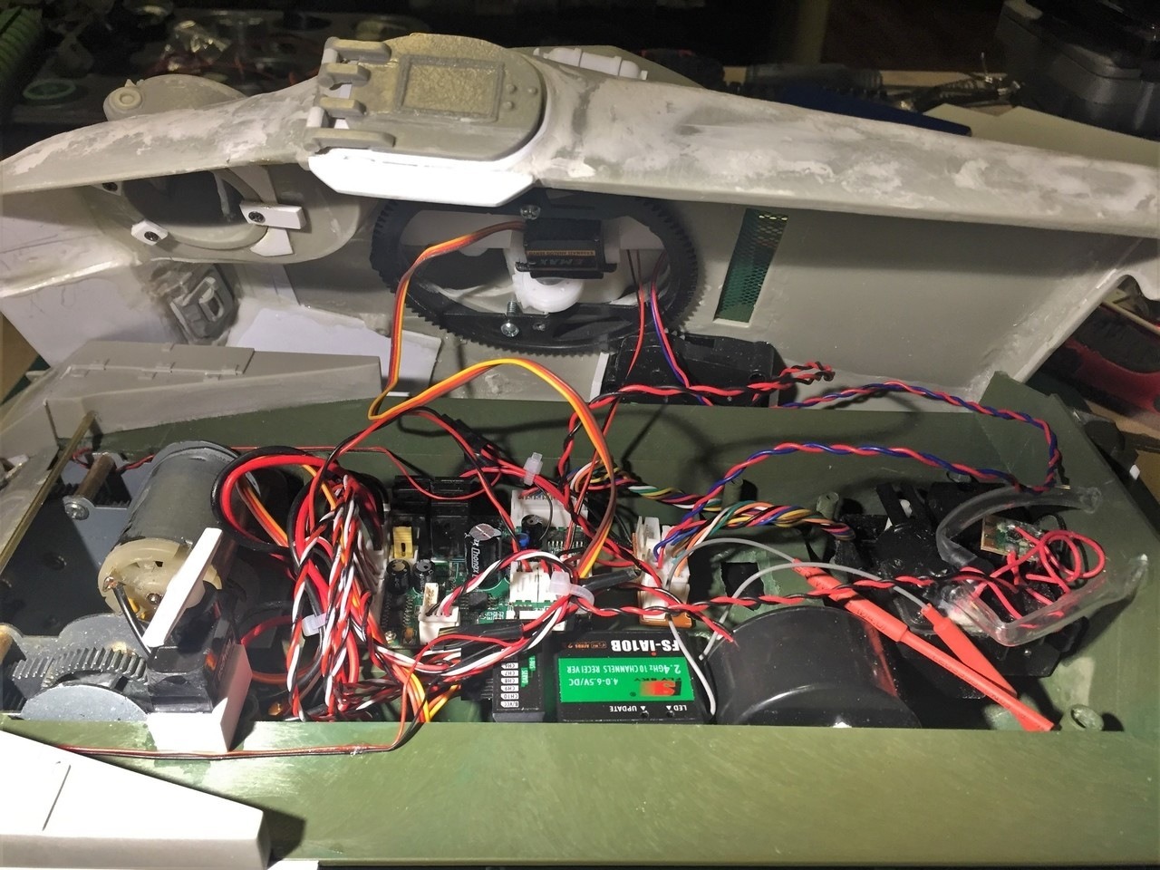

Here is an open hood view, nothing special here. You can see a Clark TK-22, flash and recoil units, Flysky IA10B 10 channel receiver, HL gears, smoker, rotation, speaker. It's plug and play stuff, nothing complicated and really nothing to brag about, but they work fine. And I like to keep the noise down so no huge speaker or sound system for me.

This is the Clark flasher in action. The Vandra metal gun tube is nice but it was filled with resin inside and it takes quite a while to empty it.

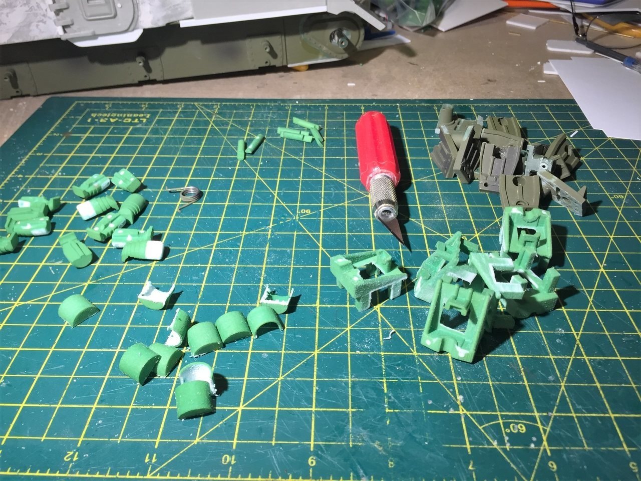

Dremel time, the HL part are trimmed and prepared for the conversion.
Shapeways M3 style suspension

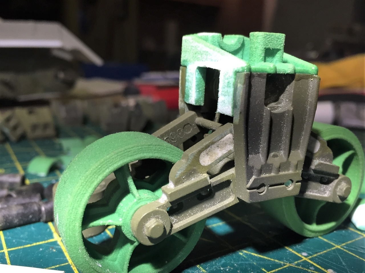

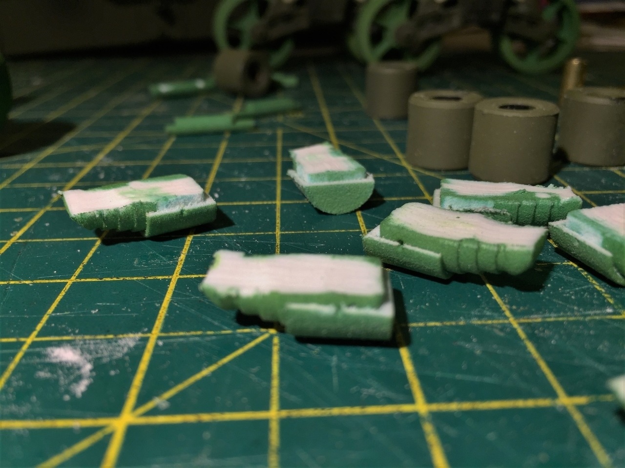

Notice the position of the cut. As per my experience with the M7 where I needed to rework all my suspension, if you make the cut too high, the suspension will be too high and won't look good, specially if the sprocket and idler cannot be raised to be at the same level as the suspension.

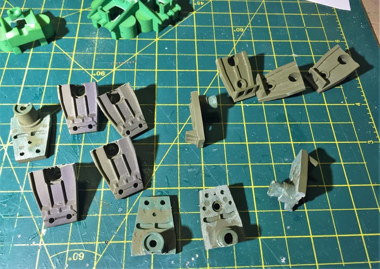

The Shapeways spring housing are too large and need to be reduced in size, otherwise it won't look authentic.

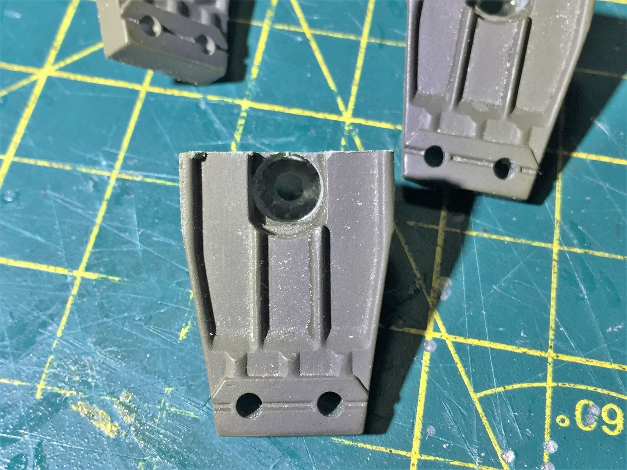

The spring housings were cut with a metal saw (not the blade) and will then be sanded up to the middle of the small hole that you above, a significant reduction. Notice also that the center of the Shapeways part was made hollowed using a small Dremel drum sander.

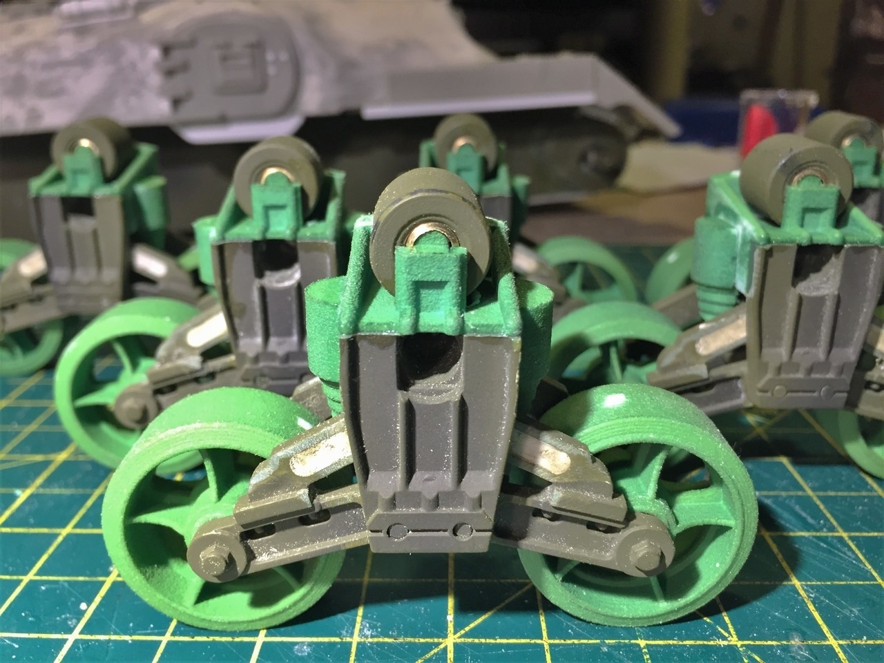

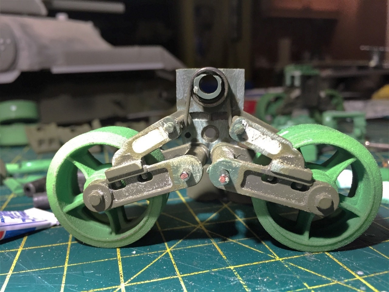

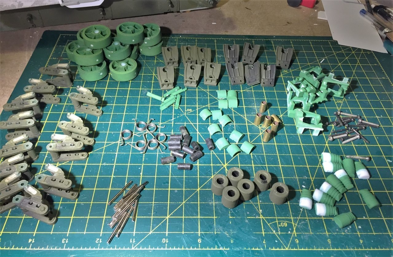

Now at the assembly step. there are surprisingly a lot of parts. Notice that you need to make 6 shafts for the rollers out of a 6mm brass tube. You can see the result further below. Brass are better for these than plastic tube. Order your 6mm brass tube well in advance because they are difficult to find but can be ordered from China very cheaply, but it takes time.
The suspension spring needs to be lowered and a plasticard part inserted and glued at the bottom under the spring so that the spring does not come up to annoy the roller. I did not see this impacting the operation of the suspension.
The Shapeways main part is glued on top, the fit is good.
The fake spring parts are trimmed because they were interfering with the suspension spring, and then glued into their housing as shown. They are then ready to be installed back on the bogies.

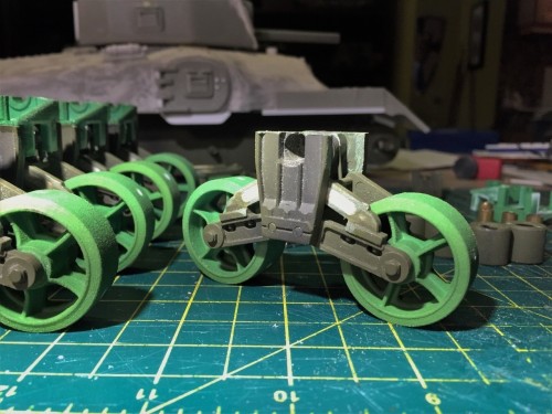

The early M3 style suspension is ready to be applied putty and given a good polish before installation on the chassis. The plug for the middle hole will as usually be a long task to make smooth and seamless.

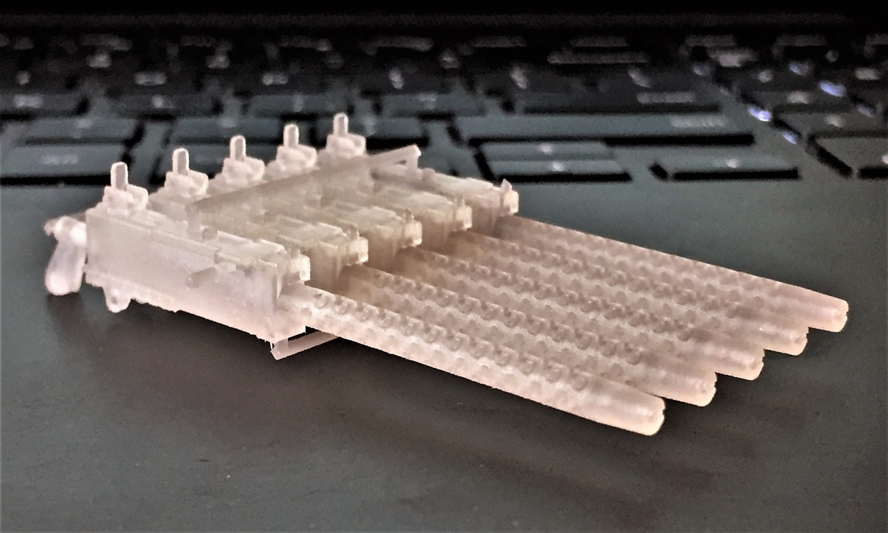

In preparation for this, I ordered these .30 cal MG gems from Shapeways.
Shapeways Browning .30 MG

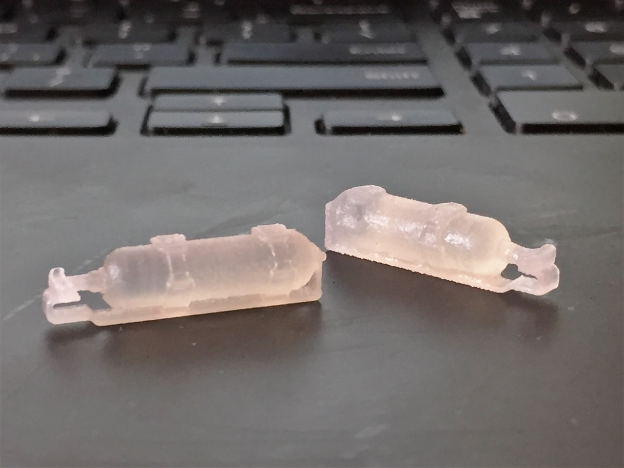

These Shapeways fire extinguishers were part of the shipment. They will go on the hull.
