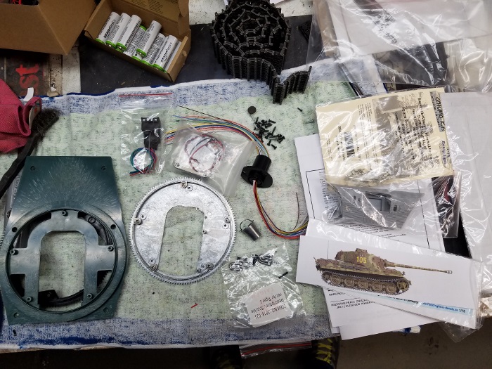

Parts arriving. My only issue with any of it was an electrical part from germany. The instructions are in German. But I have seen threads here on how to install the part that stops the silly recoil on the tank.
Parts parts parts
Parts parts parts

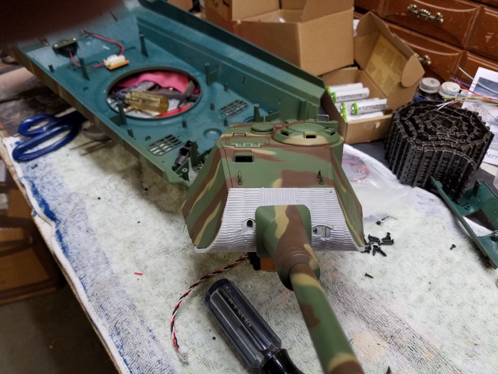

Began work on the turret.
drilling mounting screw holes

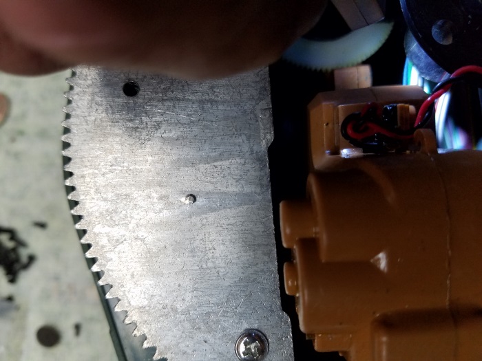

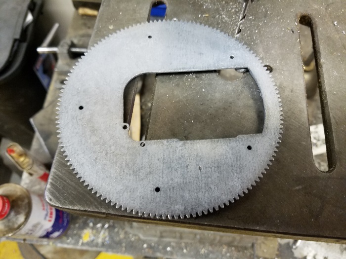

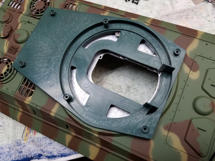

The metal turret ring gear needed a bit of work, cut off two mounting posts that were interfering with a good flat fit, then cut out the reliefs for the bearings in the ring gear.
mating ring to turret

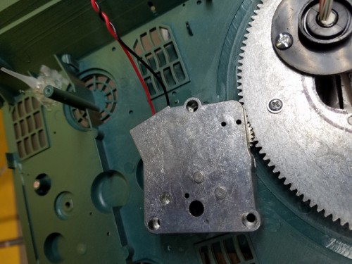

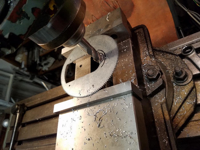

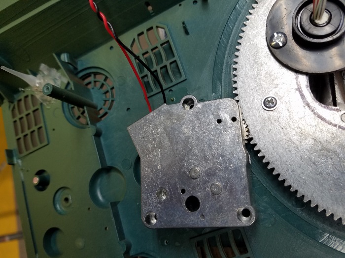

Since it's a 360 turret now I first mounted the electrical piece directly to the rear of the cutout, oops, cannon breech in the way - OK back to the drawing board and the milling machine.
First cutout
First cutout

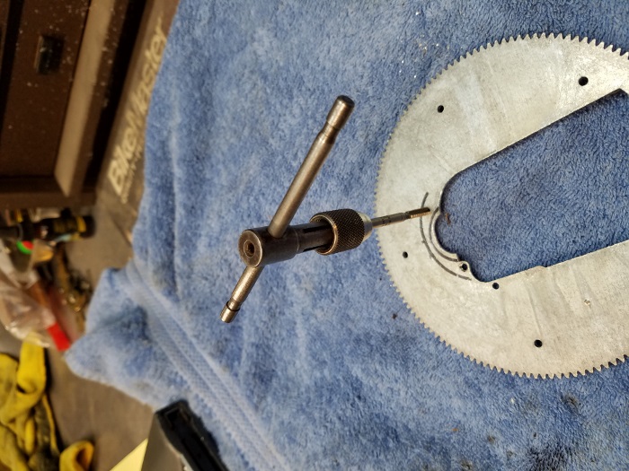

tapping holes
tapping holes
second cut for 360
second cut for 360

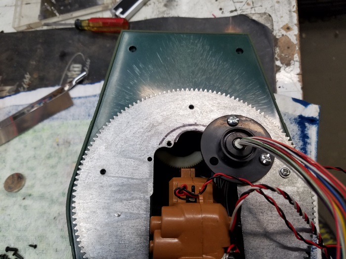

Relocated the unit right rear and it fit like a charm. Plenty of room for the wiring to fit in. I drilled the mounting holes and tapped them to an 8-32 thread and will loctite the screws in place when final assembly occurs.
final fit
final fit
final fit
final fit
It really came together quite nicely.

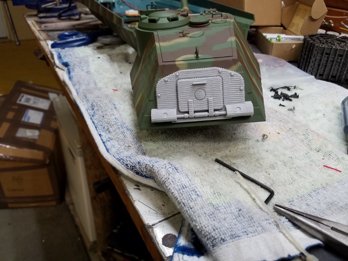

And since I was tearing the turret apart I put the front Zimmerit piece on. It fit very well!! I was pleasantly surprised by the fit. And of course the back piece set right in.
front zim
front zim
rear zim
rear zim

I am not going to replace the red light that came on just prior to the cannon shooting. I'll machine a phony machine gun to fill the hole like a coaxial machine gun. The other side has a slot for a machine gun also and I may find one to fit and put it in place. It will be static for now but someday I may fit a means of making it go bang also.

How difficult was it to remove the front turret armor? I am just about done with the lower hull on mine. That is going to be a good looking King Tiger Sir.
Norton1
Posts: 167
Joined: Tue Dec 05, 2017 9:55 pm
Re: King Tiger in process
Post by Norton1 »
It's 4 screws to get the plate loose, unscrew the muzzle piece, and everything slips right off. With the notable exception of the led red firing light. That thing is glued in. So I cut the wires and am not going to run it.
