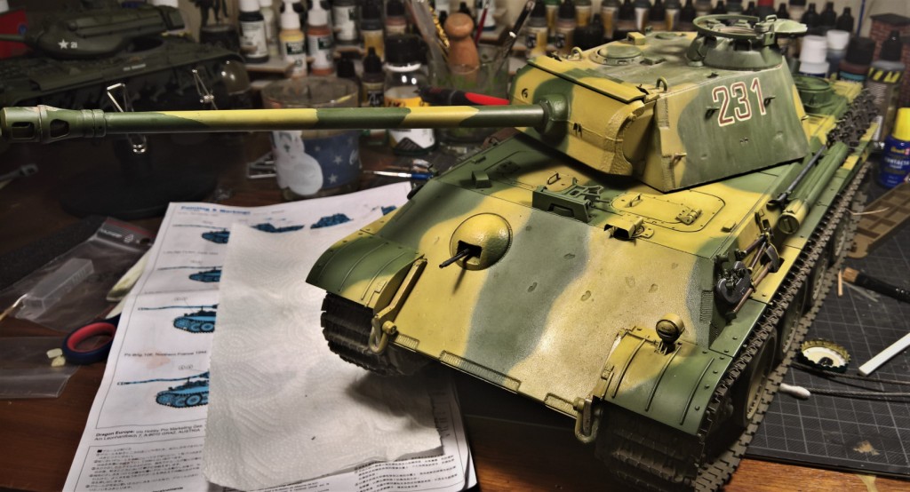

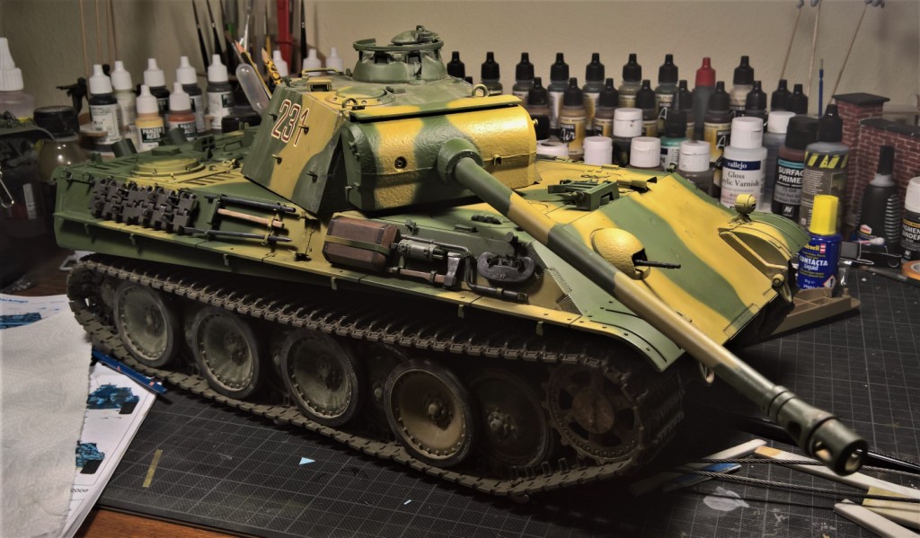

So here is the new face compared to the old, and the amount of gun depression that would be theoretically possible now.

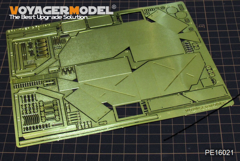

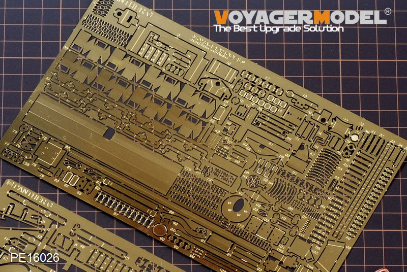

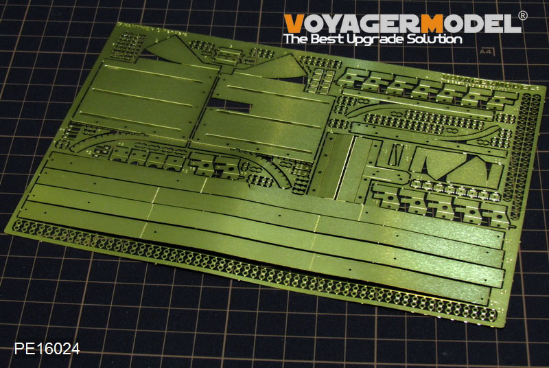

Re: Panther Gs Detail upgrades
While looking for some stuff in my hobby cave, my eye caught a box and inside was this:
Inspired by tomhugill doing this:
viewtopic.php?f=22&t=25454
And my latest 1:35 Panther here:
I went ahead and ordered some stuff to start with:
Sockelshop.de had the stowage boxes and basic kit on a ca 40% discount, so I just went for it
This will be a start. There will be a need for some more things to change and in the end another hull. But that wil be for later.
