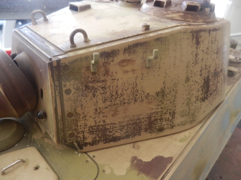

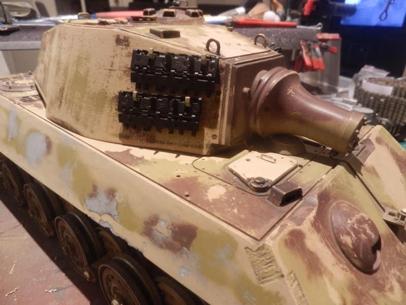

Began on the turret.
Took the barrel to work & used a wire buff wheel on the bench grinder to remove the enamel paint.
Looks like its just been posted now !
Placed unused plastic spare track links on the side of the turret & used a pencil to mark the position of the hangers.
Once marked, drilled into the structure and enlarged the holes.
Fitted each H/L track hanger in its spot, testing each time. Used high impact super glue Gel .
Got the front ones done, now to do the turret rear.
Thie tank is going to be marked 2(balkenkreuz)11 so good to have the space.
Im sure that doing the turret marking over zimmerit will be a treat
The H/L hangers allow enough off-set for the tracks to cope with the extra thickness of the zimmerit yet to be applied.
Minor details like front hatch handles and flame cuts also done.
Plenty of welds to do though !!
