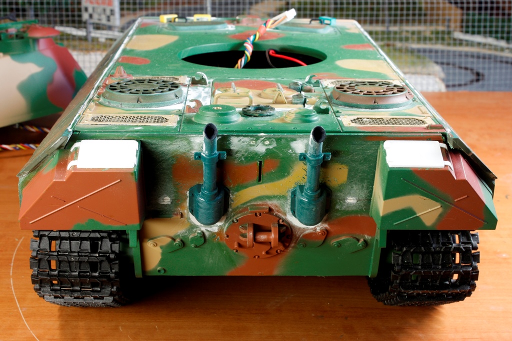

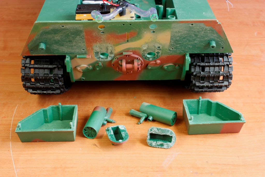

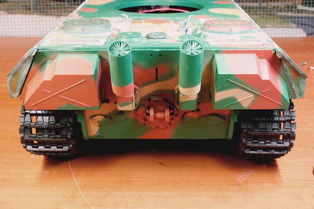

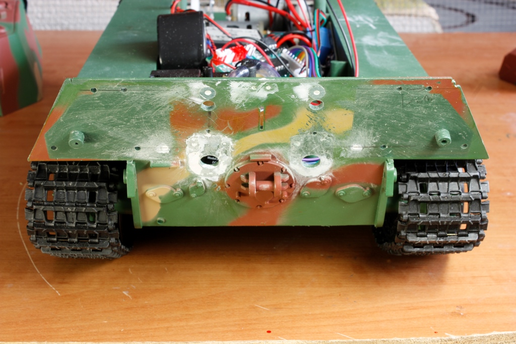

With the upper hull essentially finished, I moved onto the lower hull. Here is where we left it:
I wanted the exhausts to match the Ausf A seen at the beginning of this thread. Thankfully, they are the same as the right side exhaust on the Pantiger, so I ordered two from ebay.
Next was the removal of the bins and old exhausts. The bins came of nicely with a few drops of superglue debonder. The exhausts however, were a different matter. The superglue laddie at Heng Long must have been feeling extra generous when he put them on and I broke them and tore plastic out of the hull getting them off.
Once I worked out where the bins and Pantiger exhaust should be placed, I drilled new holes and filled the redundant ones with plastic plugs and filler.
Here they are in place, and the bins neatly disguise the gap between the upper and lower hulls. I also added lids to the bins – a simple addition to make them more like the photo etch ones. When I work out how and where I want to place the jack, I’ll make some exhaust upper support brackets.

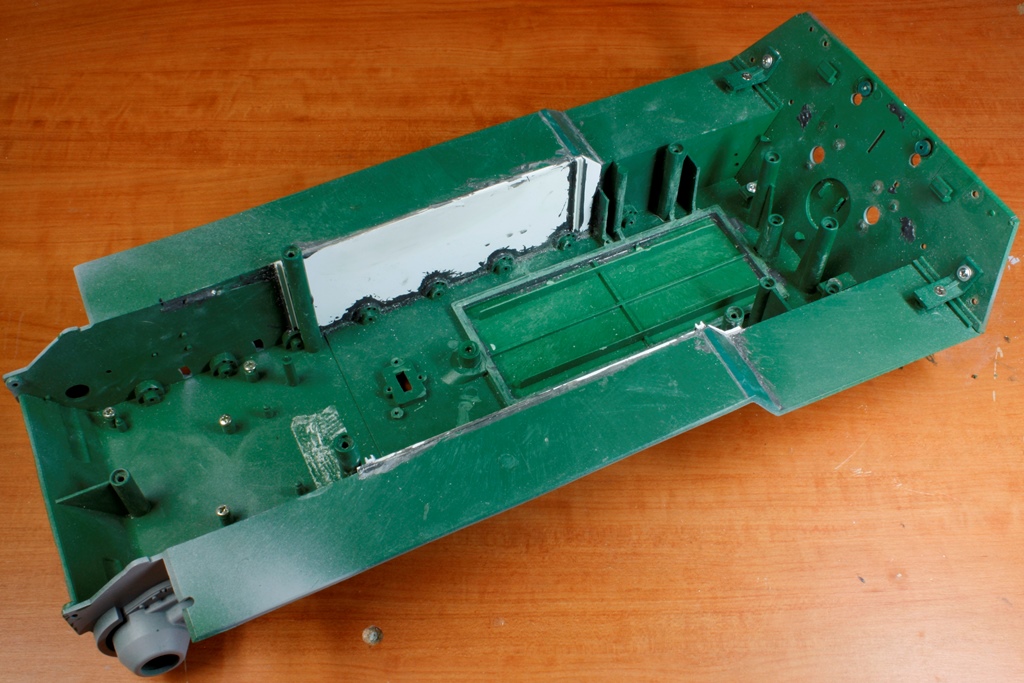

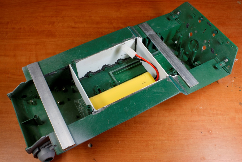

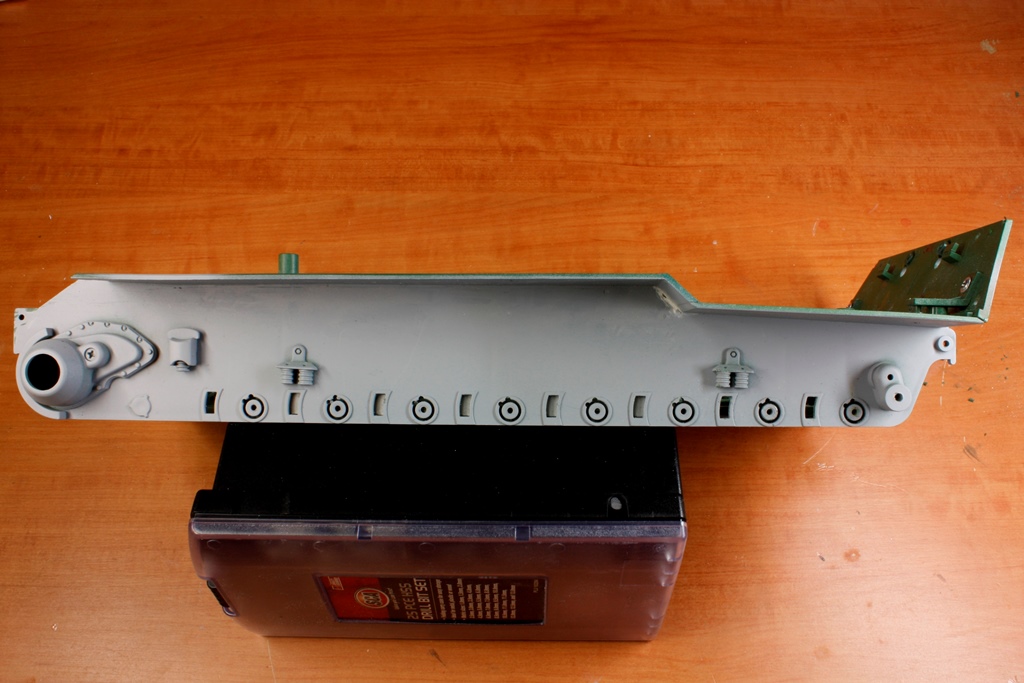

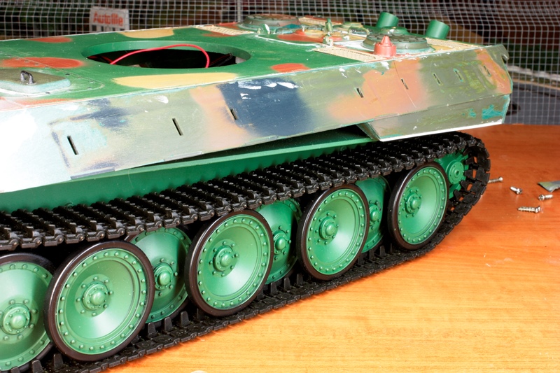

OK, so a bit of 'meat and potatoes' now.
I'm at the point of carving up the lower hull now, and really, there is no science to this. Its just cut and glue it back together, with bracing that I hope will do the job. Here is the main objective, to make horizontal the underside of the sponson which is currently sloping.
So I made some cuts to raise them, leaving a small segment attached near the front, from the black dot forward. I made a bit of a mess of it and could have saved a lot of pain by making a straight cut. Unfortunately I was all over the place. The battery box has also been removed and the lid glued shut.
To re-attach the sides that were then flapping in the breeze, I made some side supports from plasticard, and some steps in the sponson from leftover HL plastic. Then I glued it all together with JB Weld.
That left some very ugly scars on the outside of the hull. It took a lot of cutting of small bits of HL plastic scraps and filling and sanding of putty. I had to hide the results in primer before I showed it here. Its not perfect, but some pigment will hide any remaining flaws.
I wanted to insert bulkheads and was originally going to glue them in as hull bracing. But they still weren't going to stop the sponson sides from sagging, so I will bolt-in two bits of aluminium bracing. For now I have the bulkheads slotted into 'C' channels so they are removable so I can get components in and out easier. Nothing is fixed in place as I am waiting for 4.1 gearboxes from Forgebear.

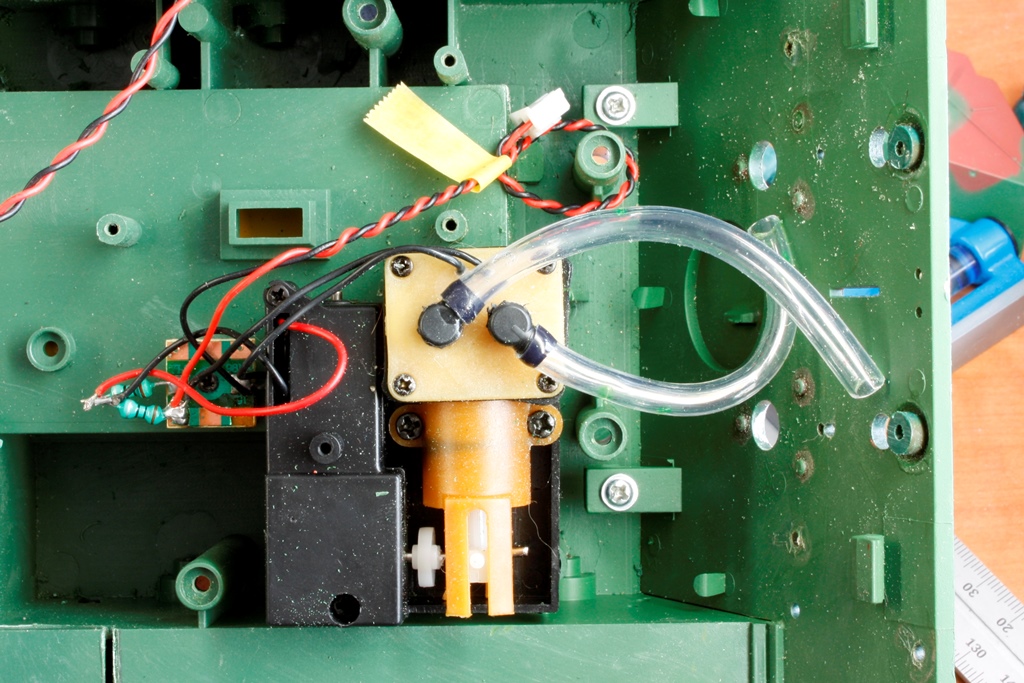

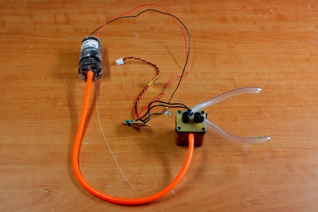

It's been a few weeks since I've had a chance to do some work, so here is an update.

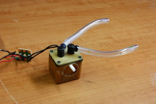

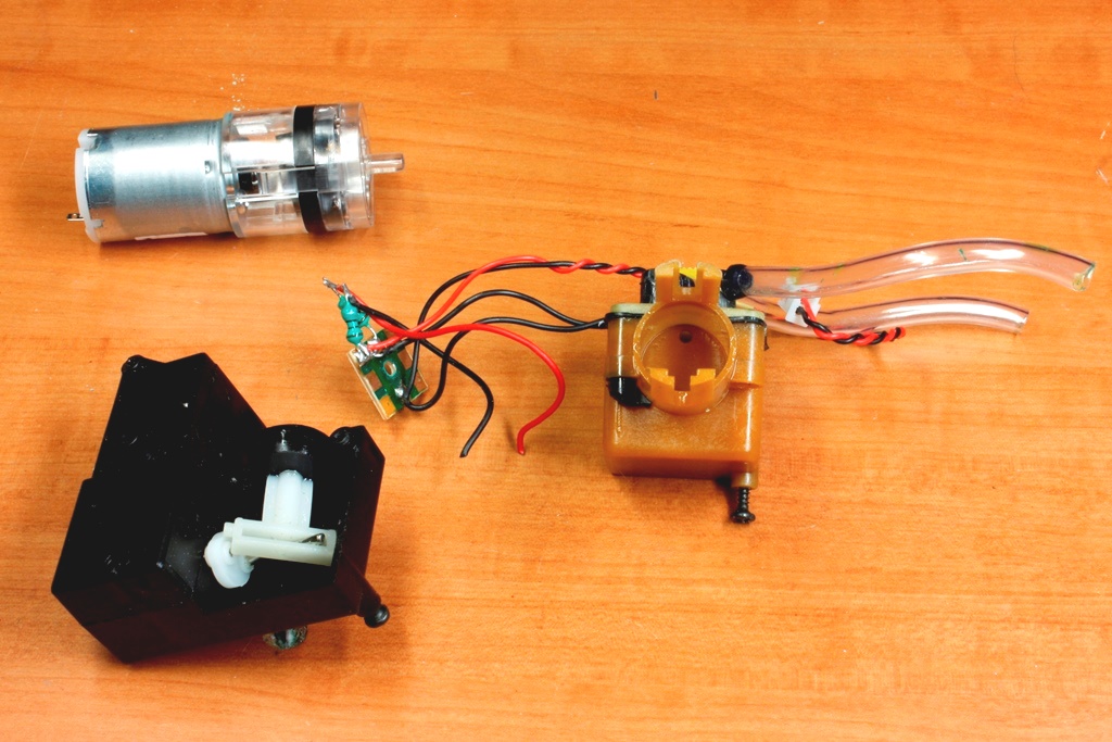

I want to make some room under the engine hatch for some switches, but the smoker takes up a lot of space in that area.
Kevin Grannum has a video where he modifies the smoker with a quieter pump from a fish tank. I thought I could use that mod to rearrange things. Here is the new pump, a rotary unit, and the old reciprocating pump, now separated from the heater unit. I suspect that the reciprocating mechanism is a cause of the clatter from the HL unit.
I cut off the cylinder and enlarged the intake hole and glued in a small piece of plastic tube to attach the air line.
I used a length of RC fuel line as the air line, with enough length to give me some flexibility in locating it later. I tested it on my Tiger to make sure it worked, and so far its good - much quieter, although this one is not as quiet as the almost silent one Kevin shows in his video.
