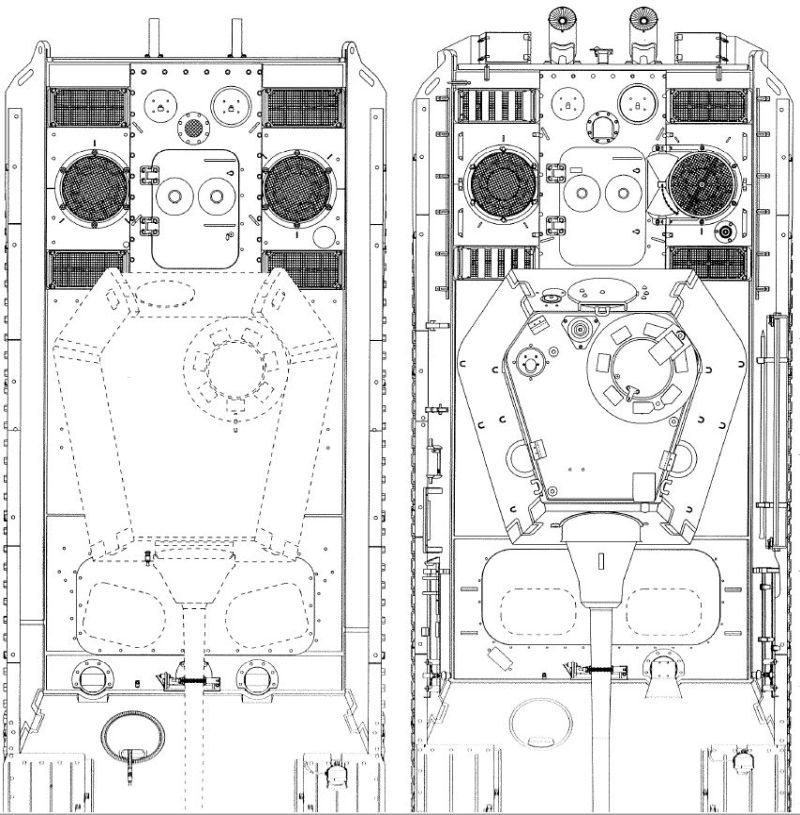

The Doyle book shows the drawing pictured with the Schamlturm and tells the KWK 43 8.8/L71 was to be used. Well, we´ll never know how it would have turned out. The Panther G turret was used in that surviving example because of availability most likely.

This is info isn´t correct.Soeren wrote:The Doyle book shows the drawing pictured with the Schamlturm and tells the KWK 43 8.8/L71 was to be used. Well, we´ll never know how it would have turned out. The Panther G turret was used in that surviving example because of availability most likely.
Look the attached Drawings of Panther II (left) and Panther G with Schmalturm (right).
The Turret on Panther II is drawed by dashed lines - because this turret was never build.
An original report has been found which confirms that without a turret - just test weight rings -
the singe Panther II chassis was sipped to Aberdeen Proving Ground after the war.
Still with the test weight rings on top, the Panther II chassis was sent to Detroit for testing.
After returning to Aberdeen Proving Ground, a turret from Panther G was mounted on the Panther II chassis.
Later when the Panther II was transferred to the Patton Museum in Fort Knox, where it underwent restoration,
at which time turret armor bodies were switched with a different Panther G.
Re: AERO MATE Panther II
Thanks for the additional info and that picture. Still I dont see too much difference as both turrets feature the same basic concepts. And we see that the Panther ii version would need to be different if the kwk43 was to be mounted. This is all very interesting. Which kind of turret and canon are you gonna use?
my Build is the Panther II at Fort Knox with Panther G turret.
The dashed Drawing show the Turret with 7.5 KwK 42 L/70!!
