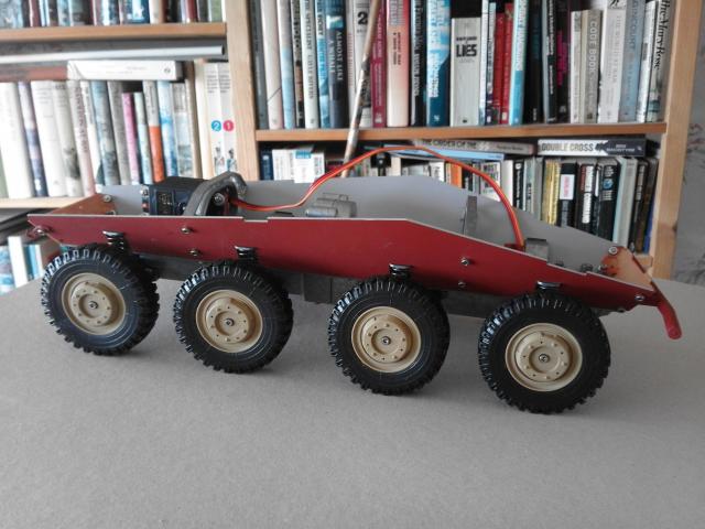

I got fed up with seeing the chassis just sat there so I have fitted the wheels.
As I suspected, I will have to adjust the steering arms as, despite my best efforts and measuring each one before fitting, the wheels do not line up. More seriously, what you can not see is that there are only 7 wheels fitted. The stub axles have two flats machined on them to correspond with the moulding on the wheel. At least, I should say 7 of the stub axle have flats machined on them. One is completely round. Very poor quality control. There are only 8 of them - you would have thought it would be easy to check when they were packed. I have overcome previous problems but that one is beyond me. I shall have to refer that back to Dominique in the hope that he can provide a replacement. I am still not convinced that the steering is correct, but ideally I need all 8 wheels correctly fitted first.

Despite your woes, this is going to be an impressive bit of kit once it is all done. The sheer weight of the chassis is going make it ride over terrain very realistically, I can't wait to see it running. :thumbup:

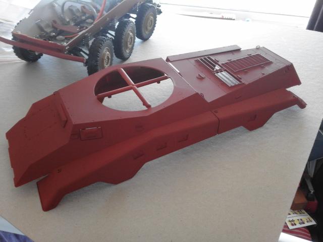

So far, I have done everything in the order given, but while I play around with the steering and wait for the stub axle problem to be resolved, I thought I'd have a go at the body work. All the vision slots are fitted and all open and close.
As a consequence of assembling what you see, I made an interesting discovery, which will be a bit of a nuisance when it's finished. With the mudguards in place you can not fit the body to the chassis because of the inward slope. That means that each time you need to remove the body, you will first have to remove both mudguards. :thumbdown:
