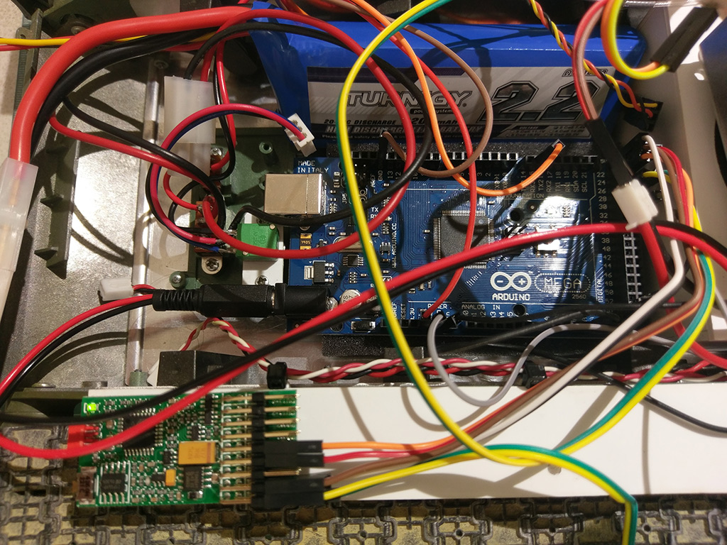

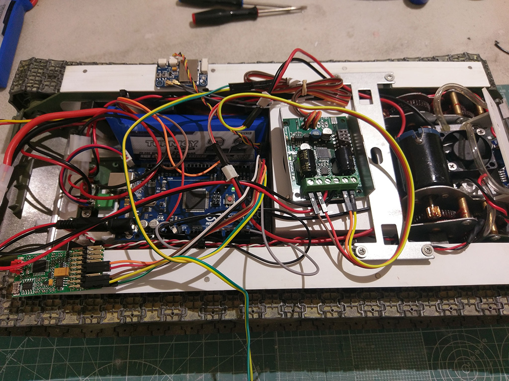

I've been frustrated running up against the IBU2's limitations, so I'm looking for something new. I noticed that Luke had explained how to preview the OP TCB using readily available Arduino hardware, so I gave it a go. I picked up a Benedini TBS mini and Sabertooth 2x12 and shoehorned it all into my T-34.
Don't worry about the spaghetti wiring here, the stock Mega 2560 obviously doesn't have the plugs we need. Once the TCB is commercially available, it'll all be plug-and-play.
My first impressions are very, very good. Driving is smooth and customisable, I like the fact that there are a number of steering and acceleration options that you can configure. Sound through the TBS mini is fantastic, it's an order of magnitude better than what the IBU can achieve.
  • phpBB [video]
Obviously this only covers the very basic functions; all the interesting stuff like shooting, lighting, I/O, etc. is a little too complex for me to try just now. I'm looking forward to seeing where the project goes though, and I'd recommend that you download and try the OP Config program to see what the full board is capable of.

Excellent work, good to see someone giving this a go, it runs very well and the sounds are top notch!
There are probably a few looking at this and thinking that it is too complicated to attempt. Yes, it does look complex, but it is one wire at a time, and the boards have all of the pins labelled. The components are relatively cheap, and easy to find on the web. If you can download a game and install it, and know how to wire a plug, you can do this.
