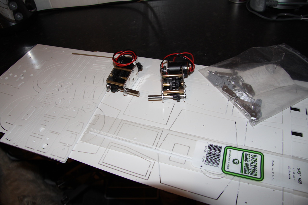

My Cromwell kit has just arrived, and it's a novel experience seeing a perfectly flat British tank. I ordered the basic kit and a few other bits to begin with, as I'm not planning to start this-my scratch-build Rite of Passage- until well into the New Year. Then, I'll order all those alluring extras...but not the Rolls-Royce wheels. £300 is just too OTT for me.The plastic ones look fine, and should suffice: but I will get the special metal sprockets with all those micro bolts. :think: While I'm currently like a pig in s**t at the thought of having my own Cromwell, when considering the likely outlay in blood, sweat and expletives..not to mention dosh, and getting webbed fingers from all that glue.., I'm thinking that you were a lucky b**tard getting that beauty of yours at such a bargain price ;)
When I get started, I'll post a build thread, but possibly pick your online brain for tips..if that's OK. Anyway,here's the two-dimensional Cromwell:

That's awesome 43rd rr! Like ok forward to seeing how you get on. I've the plastic wheels and they're fine. There's quite a bit of bolt detail you can add if you're feeling brave.
