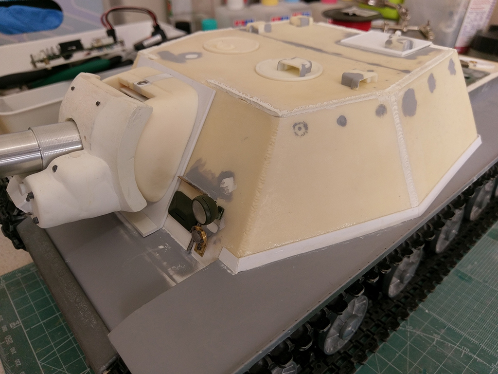

Driver's hatch, rainguard, headlight and horn. The hatch and headlight are from the Tamiya KV-1 A sprue, with a reflector made out of 0.2 mm aluminium sheet and an SMD LED. The wires run through the conduit (1.5 mm stainless steel tubing) into the hull itself. The rainguard is brass that I heated over a flame and melted into position, so I'm hoping that it'll stay in place despite its fragility. The horn is scratchbuilt out of a 1/4" brass ferrule with some fine steel gauze bent into shape with the back end of a 6 mm drillbit. The bolts are styrene.

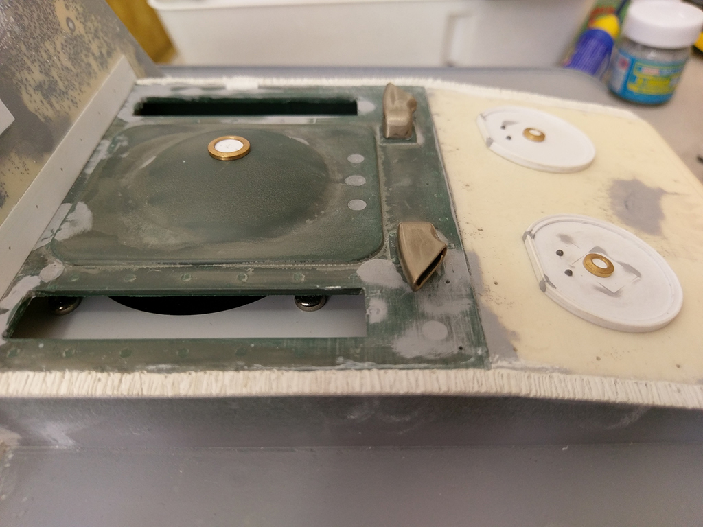

Periscopes in place, I ended up using the resin kit pieces after an embarrassingly rubbish attempt at making my own out of brass. I thinned the resin parts down and filled the bubbles with Mr Surfacer. I'm planning on hiding the signalling LEDs inside the periscopes with reflectors to make them visible from outside the tank, similar to how I hid them in my T-34/76's turret ventilator.
Scratchbuilt transmission hatches, the kit pieces were so thin they were translucent. You can nearly see through them! These are a bit more robust and have the characteristic flat spot, though I may have mis-measured and overdone them. I also added the coolant filler cap in the engine deck hatch.

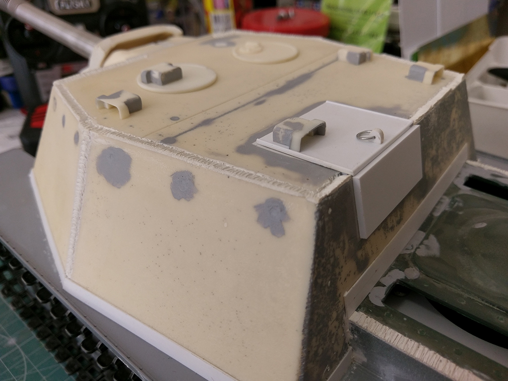

Loader's hatches in place, just waiting on some functional hinges. They will need to be fairly strong since the tank's control deck lives underneath, which means they'll be getting a lot of use. I'll have another crack at fabricating them, and if that fails again I might need to look into these 3D printing shenanigans. Otherwise, more detailing!

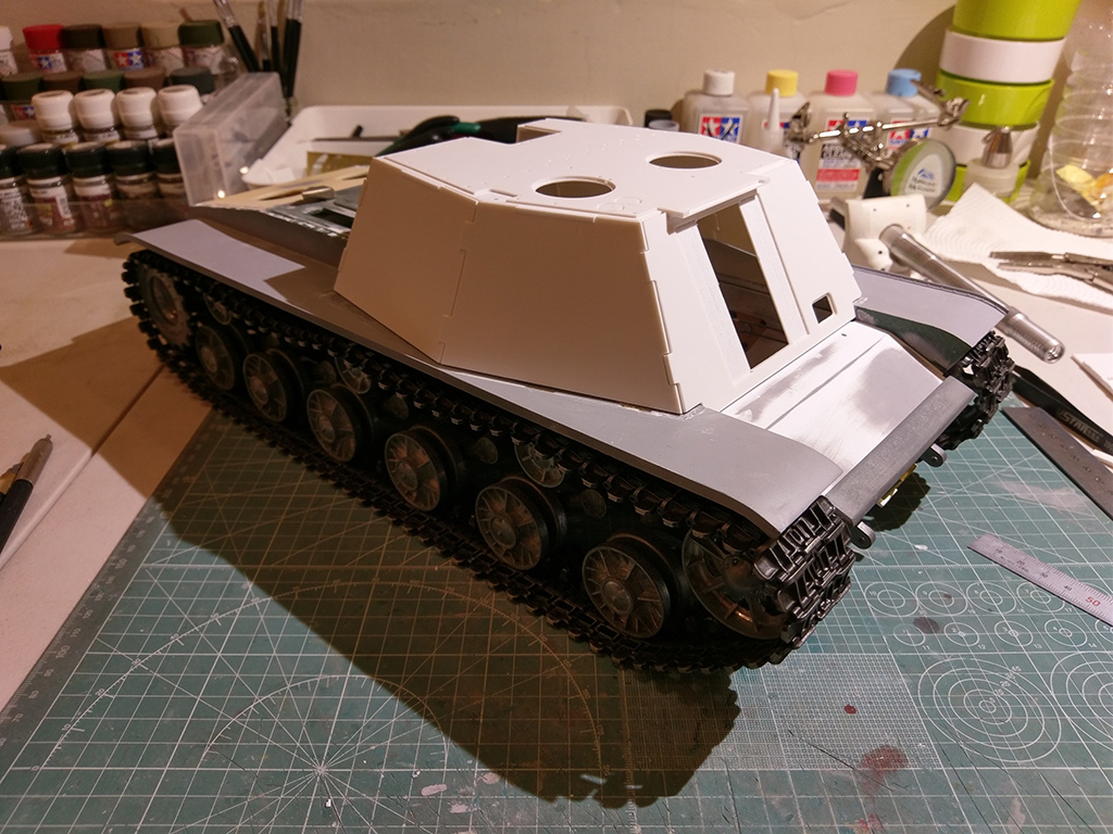

With the T-34/76 project mostly complete, I dug this out of storage to get back to work on it. However, in the intervening months (year!) the epoxy holding the casemate to the upper hull had perished and the whole thing popped right off. Since I wasn't super happy with the resin kit anyway, I took this as a sign to try something else.

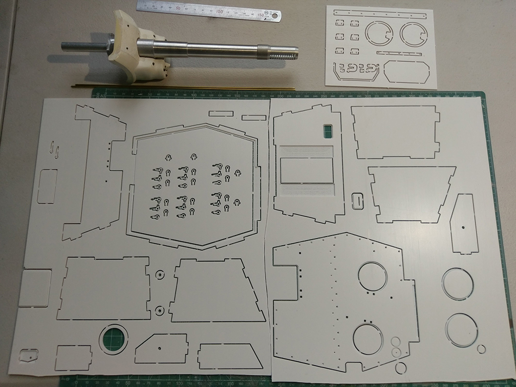

I'm going to use Christian Ludwig's SU-152 kit as a base, with the metal gun I already had and the Milliput mantlet I sculpted last year. I spent some time checking all the dimensions against my blueprints, and everything matches nicely. Even though the kit is designed for the smaller Juckenburg gun mount and mantlet, my chopped and sculpted one fits in and lines up exactly as it should.

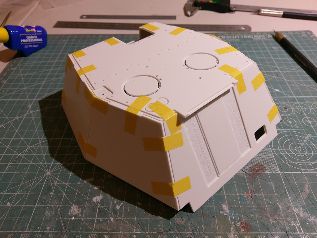

It won't take much adjustment to get everything to fit as it should, and much of the work I'd done to mount the gun will be reusable. It didn't take long to get the casemate cemented together.
The insides will be getting a revamp as well, the IBU2 has been replaced with an OP TCB. Once I figure out how far the gun recoil intrudes into the fighting compartment, I'll have a better idea of how to mount the electronics (TCB, TBS, ESC) without the servo mechanism crashing into them. Things will be a little back and forth, but it's good to get this kickstarted again!

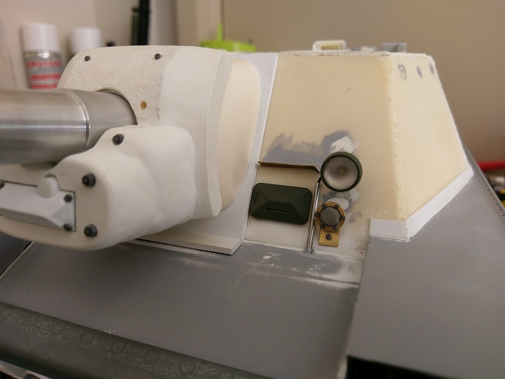

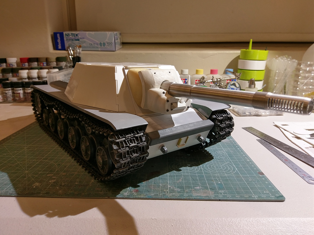

Managed to reuse the old gun mount, so we're looking like we means business again.
I've got another of the Clark recoil units that I shoehorned into my T-34, I'd much prefer to use it than the crappy linkage system I designed last year. I'm not sure how I'll go about fitting the full range of traverse and elevation with it though, and I don't want to end up less functional than it was before. It may require some outside-the-box thinking.
