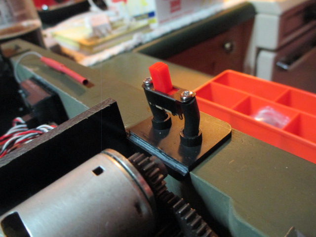

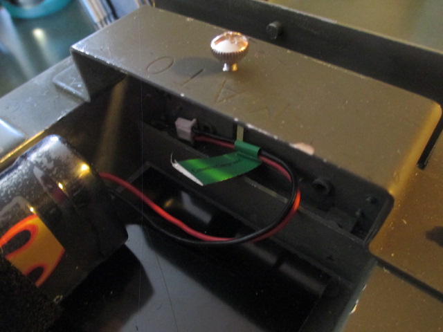

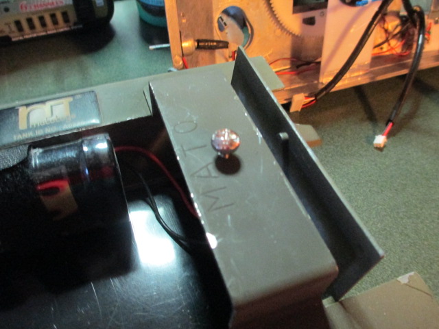

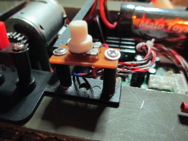

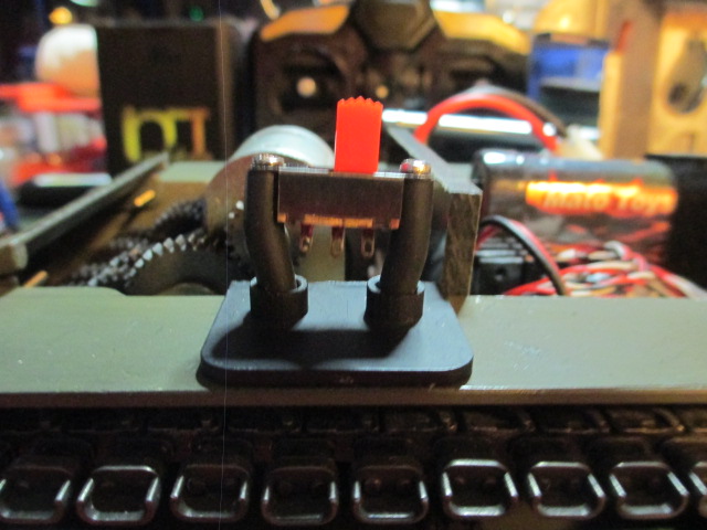

Back is giving me grief again tonight so only a little got done. I made up the mounts for the On/Off and the Sound Pot switches. The Loc-Tite epoxy I use to mount the rubber bits needs to cure for 24 hrs. Post brought in a piece of the detail I'm adding, a nice Schumo American tow rope set. That came from Robert at ETO I'm waiting for him to get the working barrel brace in before I remove the existing one. Interesting story on that barrel brace,. In one of Steve Zalogas books on the Sherman, I saw a photo of the M36B1 _with_ the barrel brace on the front of the hull like any other M4A3. It was the tall brace like the one used on the 105mm version of the tank. So not all of these make-do versions of the TD got everything we have come to expect as relocated, ...relocated. Pics:
Sound Pot up and out of the way of the MFU.  Mounts are the same as the On.Off, stiff rubber hose and plastic bases cut to fit.
Another view of the mount.
Another view of the mount..JPG (98.52 KiB) Viewed 3414 times
Scratched mount for the On.Off switch locates it under the Drivers hatch
in the center hole here.
Matos one finger screw method of holding the upper on the lower attaches...

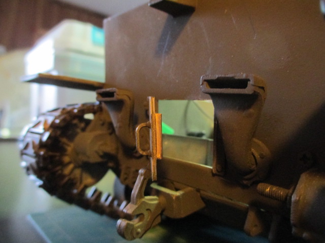

Nothing in the post today and back is still being a pain so only a little update. Pics:

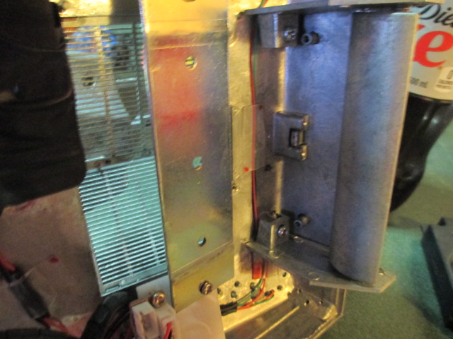

Shot showing the latch at work.
Shot showing the latch at work..JPG (87.39 KiB) Viewed 3376 times
I epoxied on a small length of brass square and hand filed it into a latch.  The door snaps shut now and should remain secure during rough running.
I epoxied on a small length of brass square and hand filed it into a latch. The door snaps shut now and should remain secure during rough running..JPG (78.09 KiB) Viewed 3376 times
MATOs working Engine Bay door just swings shut counting on hinge friction to keep it closed...
MATOs working Engine Bay door just swings shut counting on hinge friction to keep it closed....JPG (90.86 KiB) Viewed 3376 times

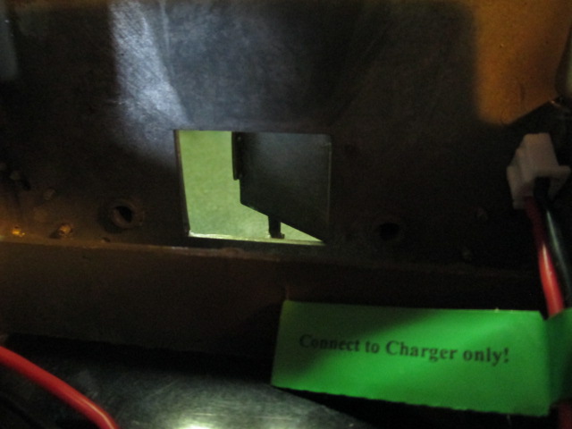

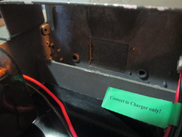

One for Max showing the inner  plate and space from the rear bulkhead
One for Max showing the inner plate and space from the rear bulkhead.JPG (87.97 KiB) Viewed 3376 times
