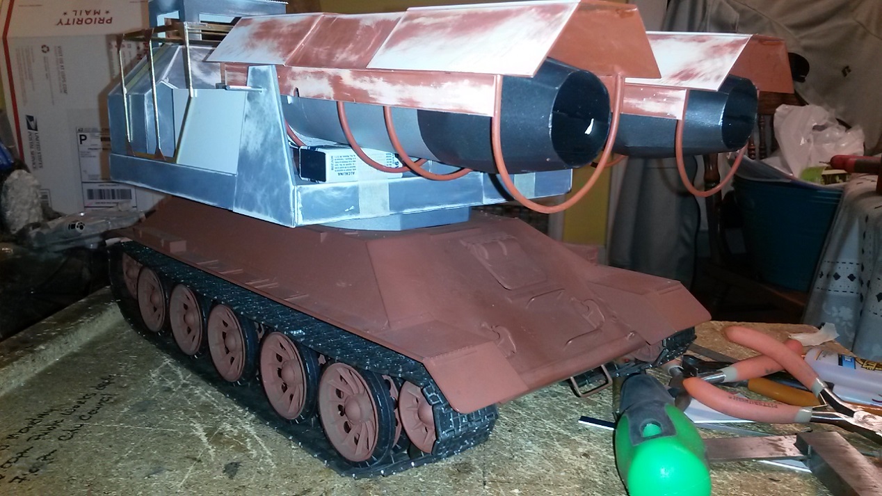

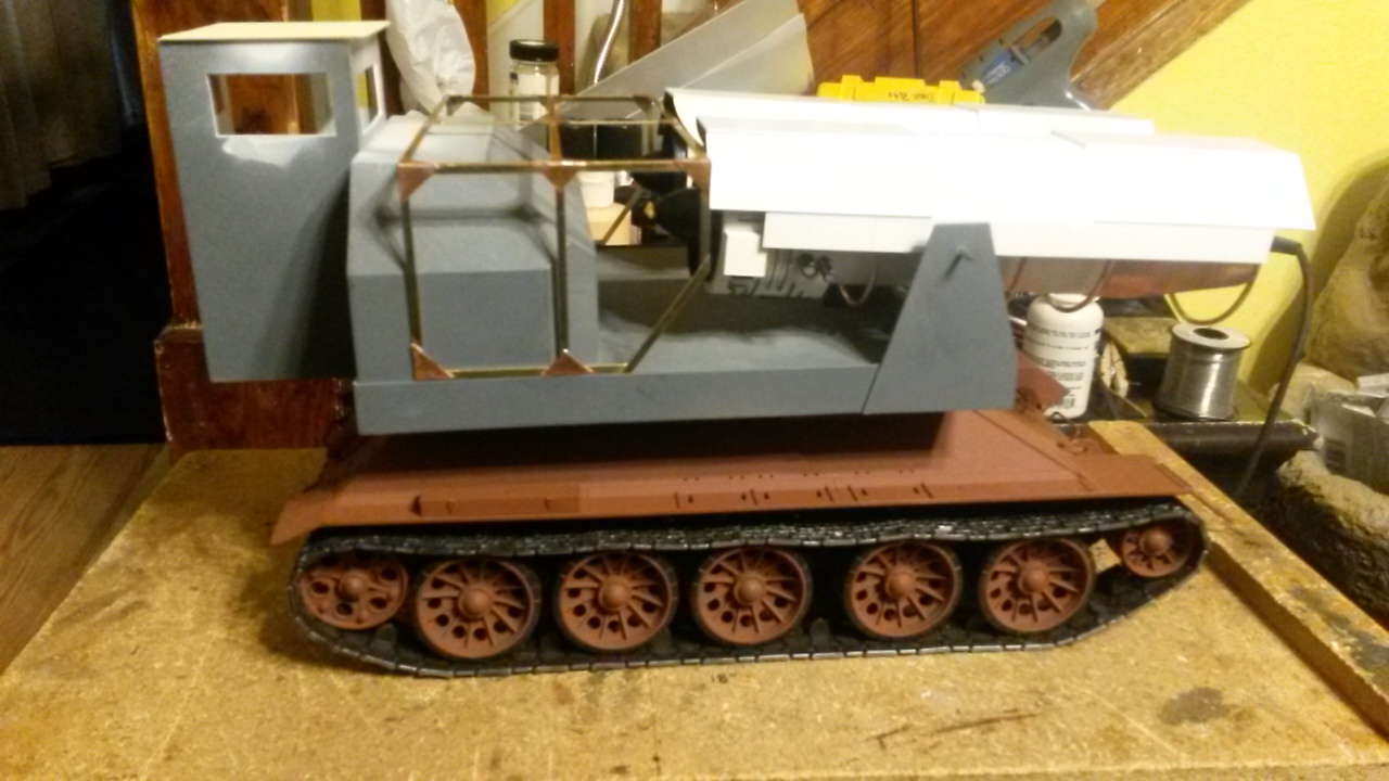

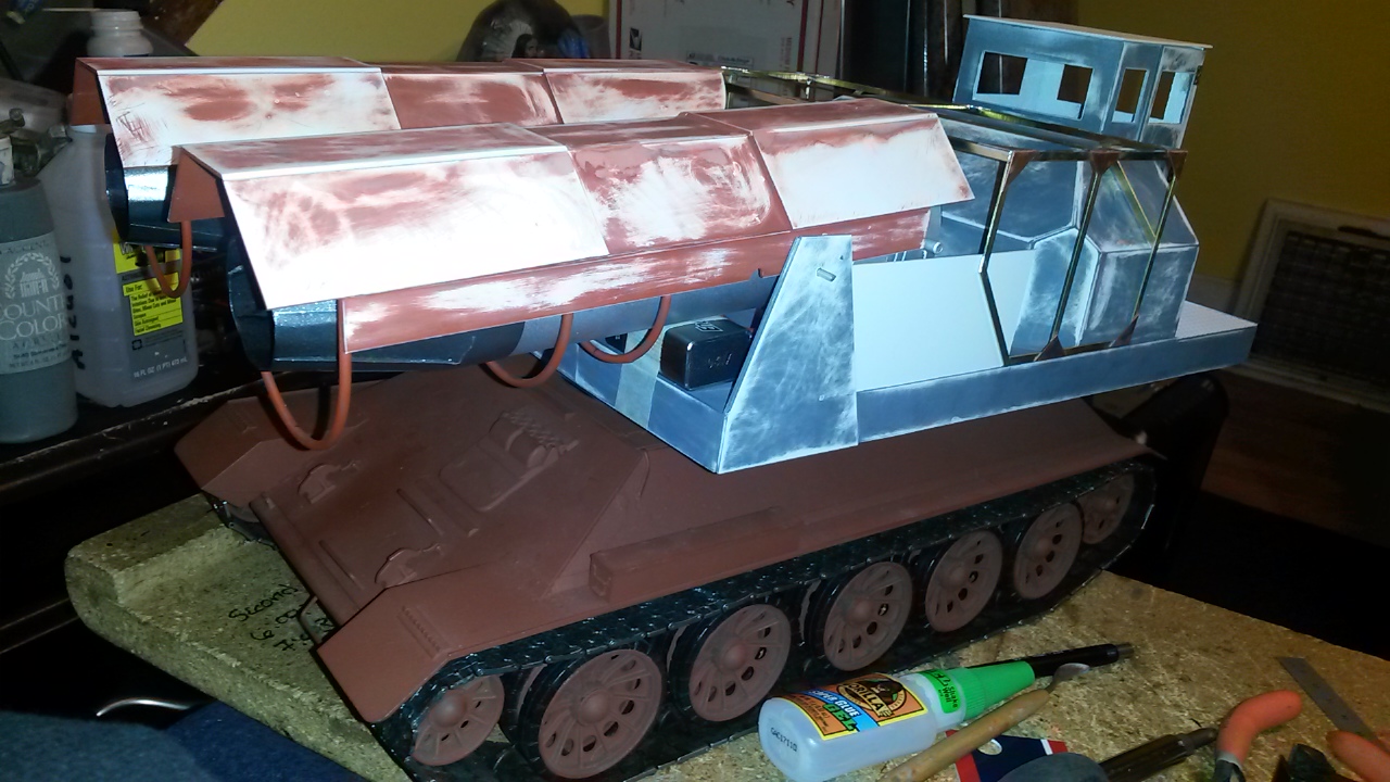

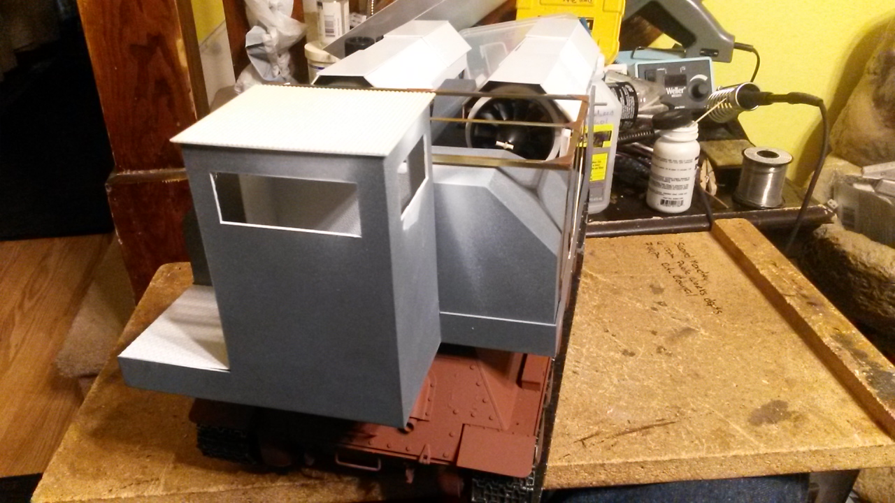

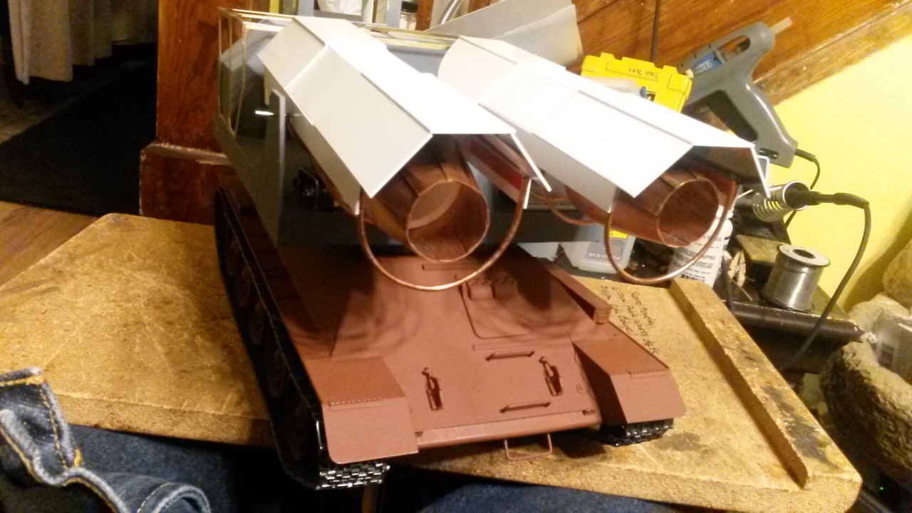

I was also able to get the FOD screen frame work soldered up. Here's a few shots of everything in place.

Made a bit of head way. I'm pretty sure I've figured out a way to get the jets to elevate using the HL elevation motor. More on that when I get a chance to test it out.
I've got to get some pictures of them yet, but I managed to make a passable representation of safety glass for the cab. You know, the kind with the wire screen in it. Looks pretty good, actually.

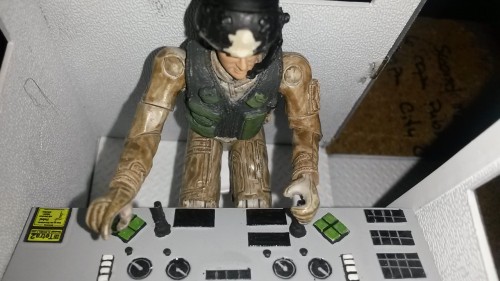

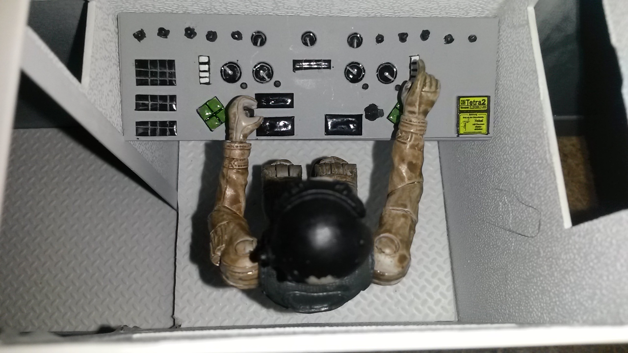

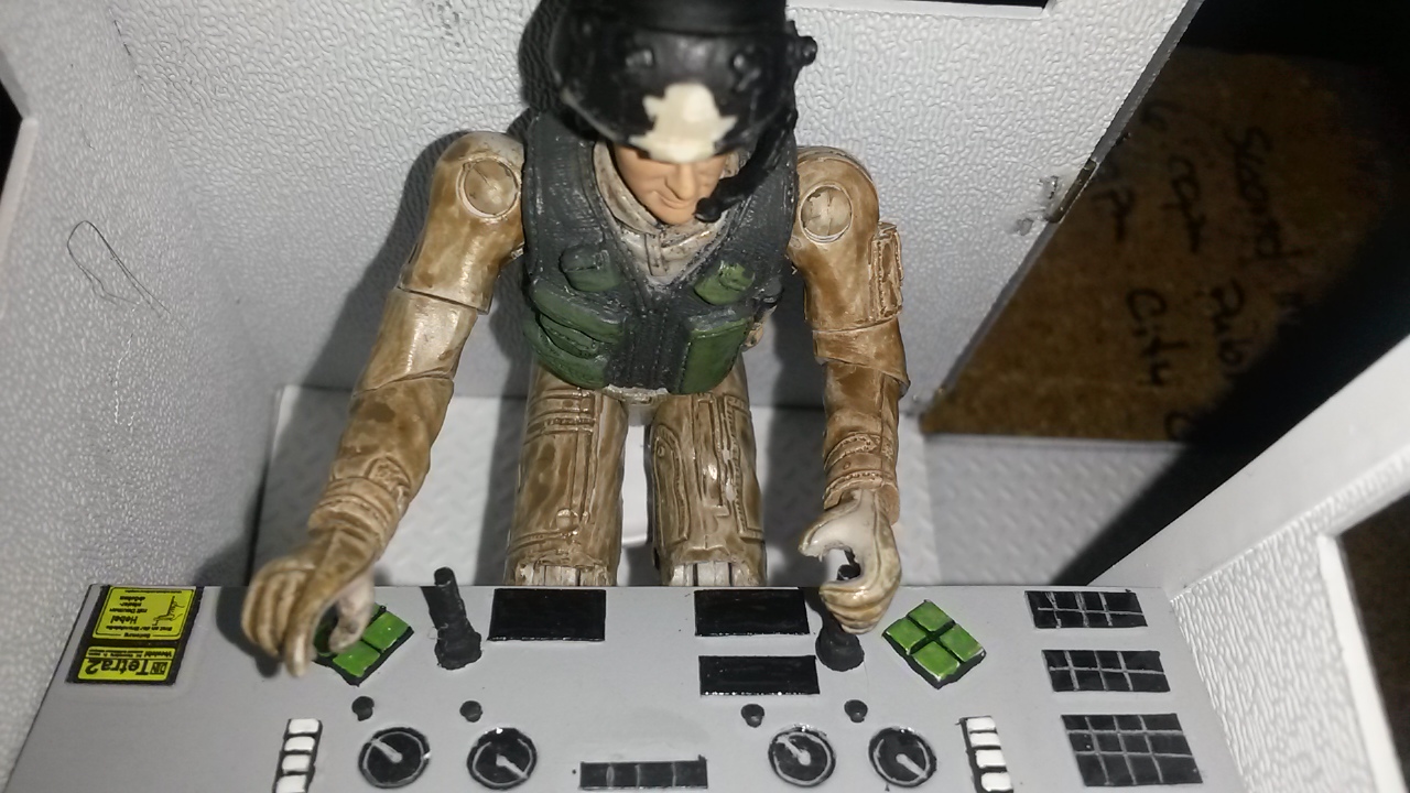

Here's a shot of the control panel. A buddy has a figure wearing a standard flight suit. I'm going to repaint him in a bright color jumpsuit. Now most of it is to the "putty, sand, repeat" stage.
Bill
Bill

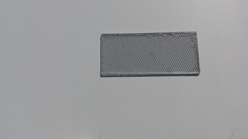

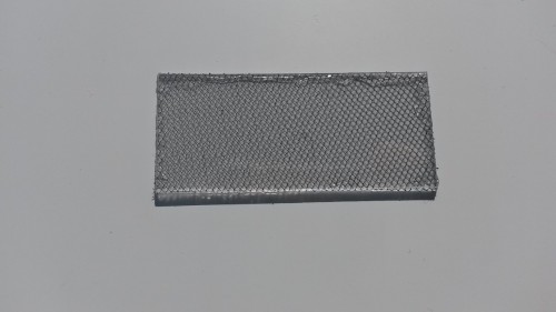

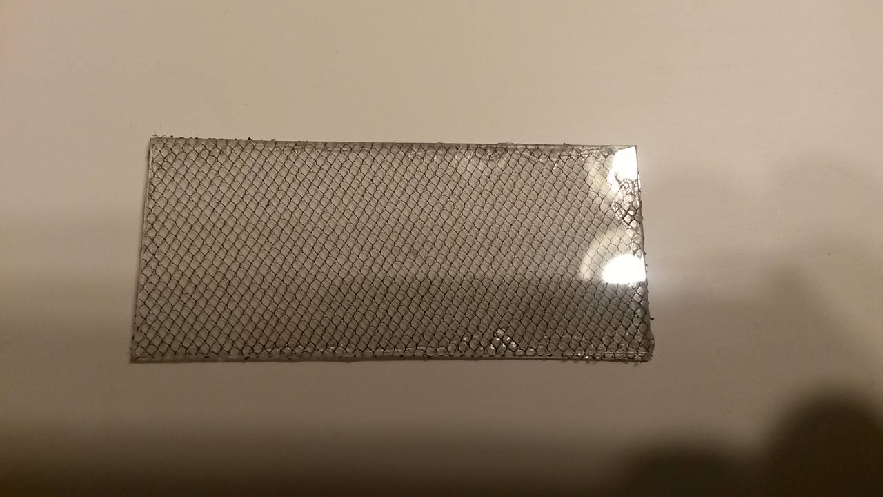

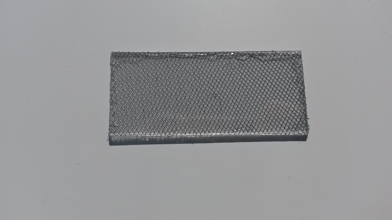

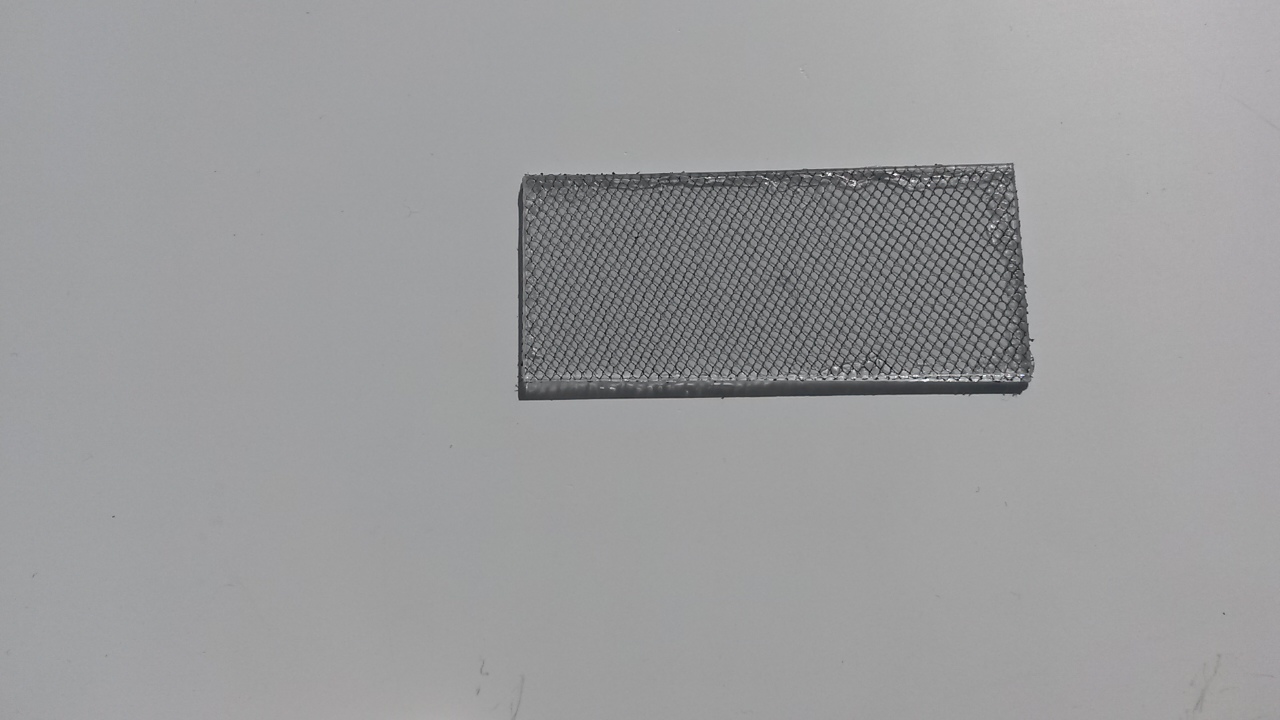

Here's some pictures of the "safety glass". One inside, and a couple outside in sunlight...
I used some of that lace stuff you see at weddings. The stuff that they wrap around mints or bird seed. I spray painted it black, then sandwiched it between two pieces of clear plastic. That's it. Nothing special, but it does pull off the look of safety glass. You really don't notice it until you get closer to it.
Bill
Bill
