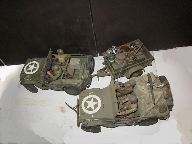

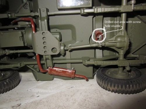

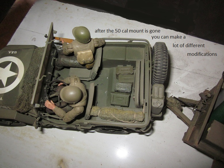

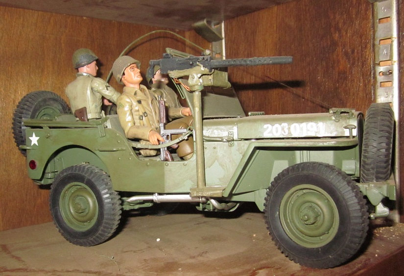

Sorry I took so long to reply. The BM jeeps would be pretty hard to rc as the things are for the most part metal. You obviously got one without the canvas top piece and it looks from your pic that the drivers mirror is missing. That would explain the low price you got it at (along with no factory box or the original ownership papers). The 50 cal mount is kind of a nuisance but looks better if a 30 cal is put on it. To make a lot of jeeps in different configurations it must be removed and it is held on by more then the lower legs that are plastic ,usually glue at 2 points on the floor. A hard to reach screw that holds the main post down that you can't see unless you disassemble the jeep must be removed. On all but two of mine I've drilled a hole thru the visible bottom square frame stiffener of the jeep below the center where the 50 cal is located ( driveshaft is very near and care must be taken not to break it off) so the tiny the screw is visible enough to be removed and the whole 50 cal pedestal can be removed leaving just a tiny hole in the floorboard.

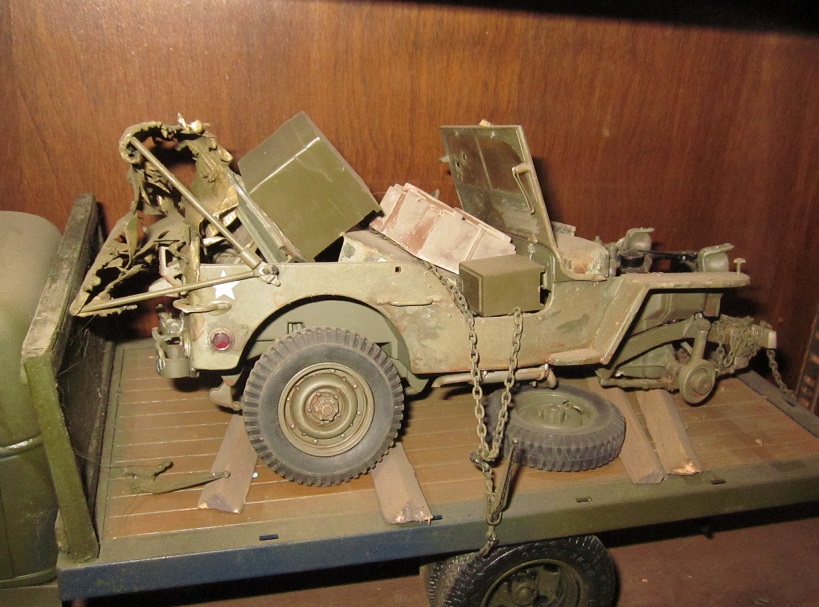

If you can find ones that are missing or have a lot of broken parts they can usually be had very cheaply and can make excellent starting points to make jeep wrecks that make interesting backroad pieces.
Here are some pics of some of mine. The first one shows where the screw for the 50 pedestal is.

Very nice looking jeeps, Greengiant. That first one I got was missing more than the top. :)

That's a great idea about the .30 cal, and it brought to mind my Grandpa (he drove one in the army) telling me how they usually had a .30 mounted, not a .50, and he blamed Rat patrol for people getting it wrong. Why Rat Patrol I have no idea, but that was the theory. I'm sure at least two of these will end up as static display pieces out in the allied camp, but I think I can RC one of them. We'll see when the crawler gets here. If the new one is nice enough I might just leave it in the box for now. I saw just one mint jeep recently that had an opening bid of $179 and it sold for that, but it was still in the plastic wrappers.
