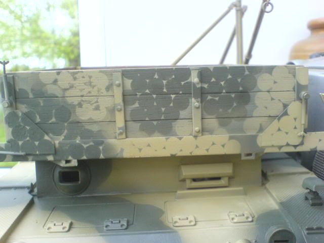

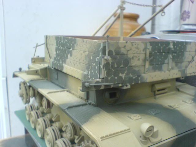

Looking GOOD. I like that disk cammo, might have a go at that on my HL Panther G if it was used on Jagdpanthers as well. Anyone have an anwser on that ? All the best for now.

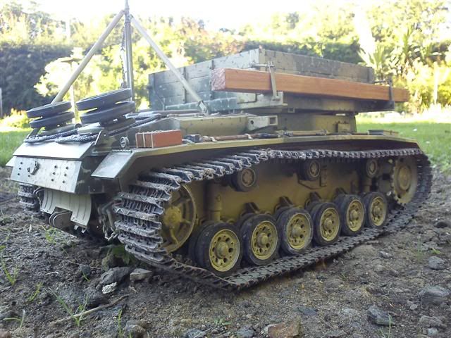

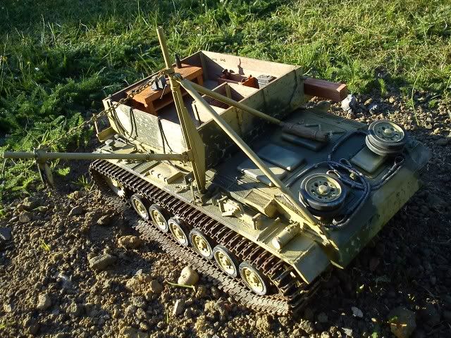

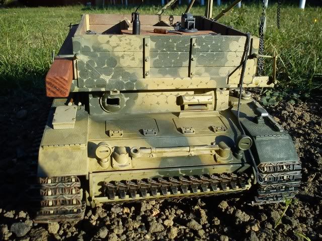

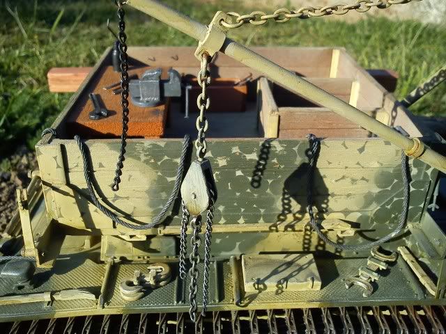

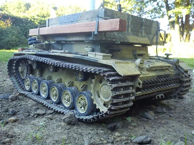

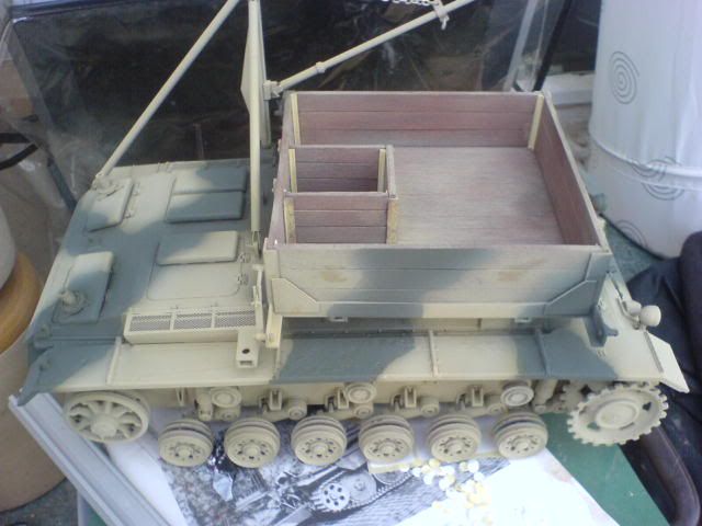

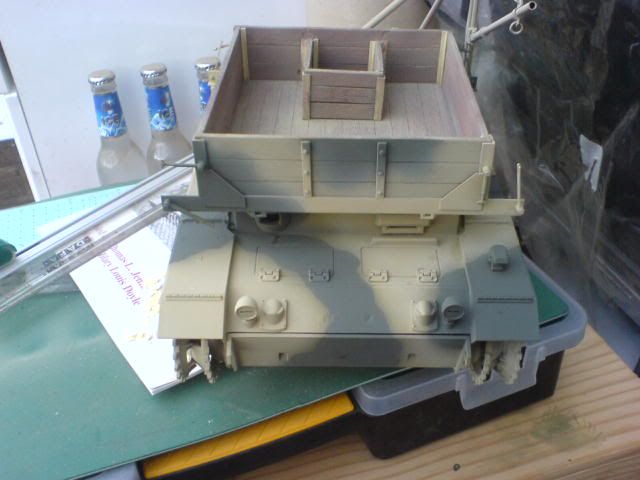

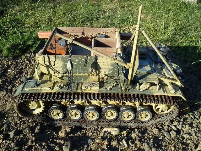

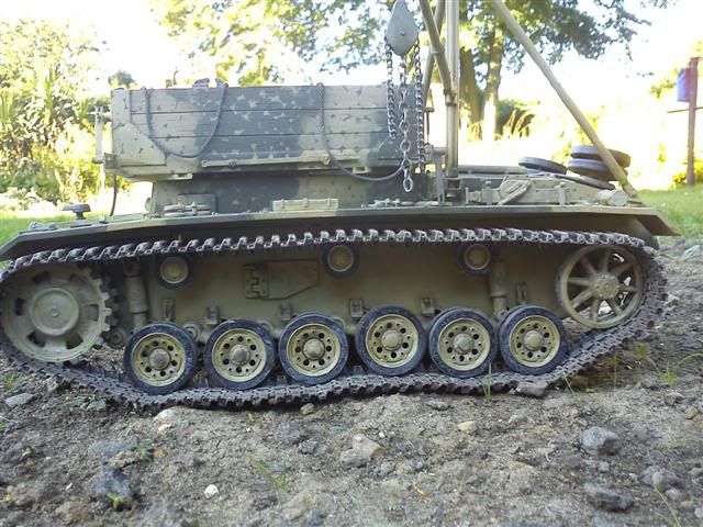

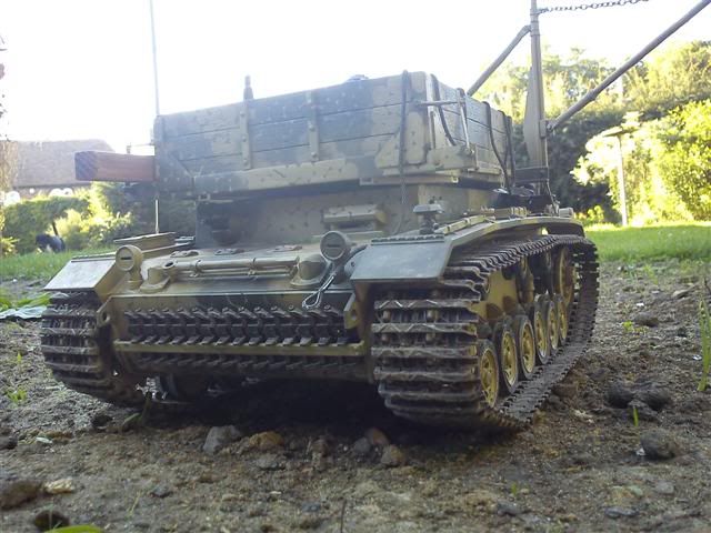

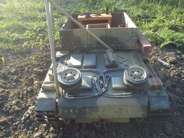

blimey ive got a bit more done to the berge , ive fitted the ostketten tracks and the tyres
then gave it a ink wash followed by some weathering , ie mud and soot , more to follow

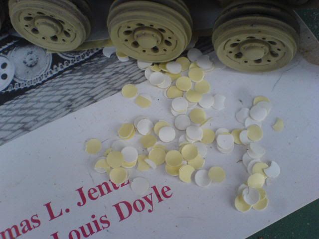

there are some archer rub down transfers for panthers in 1/35 according to the guy who designed them,the disk look was made by spraying through a stencil of the small triangle gaps between the circles,it seems that after the light dots were sprayed on the green and brown,that dark yellow was sprayed and a cloud edge stencil (maybe the same one that has the holes)masking the dark edge leaving a micky mouse edge,if you see what I mean,on your period pic I notice a pentagon pattern of dots on that triangular piece on the upper left,I've noticed this exact pattern as a part of a repeat pattern on a Panther that seems to prove a standard stencil was used,well known pics of HG div R01 show disc camo on the schurzen and are a good pointer to how it was done,It looks like your method is the closest practical way of doing it in model form,My next planned project is a Panther G with the disk look,its reckoned this method was in vogue for sept oct 44 not sure which factory,it was also seen on Jgdpz IV lang,and 38(t) based vehicles,good stuff Ice
