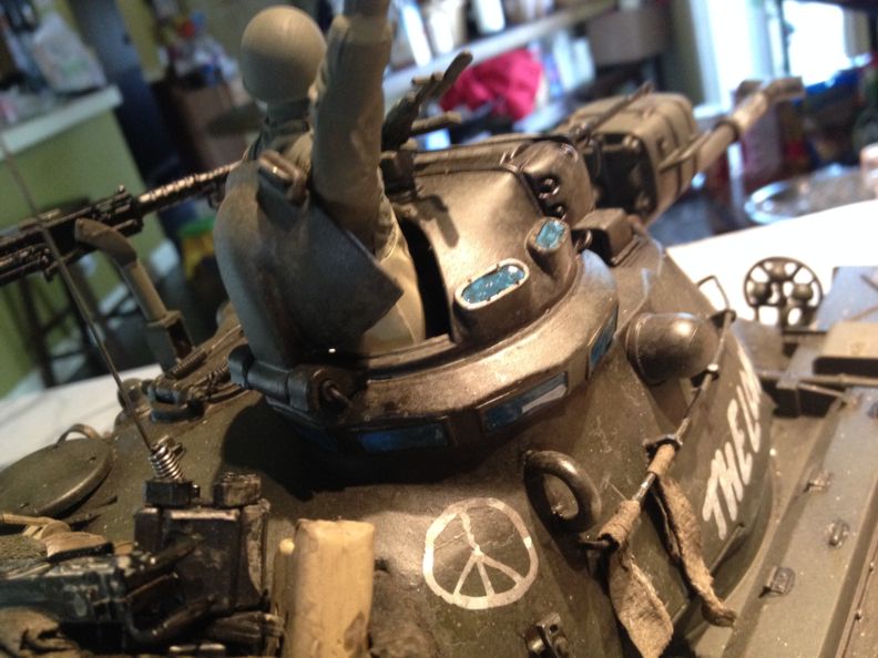

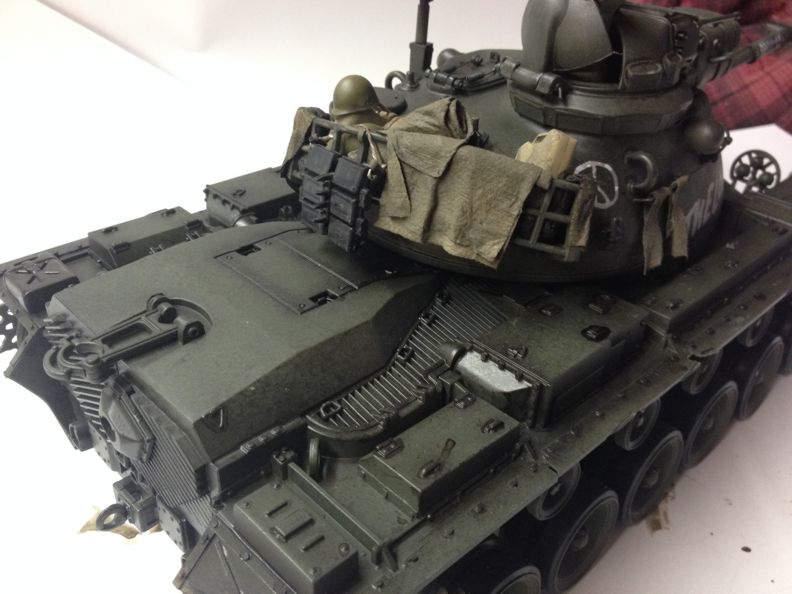

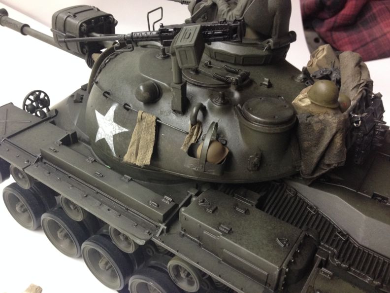

I decided not to rework the bulky looking rear storage rack due to the fact that I would be covering up most of it. Trying to not have a tank that is too fragile for the outdoor IR battle grounds here in town. Slowly building up that ...lived in look. :) All of the tarps and cloth goods were made with lintless towels here in my shop. I made up a mixture of Titebond and acrylic paints watered down and tinted to color or choice. Still trying to figure out how I will do the mantlet cover with the same process, but yet flexible enough for movement.

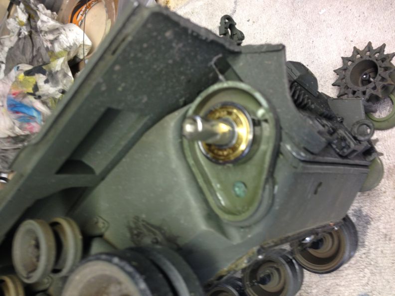

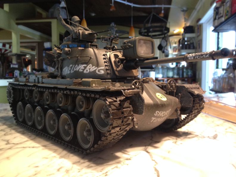

Thanks to MichaelC, I was able to put the tracks together today. First, I permanently attached the transfer case on the drive to it's final resting place and added outboard bearing support for the drives. After the backing plate was glued up, I cut up thick plastic sheeting and locked the bearing in place. Then I was able to attach the outer cover, drive wheels and finally the tracks.
I worked a bit more on some of the mud and dirt paintwork on it this past week as well. Still a bit more work to do in the paint dept, but closer.
I ordered a TK22 for designed for the Pershing. So the sounds should be pretty good. Then a bit of wiring and this baby will be ready to battle.
