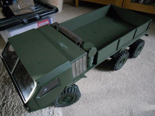

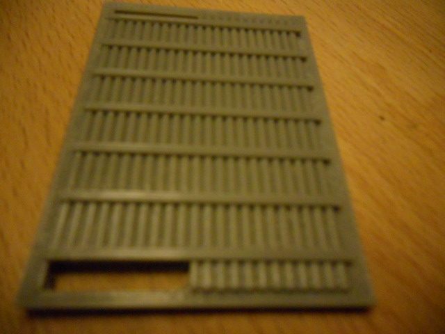

I decided to give the printer a clean just before I sent the new filament back, took the extruder apart and pulled out the filament from that end, and then pulled the other end of the feed tube...hmmm...that's not as long as it should be. I then discover an invisible length of filament halfway down the ptfe tube that would only come out with some persuasion. It was obviously this sticking filament that was causing the problems. Assembled the printer again and reprinted the radiator that had caused the problem in the first place.
This was pulled straight off the printer with no filing or sanding, it is as if it was injection moulded. Woohoo!! Now I can print the other bits that I have queued up.

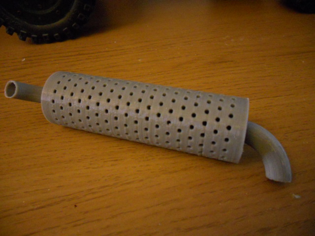

Seeing as the print quality has improved, I re-printed the exhaust with a different design, offset rows of holes, which is a bit more realistic. Took about 7 hours, but it came out well. You can see a line where I ramped up the print speed, but its only a minor glitch.

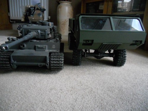

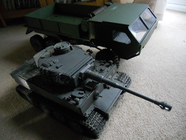

Hi Rob My 6x6 has just arrived ,boy its big your photos don't show how big your truck is ,think you should take a photo of it next to a Tank show the guys how big the truck is .
regards pete
Its on the shelf now waiting till I finish present job and gather stuff for DUKW .

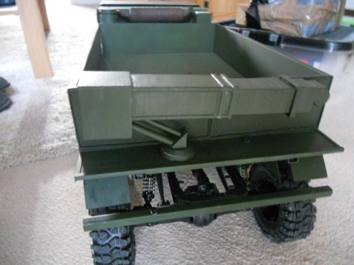

Your wish is my command, lol. Yes, they are a bit on the large size. Got 6 upgraded shocks on their way as the weight of the new bodyshell is too much for the standard ones.
