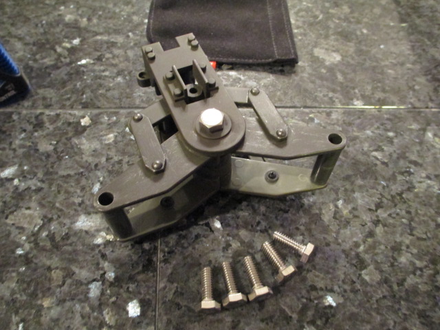

Those motors are 5 pole and 12 volt but will work well with the reduced output from the IBU2 ( 8.5 volts or summat ) Got around to the Home Despot today and found the bolts I need to detail the bogies, some of them anyway. These will be secured with a magnet to the screw caps that hold the bogies in place. Easily removed for maint. Picture:

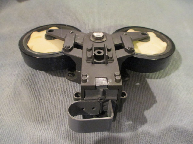

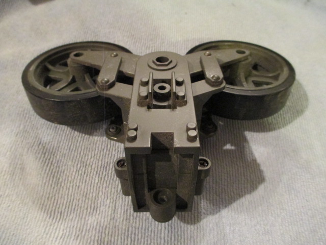

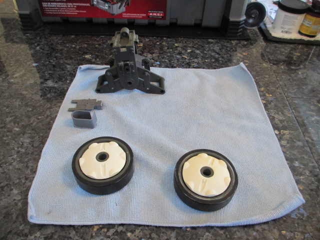

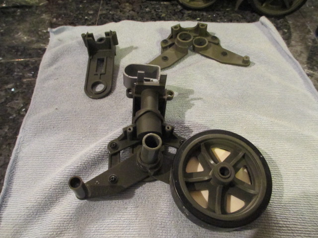

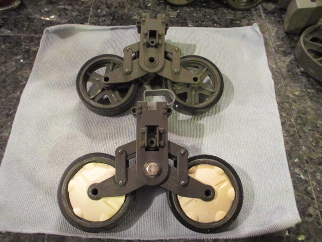

After some serious health issues dealt with ( *grumble, grumble* don't like going to the Docs ) I was able to stand at the counter last night and continue work on the Stuart. The resin I am using from ECA Armory is generally good to great quality but there are a few pieces where the resin leaked across the bottom of the mold and required a lot of cleanup. I had to get new brushes for the Dremel tool and maint.it before addressing the flow issue. For those of you awaiting copies of some of the rare parts I have for the Stuart, no word back from the fellow in England yet as to whether or not I can make them for you. I'm keeping an ear to the Ground and will let you know as soon as I hear something, good or bad. Anyway, Pics:
- ECArmory parts cleaned up and epoxied into place. I will use small screws to make sure that the track skid stays in place.
- ECArmory parts cleaned up and epoxied into place. I will use small screws to make sure that the track skid stays in place..JPG (98.62 KiB) Viewed 5180 times
- Stock Bogie top angle
- Stock Bogie top angle.JPG (98.41 KiB) Viewed 5180 times

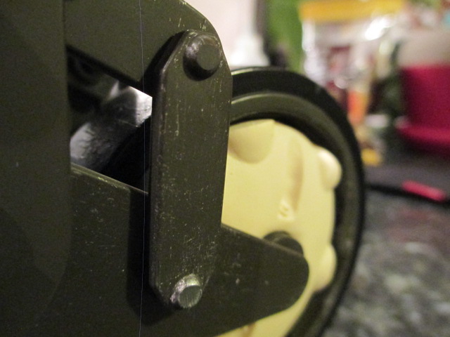

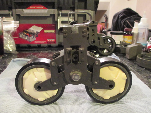

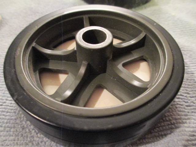

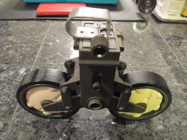

Spent a quiet ( well not really with the Dremel ) hour cleaning up the back of the two road wheels on this bogie and installing the covers on them. During the process, I mulled over the idea of adding the interior struts on the bogie as well. Space is fairly tight but with enough sanding on the spares I have or some thinner plastistrux cutouts. it might work. Something for tomorrow. Pics:
- Next, working on adding the interior supports like the real bogie uses. Space is tight so time for some plastistrux.
- Next, working on adding the interior supports like the real bogie uses. Space is tight so time for some plastistrux..JPG (91.17 KiB) Viewed 5170 times
