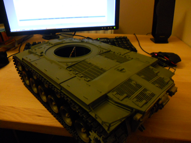

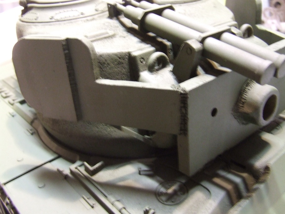

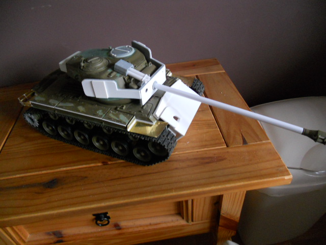

Decided that cutting the turret up was not the best idea in the world. Hydraulic rams work, eg inner/outer tubes and hinges at both ends. Still need to finish the counterweight off. Not much is glued together as I will have to paint parts before I can permanently attach them.

Quick work buddy. Putting me to shame and I'm not custom building anything!!

To be honest 80% of building one of these is thinking about how things go together, where they go and what looks right. Still can't get my head around the turret length though? Maybe the Tamiya is different, I noticed that the rear side toolboxes aren't sloped on the HL, so maybe they made a few 'adjustments' so that they could fit their elevation motor and gearboxes in there?

Quick, dirty and effective! Just like the original. Well done, Sir!

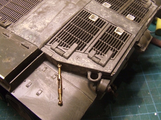

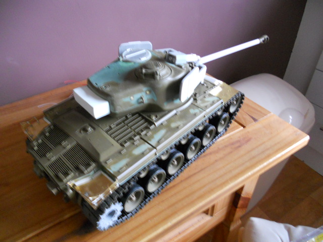

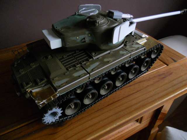

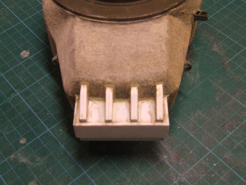

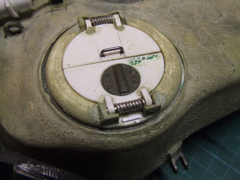

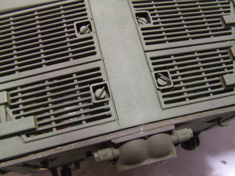

Wibbly here are a few pics of the Super P I did for Gareth the one I made for Dave is pretty much the same but is Tamiya. Turrets are pretty much identical. the counter weight has the four supports below it also I made the turnbuckles that support the fenders. also the engine hatch covers have different handles than standard. Dave has Metal barrels in stock that are perfect

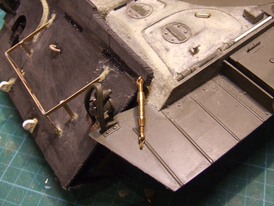

Just a few pics
I'm manning the gun's ! Who's driving ?

Thanks for the pics Nick, much appreciated. I have looked those turnbuckles on the original a million times, will have to try and make some out of styrene , that will be fun.
I saw Dave's, it was lucky that I spotted a cheap one on Fleabay a week later, so got that, and set to work.

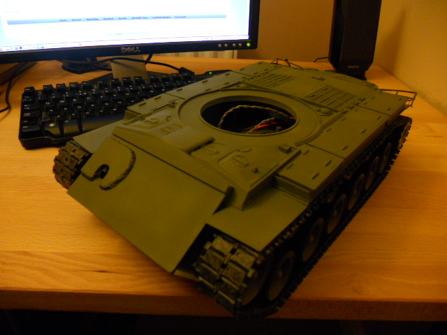

Had a bit of a nightmare this morning. Primered the upper hull with the remnants of one tin, and then used a new one (different brand) to complete the job. I check on it 30 minutes later and the dreaded crackle finish is appearing. No idea what caused it, but rubbed down the affected areas, and gave it another go, and it was all fine.
Gave it a going over in US Dark Green, and then decided that my 5 -8 year old cheapie airbrush has a needle that has seen better days, so I ordered a whole new one. They are only £30. Once that gets here I can get on with the rest of it.
Need to get hold of some half round styrene rod to add the strips on the front mudflaps at some point.
