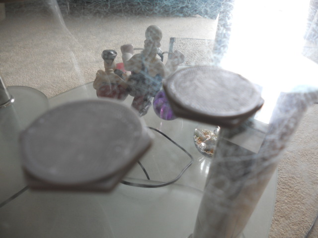

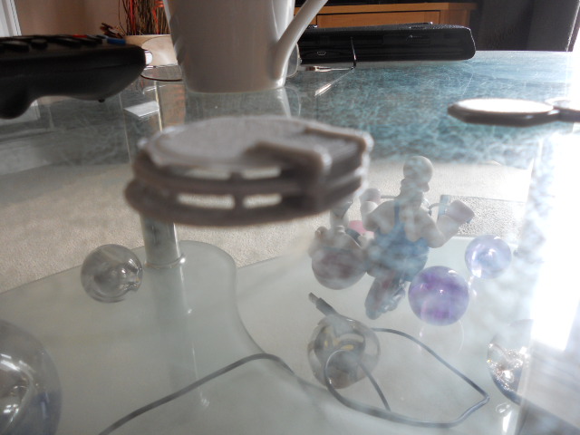

At long last
New nozzle, and using Cura rather than Slicr, a few changes to the printer settings in Pronterface, and I am cooking on gas. This was printed at 130% speed (1 hour 50mins), I repeated it after the video at 150% and the finish was almost flawless.
I am a Happy Bunny now.
