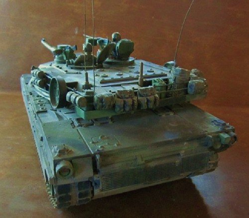

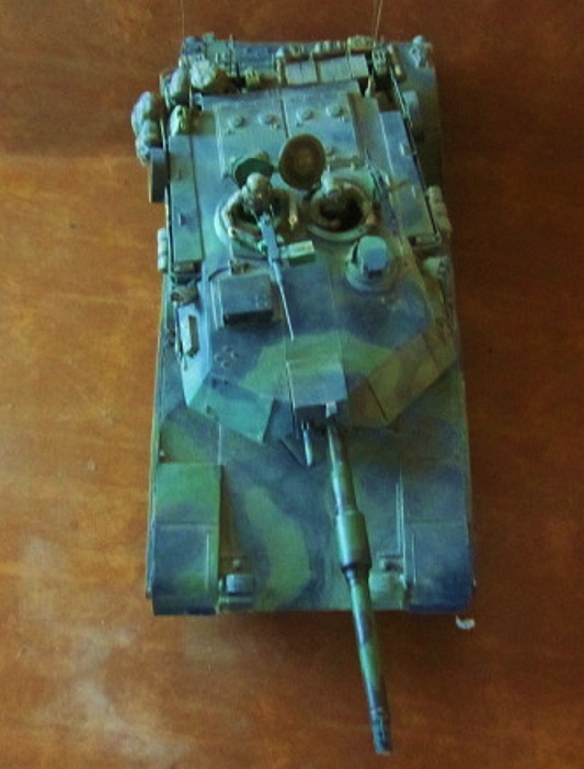

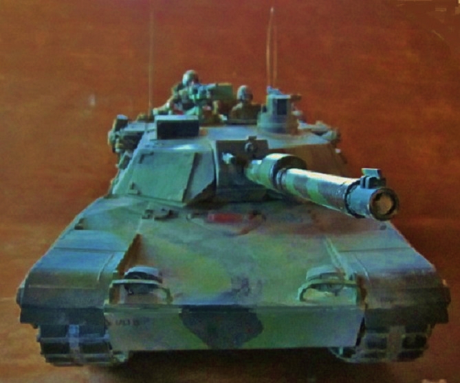

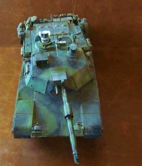

After much frustration with the new airbrush I resorted to the good old hairy stick and got a couple of coats of paint on. First coat was too dark but seems to be ok after a colour re-mix.
Still some finishing off to do with the side and rear recognition panels, then it's down to finishing and weathering, plus some stowage on the rear bustles to add character. I'll probably take it to the MAD meeting tomorrow to give it a run.
Alwyn
