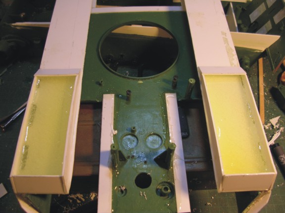

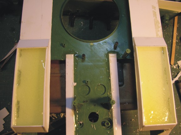

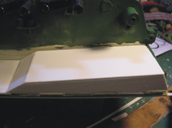

More epoxy fill! :haha:
So on the underside of D's and A's the vertical extension had a box like structure going back toward the lower hull so I decided to stiffen it all up by filling the box with epoxy. It also added some more stiffness to the plate running under the upper hull that I put in.
Panther A 68.jpg (49.11 KiB) Viewed 5362 times
Panther A 69.jpg (50.92 KiB) Viewed 5362 times
I then put the cover over and that was done! I think it looks pretty good and if flushes up nice with the back plate so far.
Panther A 70.jpg (35.45 KiB) Viewed 5362 times

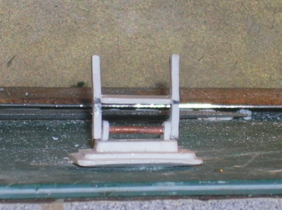

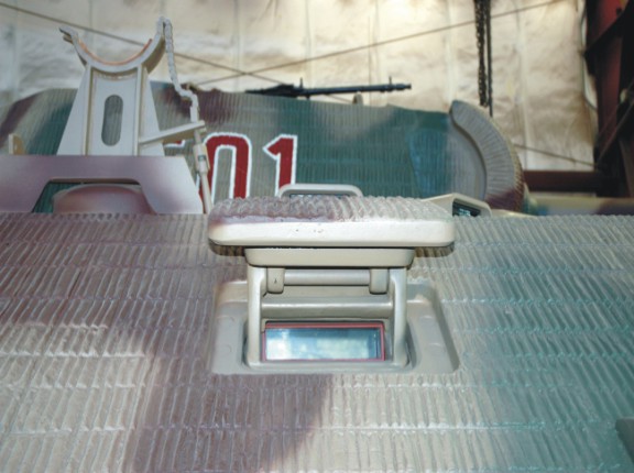

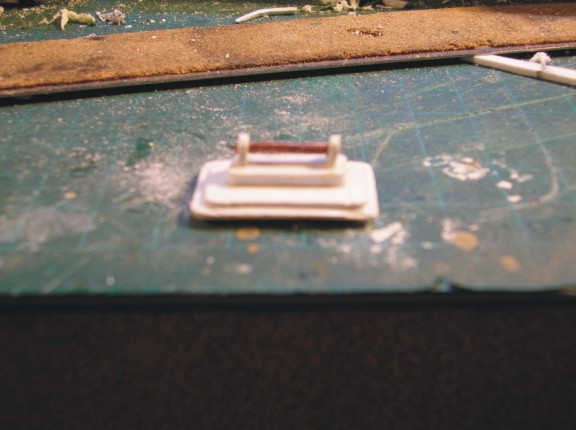

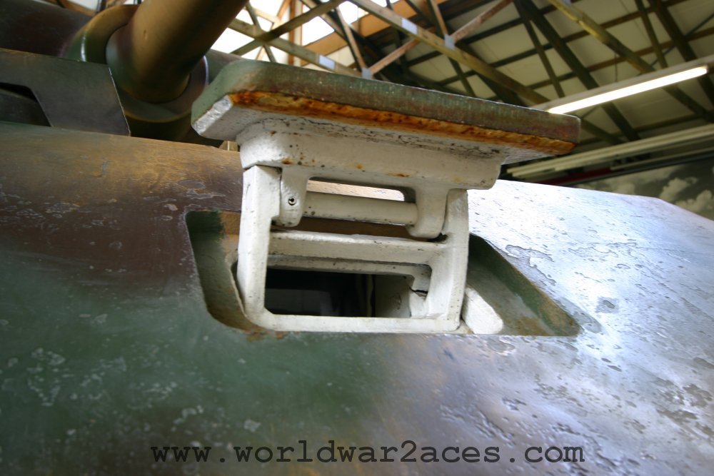

While I let this harden up I thought I would turn my attention to one of the centerpieces of this tank the front drivers vision port. I referenced a pic of the Littlefield Panther and a pic from worldwar2aces.com . to build it up from scratch:
vision port 2.jpg (56.94 KiB) Viewed 5362 times

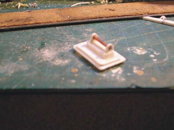

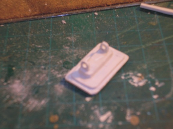

So started with the cover I had built earlier and put a little edge around it and added the hinge block and the 2 eyelets. Sorry, some of these pics are a little blurry! :wtf:
Panther A 71.jpg (40.6 KiB) Viewed 5362 times

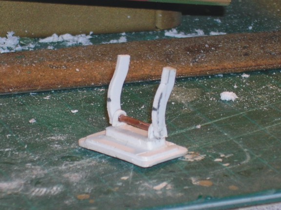

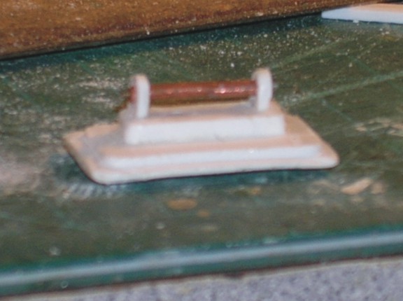

Then took a piece of little copper tubing and stuck a paperclip through the center to mount the cover's arms on a bit.
Panther A 72.jpg (50.49 KiB) Viewed 5362 times
Panther A 73.jpg (51.4 KiB) Viewed 5362 times
Panther A 74.jpg (46.39 KiB) Viewed 5362 times

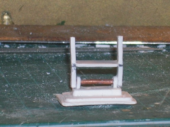

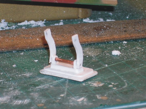

Here the arms are stuck on
Panther A 75.jpg (66.21 KiB) Viewed 5362 times

I then added the "shelfs" that box in the vision block (which I will make later)
Panther A 76.jpg (68.35 KiB) Viewed 5362 times
Panther A 77.jpg (57.92 KiB) Viewed 5362 times
Panther A 78.jpg (61.08 KiB) Viewed 5362 times
Panther A 79.jpg (63.91 KiB) Viewed 5362 times

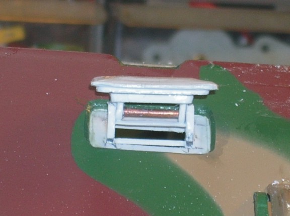

and here are some pics of it test fitted into the hole. I have made the tolerances tight enough that I think I will be able to close it when I want. This will be important when I go to do the camo pattern because I will want it closed for the pattern to go over it! :D
Panther A 80.jpg (41.22 KiB) Viewed 5362 times
Panther A 81.jpg (48.36 KiB) Viewed 5362 times
Panther A 82.jpg (39.08 KiB) Viewed 5362 times
