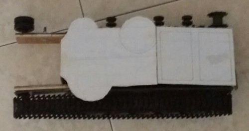

Here i have the primary 'sketch' of my super heavy tank.
Extension of the tracks was ugly......
