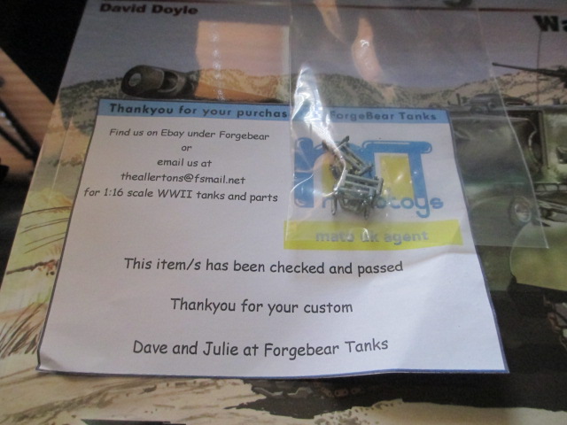

Post from the UK. Thanks again, Dave and Julie! Awaiting the electronics then some last bits from a small yet fiery island in the Pacific and wherever a wiring harness can be found locally, hopefully. Pics:
Rougher in finish than the Schumo scope guards, these will work fine on the upper hull hatches after some minor file touch up.
Rougher in finish than the Schumo scope guards, these will work fine on the upper hull hatches after some minor file touch up..JPG (99.33 KiB) Viewed 4205 times
Forgebear strikes again!
Forgebear strikes again!.JPG (88.31 KiB) Viewed 4205 times
