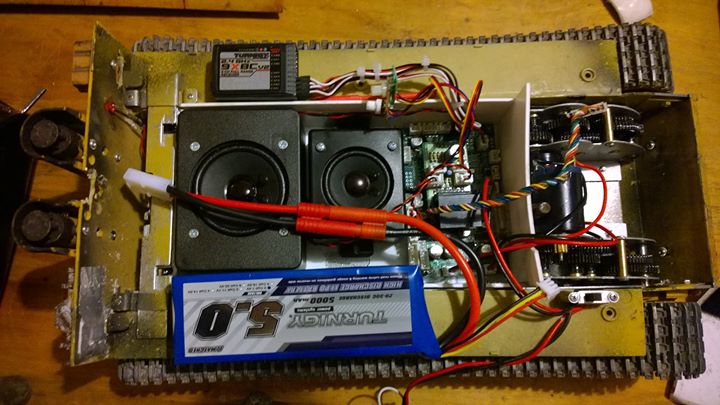

Well its been a while but finally got round to upgrading the tigers internals abit, first off I constructed a plasticard box for the electronics to sit in and add some more water proofness (the hulls full of holes) so the electronics are safe in puddles up to the top of the wheels (the motors are safe upto the drive sprocket center. Then I have added visaton large and medium speakers connected to my TPA/ IBU2 combo, also hooked up a 5000mah lipo and installed some driveshaft bearing supports.
Was not sure it was all going to fit and took some jigging about from my original plan but now engine noises are nice and bassy and all effects sound sweet! It's rammed in there now and not pretty but it all works am happy, here's a pic!
And forgot to say I opened up the drivers/ radio operators hatches and relocated the power switch under one, may put the volume controls under the other, after that I think I have gone pretty much as far as I can with this build so will be continuing to upgrade my panther g and my new panzer IV

Sponge,
I don't know, that looks nice and organized to me. Love the two speakers and can imagine the nice sounds that you have now. ;o)

by spongehoobtank82
Ah well you have not seen it with the upper hull attach as well, then its a right jungle! But cheers, it does sound great!
