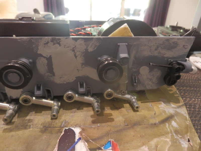

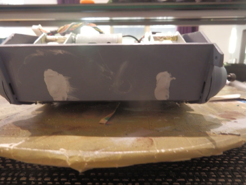

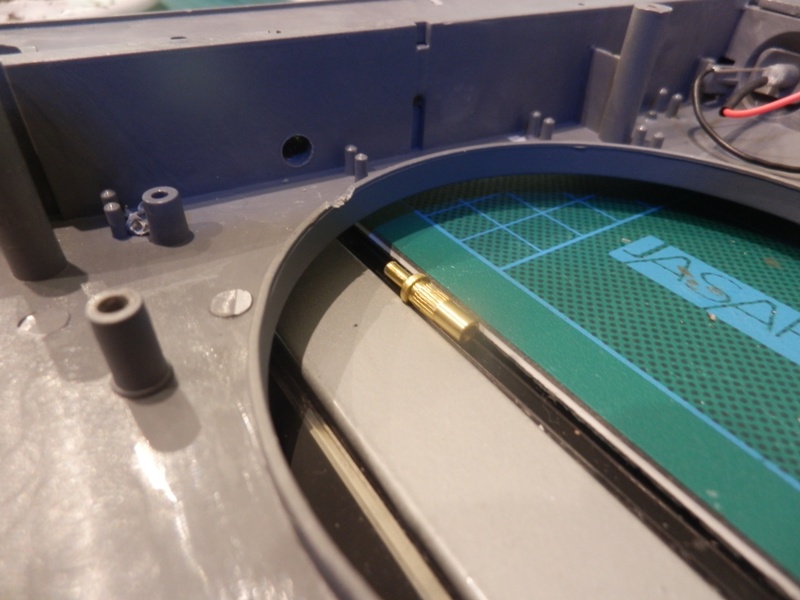

Ok, gotcha............well, this thing has a lot of holes that need filling.
Got out the putty & overfilled all the holes- including the hockey-puc dispenser !! Backed the holes with plastic card.
Also began the relocating of the folding aerial. Used the standard base, removed from the evil clutches of the factory glue fiend and drilled out the inside of the hull to accept it. Heated the end up with me trusty Jamie Oliver kitchen butane burner & pressed it in. Once cool, pushed it back out again.
Its a fraction short of flush with the hull interior, but by the time I screw in the cable it should be just tight enough to fold up & stay up by itself. But fold down if required. No turret to worry about, so no issue to hard mount up really. Good to see if the simplest version will work for future reference.
I may try to duplicate the socket that is correct for the outside, but as this is kind of an "Alpha-special quickie" it may just get the normal aerial bent up to suit with the spring coils to attach to the outer spigot. will see.
Fitted up the metal suspension and H/D springs...............pretty stiff it is, so they too may get the heave ho back to standard springs.
The lead and trailing arms have the vertical springs in the tele-tubes, so these will pretty much act as track tensioners.

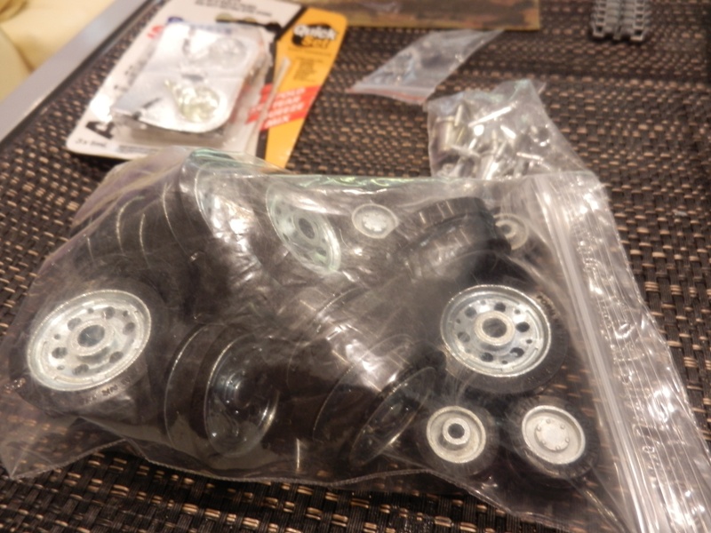

The metal return roller kit is on the way, so I can just tear the standard ones off if necessary. I have a plan for the old roller mounts later on, so cant be too brutal, but the basic mounts will be getting carved up if things go to plan, thats a fair old way off yet though.

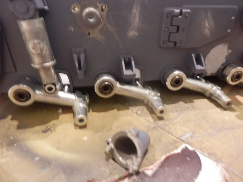

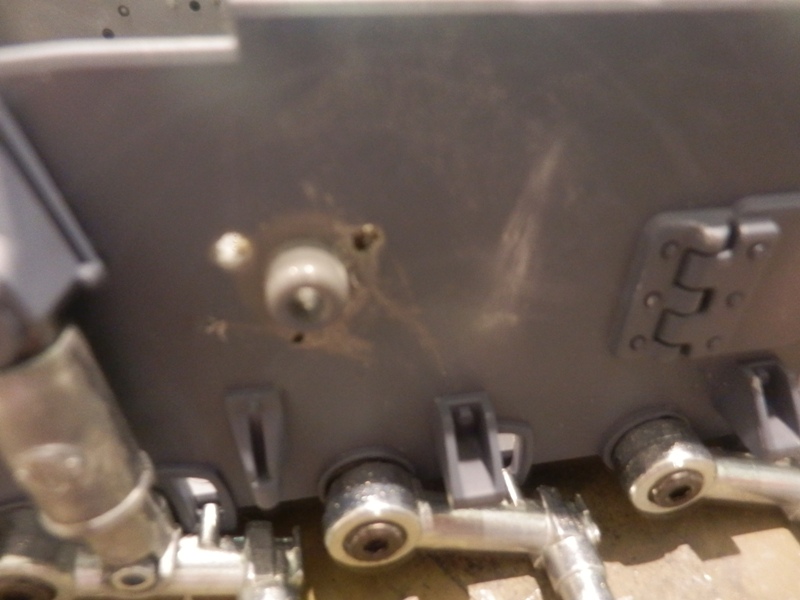

Well team, i heated them, stuck red hot pointers thru them and left them......................came back & did no more than rip the others off with a pair of pliers.
delicate was just not working.
Pulled the inner wheel shaft out then grabbed the housing with the pliers & reefed on each one until the locating pins broke off clean in the hull.
Then drilled out the remaining pin material.
took ages to do the front two, and they are much better located than the other four at the rear to get at from the inside.
Frustration got the better of me & brute force was the next process !!
Worked like a charm, still keep my 6 plastic mounts for the upcomming project(number 6) and the new metal roller mounts are on.

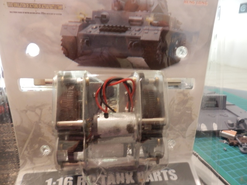

Also, got the steel gears out of the packet & set about them too. Found the motors were loose on the box plates. one was stripped right out of the box. Changed both of them back to the ones it came with. The original motors seem stronger than the new gear set ones. The new set had black ends on the motors - the ones it came with have white ones.
Any difference that you know of ?

HERMAN BIX wrote:Well team, i heated them, stuck red hot pointers thru them and left them......................came back & did no more than rip the others off with a pair of pliers.
UHHHHH... xacto chisel blade didn't work for those Herman???? 8O usually does the job for me..a couple of shoves in the right direction and off those towers come ;)
