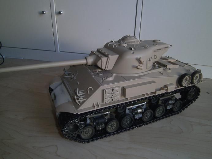

Re: IDF Sherman M50
looks good frank what mix did you use for the colour
dave
dave
- forgebear
- Posts: 1849
- Location: bedford
Re: IDF Sherman M50
still looks good like that mate i have some where the mix code for the idf
- forgebear
- Posts: 1849
- Location: bedford
Re: IDF Sherman M50
According to what I've read and seen in pictures, there were M51 painted
in a kind of Olive Drab and a Desert Yellow typical of the IDF which is
very close to the Buff. One of our collaborators, suggested me to use a
mix of Tamiya Desert Yellow XF-59 + Buff XF-57. Actually, I believe that
these tanks once painted had a semi gloss finish, but as result of the
desert, they quickly became matt, so it’s correct to paint them matt color.
Once the mix was prepared, it looked very yellow, more similar to the
paint needed for a vehicle of the WWII burnt by sun exposure than for an
Israeli one, so, I added very small amounts of grey, yellow, buff... etc
until the result satisfied me. I think this is the best method since the
IDF didn’t followed the FS standard but the resources they had to hand,
and two equal vehicles in different periods would look different.

Re: IDF Sherman M50
I lightened the centre of the panels with very diluted Buff
For the weathering, I used acrylics starting from a couple of filters
with burnt umber as well as punctual washes with the same acrylic
darkened with black and /or lightened with burnt sienna, and grey,
white, rust pigments...etc.
The traces of water were made by applying a point of acrylic white,
giving downward strokes with a clean brush wet in alcohol. In this way I
accomplished different vertical marks, mixing yellow and white points.
I didn’t consider it necessary to give any drybrushing, but black lead
taken from a 6B pencil scraped with a #180 sand, applied with my finger
tips on the hatches’ edges, tools...etc.
I painted the tracks with XF 64 and gave black and buff washes. Then,
white and sand pigments were applied and finally I used abundant
graphite for the area where the tracks touch the ground.
The ID plates were drawn and printed in paper to be later glued on the
hull. The size should be around 25mm.
dave

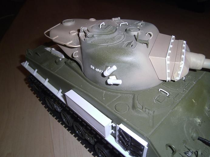

Re: IDF Sherman M50
YOU DEMON!fynsdad wrote:LOL..I can always look into postage for you Mike![]()
...anyway on with the build......got some more stowage on and replaced the hatch handles. Hoping to get the jerry can holders done tomorrow![]()
........... Torturing poor me ... here stranded on a Rock in the Pacific
One day fynsdad,,,, One day
Re: IDF Sherman M50
fynsdad wrote:Still got a bit of work to do, but took advantage of a break in the weather to blow a quick coat of paint on![]()
WOW!... JUST WOW!
Re: IDF Sherman M50
If ye treasure box allows ... get it cannedcannedheat wrote:looks better all the time nice one .........wot wot
