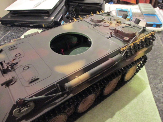

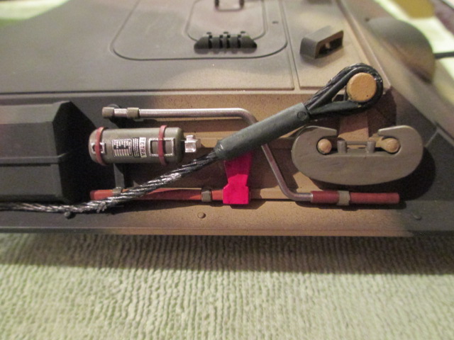

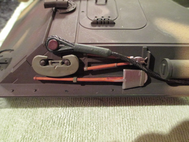

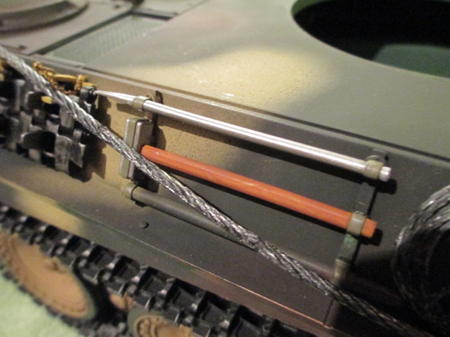

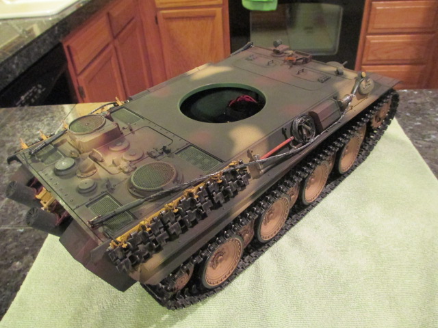

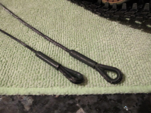

17th Day work involved getting the tow cables cleaned up, painted and mounted on the tank. I usually do a color which works with the rest of the paint on the tank but will set off the cabling or any tool or fitment that is supposed to be clamped to the exterior. After a brief experiment with dark green, the black green was picked for the cable eyes and shaft with a light silver dry brush defining the twists of the cable itself. The rubber knobs used to keep the cables in place up front were painted to match the camo on that left and right tool rack. I painted and mounted the pry bar afterwards so that I could keep to my one pioneer tool mount per session. More fun tomorrow.

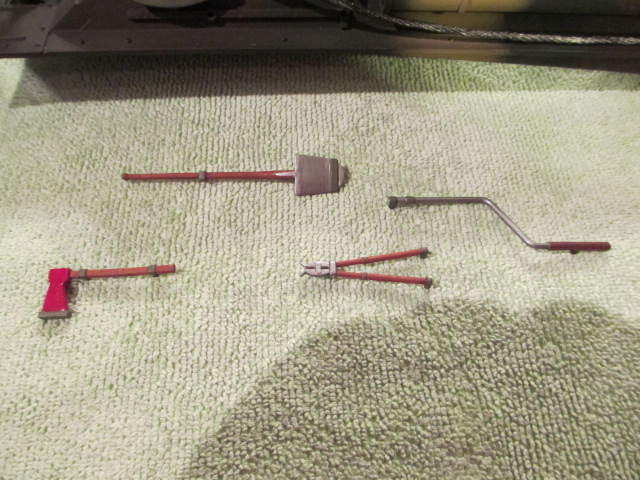

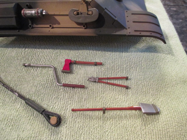

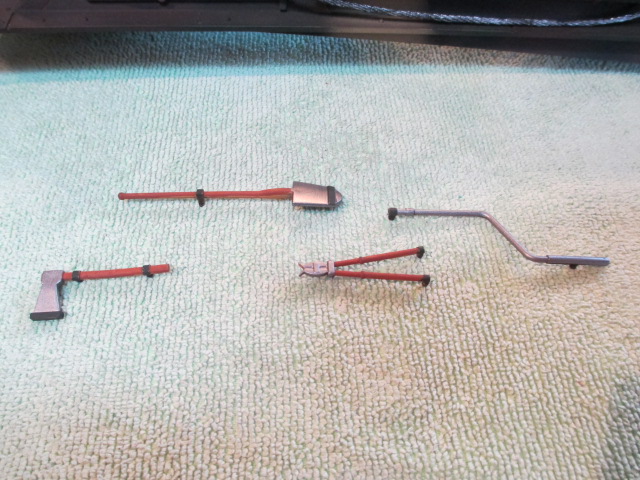

18th Day work involved cleaning up and painting the rest of the Pioneer Tools There's one thing I have left to do on the rear deck with what I have to work with now, then I am waiting for parts to arrive. We have had terrible weather and flooding along the Front Range all the way into today so I am in no rush. More fun tomorrow.
- Posts: 7863
Re: Taigen ( Fancy Heng Long ) Panther G

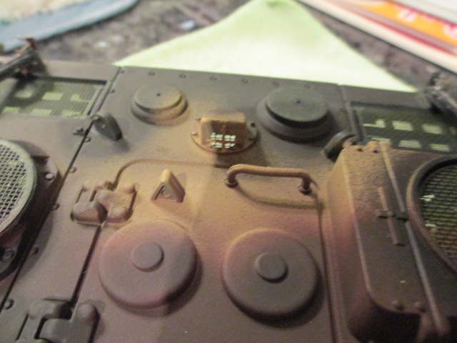

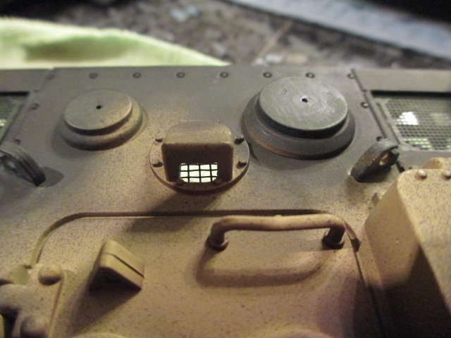

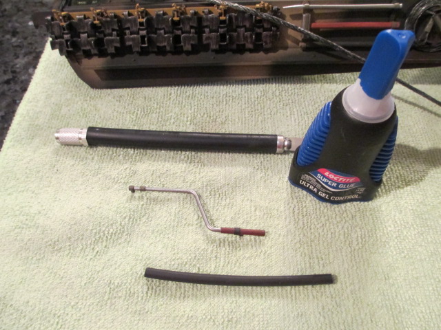

19th Day work involved finishing up the crank that mounts with the Pioneer tools. Heng Long had molded this part without the clamp that that would normally go around the handle. After a bit of thought, I took a piece of shrink tubing and cut a clamp width slice out of it and slid it over the handle. A second's worth of heat and I had my clamp. I painted it to match and installed the crank and the Pioneer tools on their mounts. They don't look bad but I believe that I will use a sprue of Tamiya tools the next time like I did on my KT build. Then I approached the issue of the central vent on the rear deck. I had already installed the grill under it but it also needed what looked like a welded metal cross in the mouth of the vent. A tiny section of flat brass cross later plus paint and the part certainly looks authentic. ( As if drunken tankers had welded it on in the field ) If anyone here needs something to look shoddily and hastily welded onto their tank, buddy, I'm your man. Waiting on parts now so more fun when they arrive. Hopefully by this weekend.

Just an observation on the axe, I don't think they painted them red (or fire extinguishers, seen some people do), if anything black as the tank is camo you wouldn't want a nice little red target to shoot at.

I used to paint the fire extinguishers red as well until I saw how good that they looked in flat and now with decals. I admit that the red axes are just the ten yr old in me taking control of the paint brush. *chuckles* I apologize and will do better next build. ;o)
