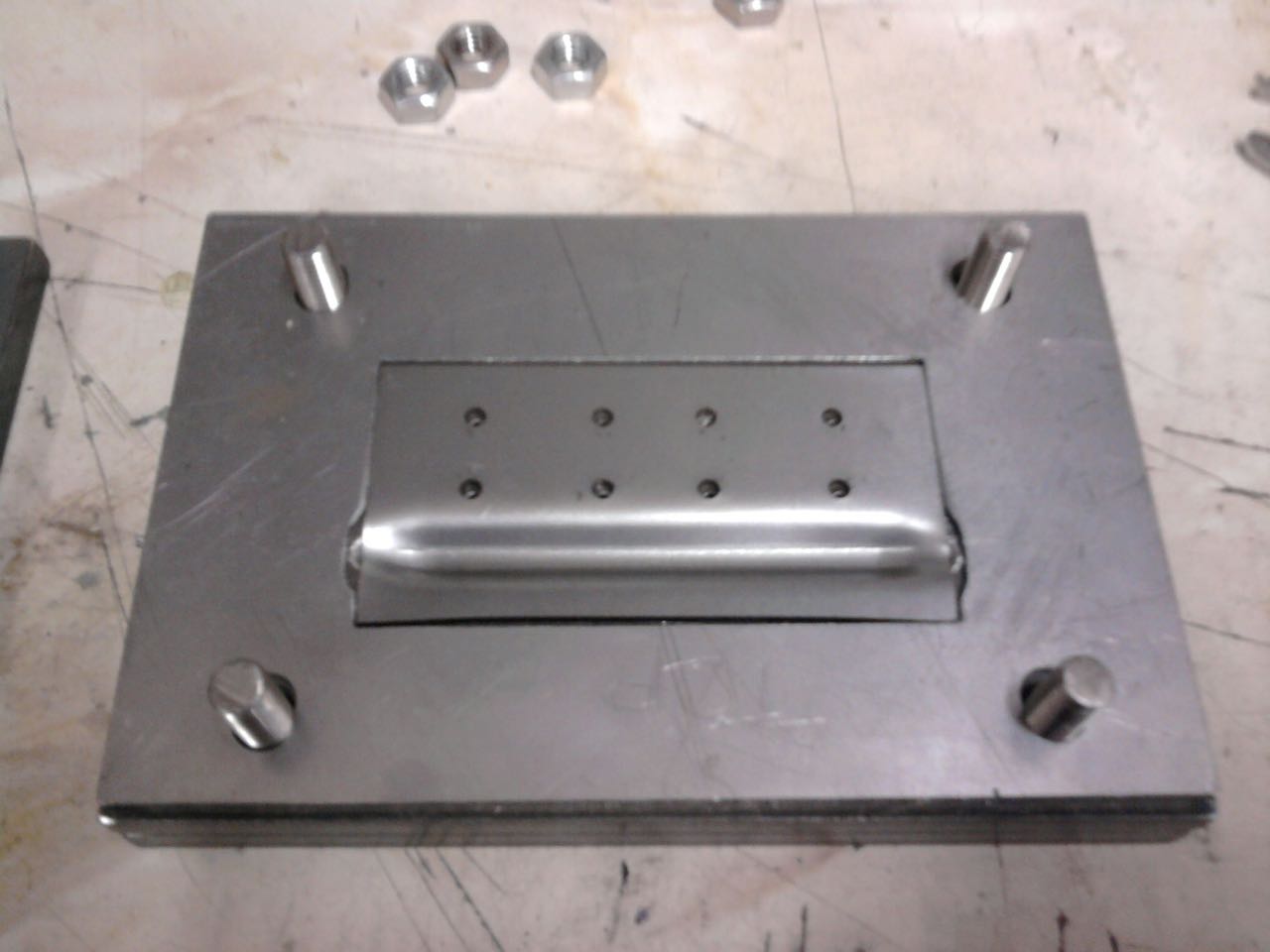

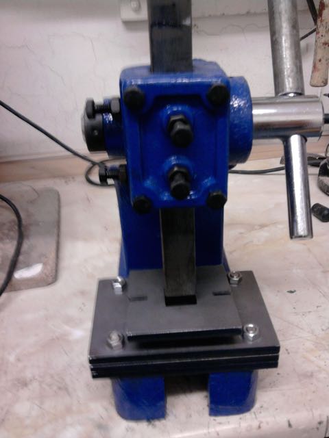

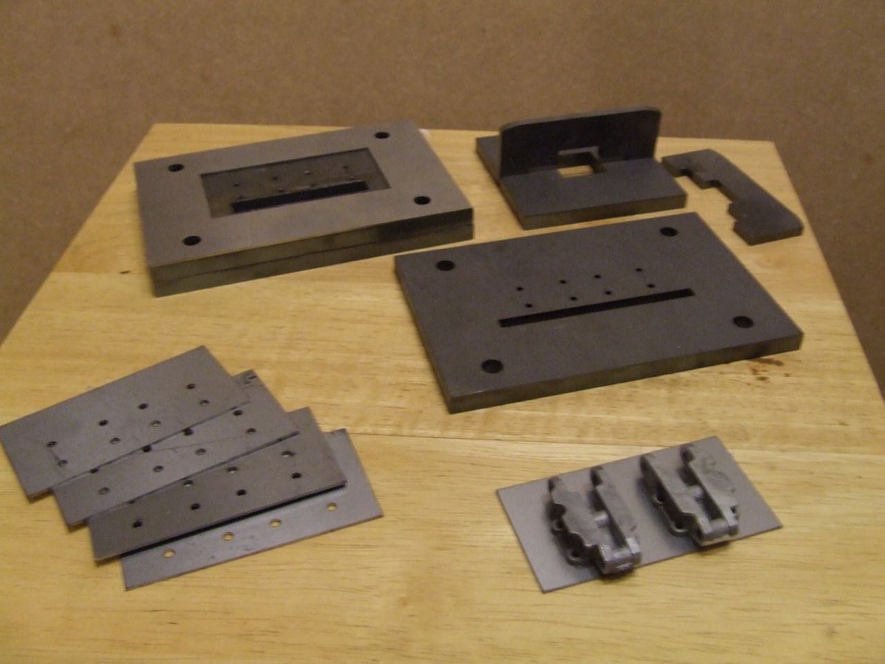

The Track has been one of the hardest parts of this build, not just in their complexity, but because they had to be right! For me, the Track is key to getting the look of these metal monsters and I couldn't bring myself to compromise on the looks.
I think I got to version No8 before I was happy with the look and strength of the Track Links. The luckiest part of the track build for me was stumbling across a small metal casting company called Abbey Castings. Finding small casting companies that don't mind getting involved in the unusual is not easy.
The Track Plates again I had a lucky brake. A member on the Landships site kindly shared the technique he used to press his track for a 1/16 scale model he is building. All I have done is scale it all up and get the laser cutters to cut me some steel.
The Track Plates I had cut out of 1.2mm mild steel. The mould for the press I went with 8mm steel, well it had to survive nearly 200 pressings. :)
Unfortunately I don't get to work on the model all that often, so it will probably be a month before it rolls on its track for the first time. There will I'm sure be a photo or two and a video on that day. :)
