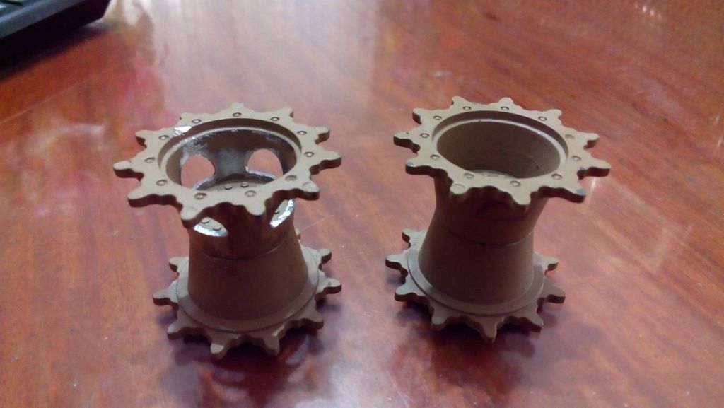

I've finished drilling the lightening holes on one sprocket. Not perfect but who cares. Will continue later for the other.
Re: Something I've been doing the past days
I used an HHS drill bit 3mm and two tungsten carbide grinding bits from Dremel. The first hole was done with a dull drill bit. Getting a new one made drilling much easier. Then used the bigger of the two grinding bits to enlarge the hole, with final shaping with the smaller bit. Then cleaned up with a steel brush bit. I bathed the sprockets periodically in 4-in-1 oil and did some grinding while the sprocket was under the oil to make grinding easier and reduce heat build up. Removed the oil and cleaned the sprockets using liquid detergent and lots of brushing with an old toothbrush.
Drilling/grinding on both sprockets are done, and tomorrow I'll be painting it. Installing on Sunday or Monday night.
