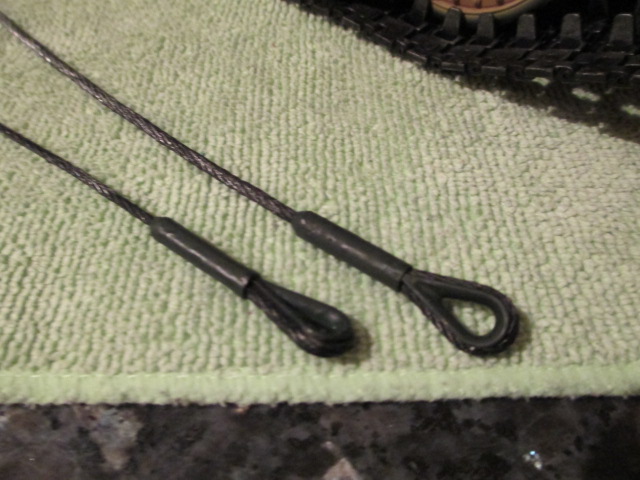

Good Morning, Jeff,
Per the Tow Cable paint question: I lightly brushed the cable with gunmetal and silver to define the twists then brush painted the hasp and shackle of the cable the color I wanted them to be since they are mainly inflexible. (Acrylic green\black) I hope this helps.

Thanks Painless. i guess I was being overly ambitious with my approach to the tow ropes. Sometimes the simplest solution is still the best. Since the tow ropes are already black, I guess I just need to dry brush it. My only problem now is removing the primer completely. I'll give it a go.
