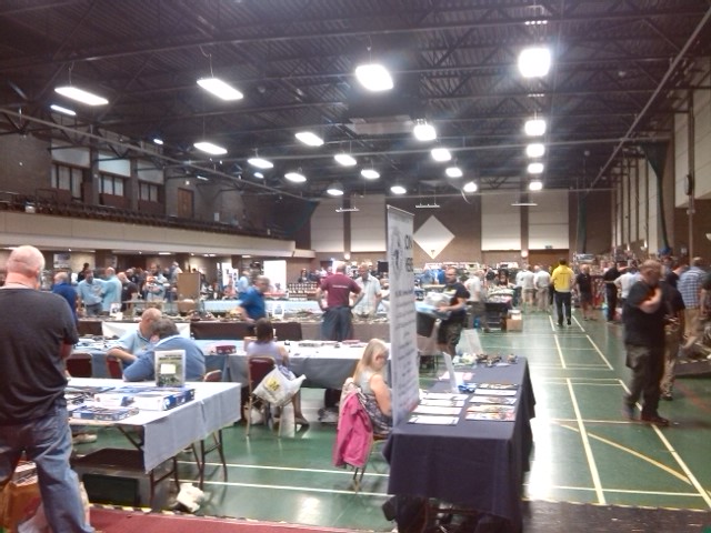

It was great to see you again Andy, and glad that you enjoyed your day out. It was indeed a good show, loads to look at, and some astounding models on display. I wish I had more time to seek out a bargain, I know George did!
The organisers were showing a great deal of interest in what we do, and I think everyone agreed that we had a much better set up and display than last year.
Here's my pics.
Here's my pics.

It was good to see Andy and a small selection of his fleet! More were available, but there were no more tables. There was a lot of interest from visitors to the show. All in all a good but tiring day.
Richard
Re: Bristol Armoured Division
Great setup, looks like an excellent show, thanks for posting up the pictures!
