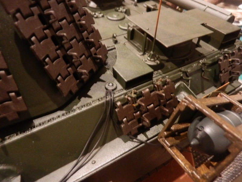

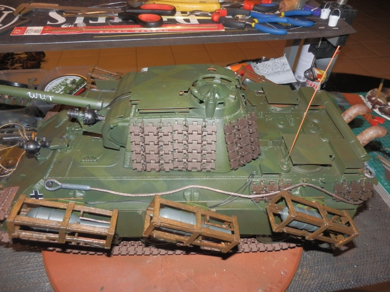

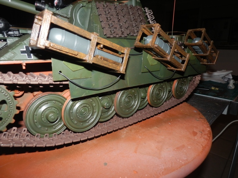

Yep, the gadgets seem to bring it together. Got the cables on today, 8O 8O
And the tow cables painted & fitted. These need a touchup as lost a bit of colour during the "damn you just stay there" process :haha:
The cables were fitted dry into the rocket motor tubes so I can remove them if I need to for any reason.The cables will stay-can be rolled up & stowed, but the rockets can be taken out.

tow cables hung
tow cables hung
firing cables fitted to rockets
firing cable hardpoints

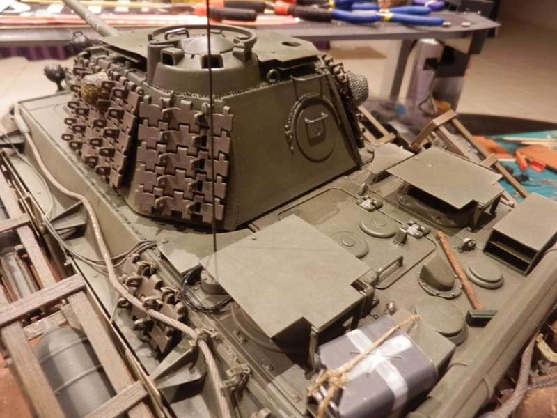

I was piss farting around last night & today to fill in a few details ;
Hull MG- done(pics later)not yet painted.

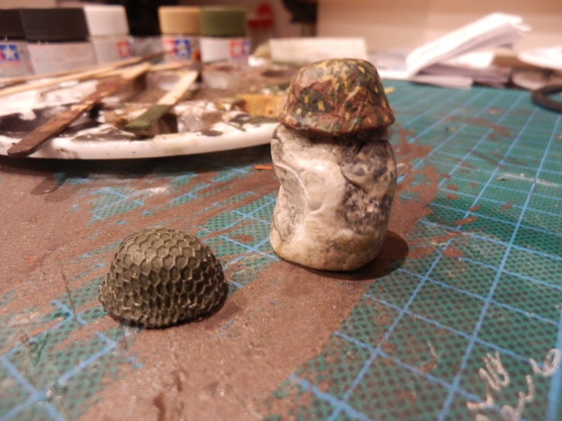

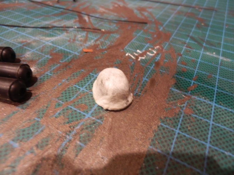

Hmmm, featureless area of rear turret.............Helmets, easy ? Wanted one with chicken wire & one with a cover.
A water jerry can on one of the vent armour blocks(yet to be secured)
Light mud application by blowing over a brush covered in dark earth( to late to run the compressor)almost passed out from hyperventilation, the Mrs nearly pissed her pants laughing :/
Overall dust using Buff this morning. Might have been a bit heavy handed on the buff though it does not photograph very well.
I might go over it with a bit more dark earth.
Handles rubbed with a pencil
helmet, toilet paper,white glue!

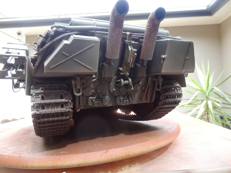

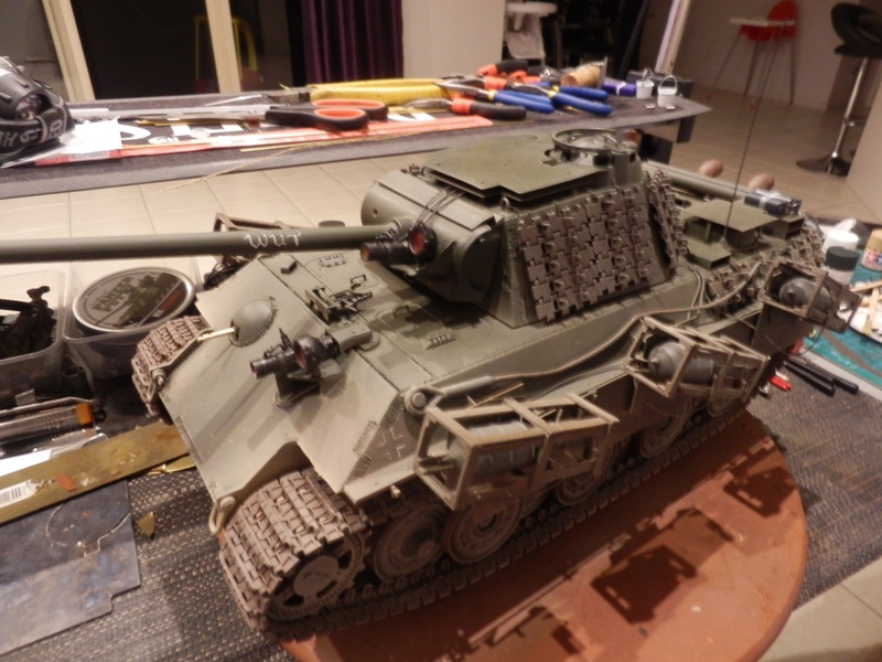

Ive had some track issues this last couple of days, thought all had been taken into account early on, but the added weight overloaded the suspension.
Had to remove all the roadwheels & suspension arms. Fitted King Tiger heavy springs AND clocked them as well.
Was a rock-show reinstating all of them without disturbing the details already fitted :problem:
Took a long time and much "walk breaks" to calm down.
Got out of it with only one equipment failure.............the track pin pliers broke off the rear plate , phew. ;)
Tracks back on and test run successful.

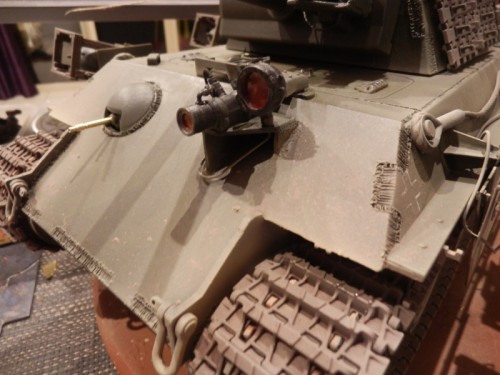

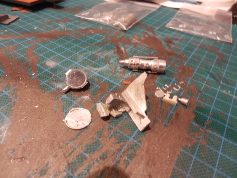

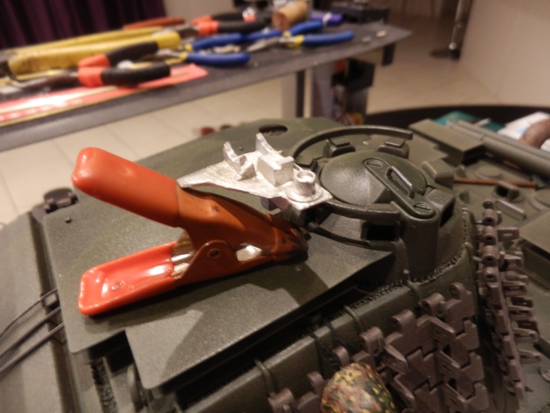

Fitted the two helmets and a sledge hammer, the water jerry can and began the commanders NVG set.
In all honesty, the commanders set is the worst of the three in quality & accuracy. The pot metal is porous & heavy in mould lines.
The spot light is not like the other two- this one has a metal lense !! :wtf:
I replaced it with a clear lense, its not a cover either.
A plus is that the cable joints are pre-spotted so not to bad to attach the cables once all set on the MG ring.
