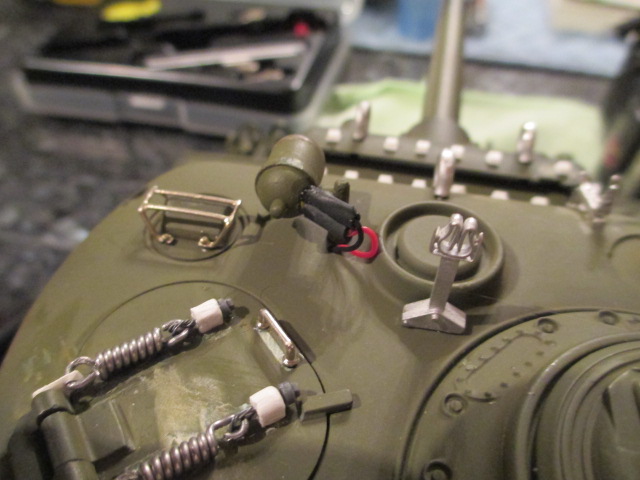

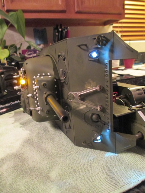

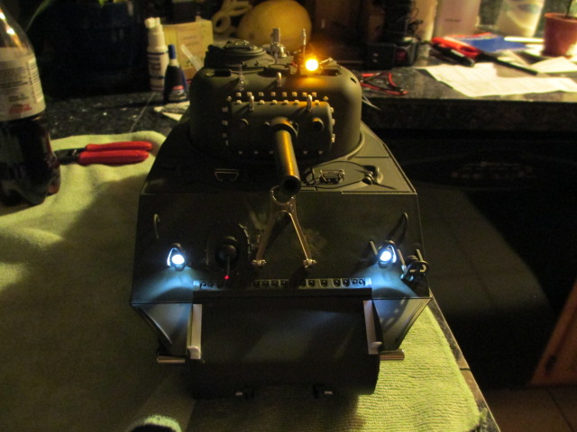

50th Day: After all of last night's work, I started out by plugging in everything on the upper hull and trying it out. It all worked great and the main gun at max elevation cleared everything inside. Next, I tested the thing that has given me the most goosebumps, the searchlight. It 'had' a 'grain of rice' led headlight bulb in it from a headlight kit I got for my Panther build. I say 'had' because I wound the contacts around the hot and ground on a headlight and switched the tank on. I got an odd behavior which consisted of the headlights flashing as normal then the searchlight flashing and back and forth. ( the headlights would flash then the searchlight would flash ) I think this may have been because the battery was low. I started the tank up using the controller to see if all three bulbs would light. The headlights did but I heard a loud pop up on the turret and quickly shut everything down. I removed the led from the back of the searchlight housing and yep, it and the red wire were fried. I'll go to Hobbytown tomorrow and see if they have a slighter stronger bulb and actually solder it on. I'll use a fully charged battery and see if that fixes the weird and intermittent flashing issue. Pictures:

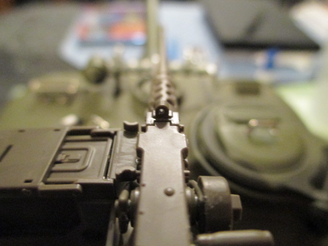

- Closeup view from the other side showing the muzzle drilled out.
- Closeup view from the other side showing the muzzle drilled out..JPG (99.17 KiB) Viewed 2356 times
- Just a closeup showing the previous drilled out sight on the .50 cal.
- Just a closeup showing the previous drilled out sight on the .50 cal..JPG (81.97 KiB) Viewed 2356 times
- Searchlight housing with led and plug removed
- Searchlight housing with led and plug removed.JPG (94.27 KiB) Viewed 2356 times

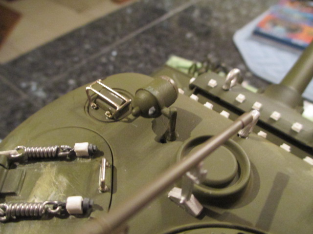

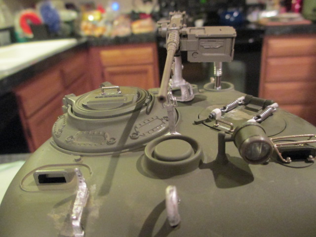

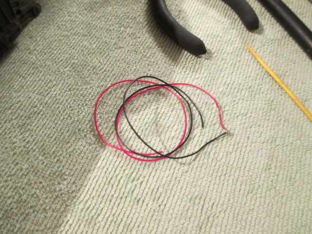

51st Day: While looking at Phil's YouTube video of his Sherman searchlight in action again this morning, it struck me that I didn't see any headlights on his tank. Knowing Phil, he has it rigged up for a separate on\off on a IBU-2 or summat. On the Taigen RX-18 tho', I learned after going out and sourcing some LEDs and coming home and replacing the fried one in my light, that if you are hooking to the headlight circuit, you either have the searchlight or once that connection is removed, the headlights. No other way would it work. Bearing in mind that I had just blown one of the LEDs the night before, I made up a test one using wire and mini alligator clips. I had bought a pack of twenty assorted LEDs so I could afford to poke around. I used the Taigen basic layout sheet and looked for empty pin connections that would have constant power ( and not frizz anything important like the speaker port, etc. ). I did eventually find a hot\ground and now have a working searchlight and headlights at the same time. If anyone is interested, the connections are the left two of the three pins normally left empty of the M.Q.Fire 5 pin port. The other two pins are taken up by the two pin plug from the airgun (which btw, no longer needs to have the pins swapped out in the plug for it to work normally on these new Taigen sets). That was pretty much my afternoon. I may redo the LED connections a bit in the searchlight now that I have gotten it to work. The new LED and wires are a bit kludgy compared with the elegant grain of sand LED I had in there before. It is a nice old school yellow tho'. I will have to coat the headlights yellow to have them match up more now. Pictures:
- Not the cleanest mount, it will be revisited to get more of the LED inside the body of the searchlight
- Not the cleanest mount, it will be revisited to get more of the LED inside the body of the searchlight.JPG (97.43 KiB) Viewed 2334 times
- A bit more putty smoothing while I waited for the LED shop to open
- A bit more putty smoothing while I waited for the LED shop to open.JPG (94.17 KiB) Viewed 2334 times

Re: 1944 M4A3 105mm
Hi Painless
Sorry for the slow reply, your just a quick worker.
I used a yellow LED and wired it up to the main lights, but I didn't really want the front lights on so I disconnected them. The IBU-2 has a feature as you guessed that can turn them off with the TX stick held in a position for 5 secs.

- Posts: 7874
Re: 1944 M4A3 105mm
Morning, Phil,
Hearing that you are on the mend and will be tanking more often is the best news I've had all morning. It will be good to have you back. ;o) You haven't hi-jacked anything, my Friend. I need your thoughts on what I'm trying to do anytime you feel like passing them along. ;o) Stay safe and well. Today, I'm going to try to cleanup the wiring going into the searchlight so after it's painted, it will be less obtrusive. I'm going to remove the heat shrink I put on and instead, put rubber cement on the hot wire where it is soldered to the LED. That should prevent shorts and allow me to push the LED all the way into the searchlight so I can close it up. ( I spent some time yesterday carefully sanding down the LED so it would fit inside. )
