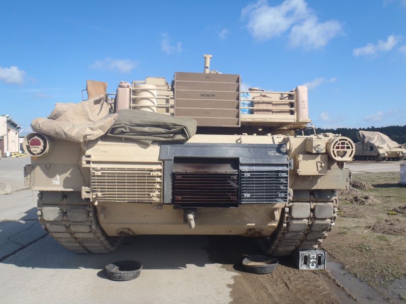

You probably already have this pic the shows the slats but since you mentioned you thought they were different I post it anyway.
Its a V3 rear end but I think the rear vents are the same.

Thanks GG, I do have that photo.
Here are the ones that are making me question angle.

Your pics are much better. They do show how steeply downward those diverter panels are pitched on all three sections with the outer ones being steeper then the exhaust. When the covers are in place the steepness is pretty much hidden and they almost look just flat with no space between them when viewed straight on while the angle view does make it clear they have a steep downward pitch. When you think about it they must overlap each other a bit so anything fired at them doesn't just enter the engine bay so your thought of redoing yours is a correct one.
Looking forward to seeing how you fabricate those outer heavy "screen" covers.
