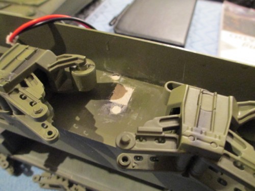

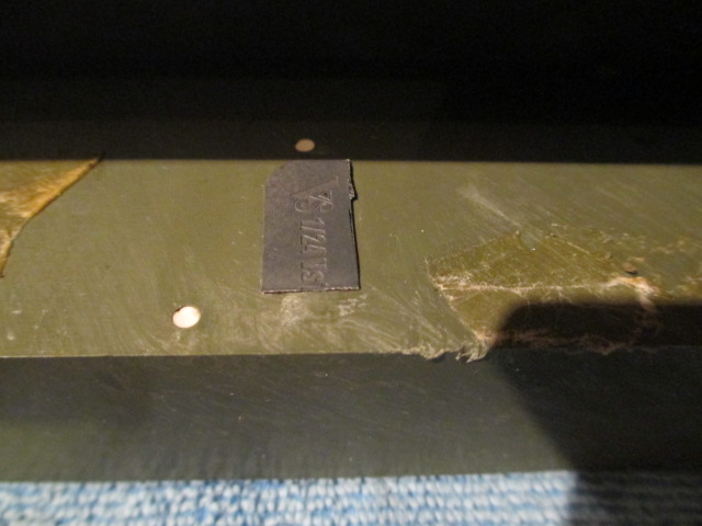

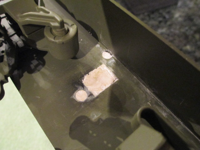

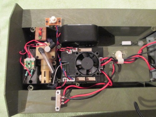

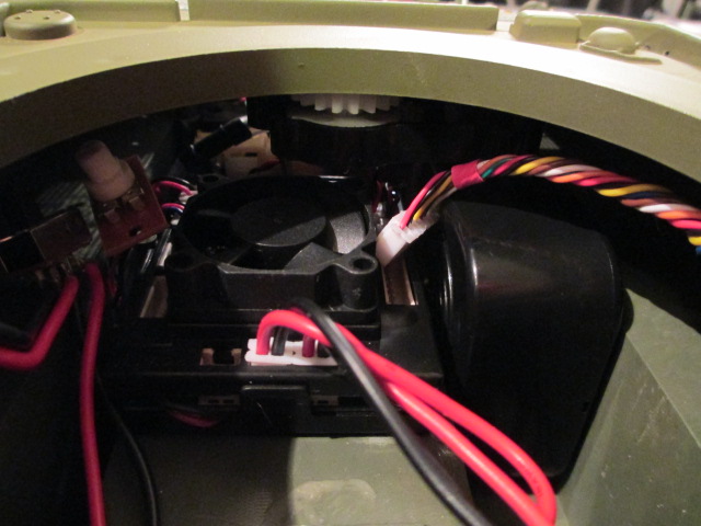

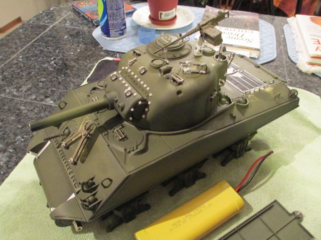

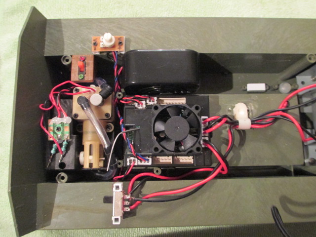

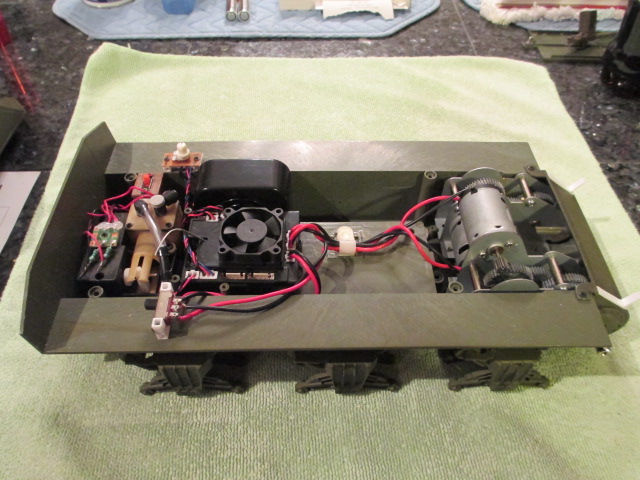

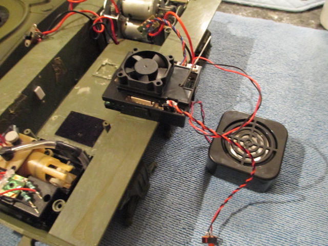

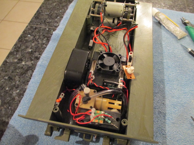

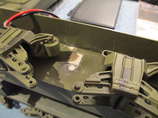

48th Day: Pretty much finished the Electronics tonight. All that remains is to mount the switches and wire tie the wires back into a semblance of neatness. As Scalawag had warned, space is at a Premium inside a Sherman's hull, at least if you leave the battery box in and plan on using your airgun. I found myself removing a piece of plastistruct I had put on the sidewall the night before to cover an old switch mount and also removing a four inch length of the interior battery box step out where it is molded into the lower hull. Both sections were replaced by thin brass glued into place. This was necessary to allow plenty of room for the new Taigen speaker enclosure to slide all the way to the bottom of the lower hull on the side and clear the turret rotation box mounted under the top of the upper hull. The speaker was mounted with clear, removable double sided tape on the bottom of the enclosure which left a quarter of an inch of clearance. After the speaker placement was figured out, the RX-18 with the fan slid neatly to the rear and was mounted on the top of the battery box beside the smoker with the same type of adhesive tape. It is now well out of the way of the airgun mechanism's rotation and elevation\depression paths. Pictures:
Quarter of an inch clearance between the turret rotation gear box and the speaker enclosure.
Quarter of an inch clearance between the turret rotation gear box and the speaker enclosure..JPG (97.38 KiB) Viewed 2215 times
Electronics installed with switches laying in their rough locations
Ready to actually install the Electronics
Exterior of the switch filled in with putty
Hull side switch hole recovered with thin brass sprue
Hull side switch hole recovered with thin brass sprue.JPG (80.82 KiB) Viewed 2215 times
Blythly setting out
Blythly setting out

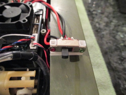

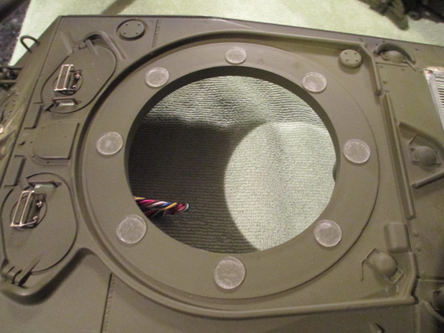

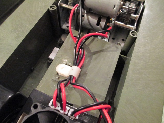

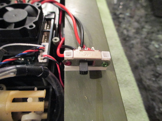

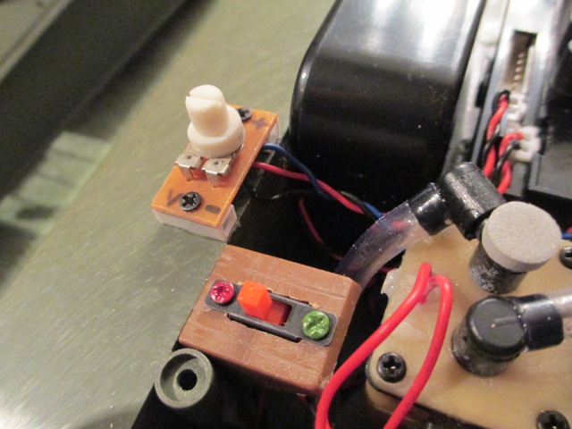

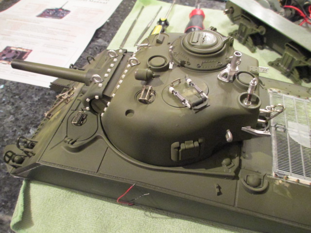

49th Day: Scalawag, thank you again, Sir. Alpha, at first, it seemed difficult to anticipate given the lack of space and having to make sure that everything had clearance but tonight was fun. I got a late start due to an event out. I wanted to install the two switches and the sound pot and get a test done with the battery so I could move onto wiring the turret tomorrow. First, I wanted to mount the turret back to the upper hull so I got out my self adhesive plastic slides and put 8 of them down. The turret now rotates like it is on glass. Moving on to the switches, for the Smoker on\off switch, I found a neat little plastic corner that you would use to put two panels at right angles. It had screw slots already cut into it so all I did was enlarge one of the slots to hold the smoker switch then screwed it into place. I glued it to the interior wall under the engine bay grills. For the sound pot and the Power on\off switch I built switch mounts out of square tube plastistruct. Very neat and easy to glue down to the hull once the switch and pot were screwed into place. Next I found a small wire guide and used some double stick tape to install it and get the Motor and Power wiring out of the way. Both of the switches and the sound pot can now be accessed by opening the engine bay grills. Lastly, I sanded smooth the putty fill on the old hull sidewall switch hole I had covered with the brass sheet the night before. Pictures:
Real progress has been made
Putty filled switch opening sanded smooth
Putty filled switch opening sanded smooth.JPG (86.67 KiB) Viewed 2246 times
Everything in the lower hull tested and working
Single wire loom to keep the wires out of the way of the airgun
Main power switch secure in it's plastistruct mount
Smoker switch and Sound pot installed close together
Turret back in place and easy to rotate
Self adhesive plastic slides installed as a turret race
