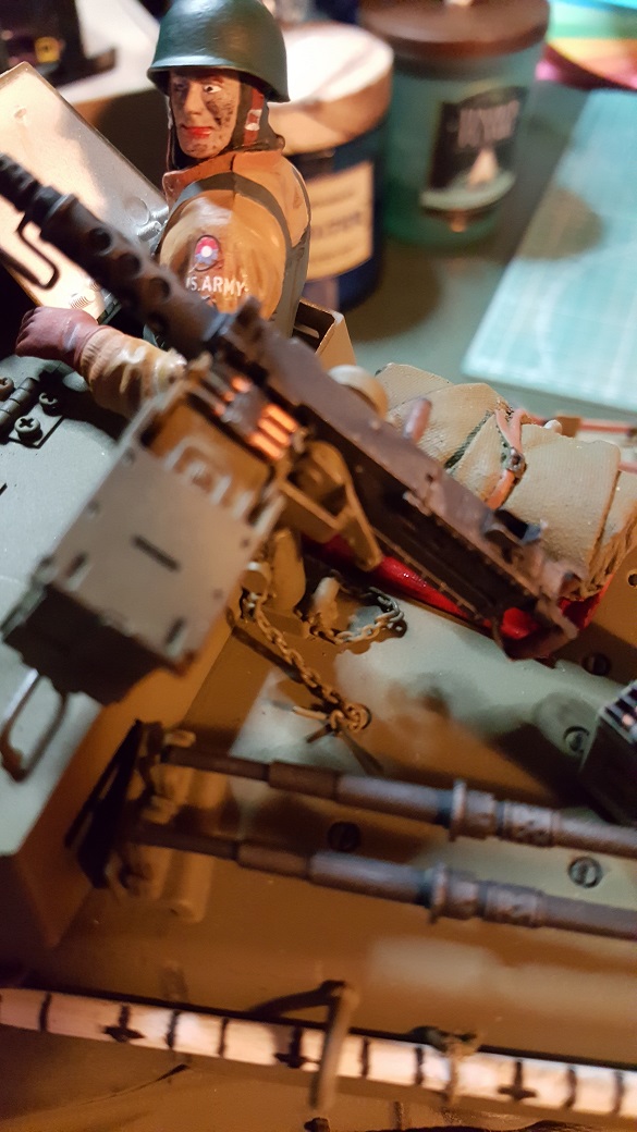

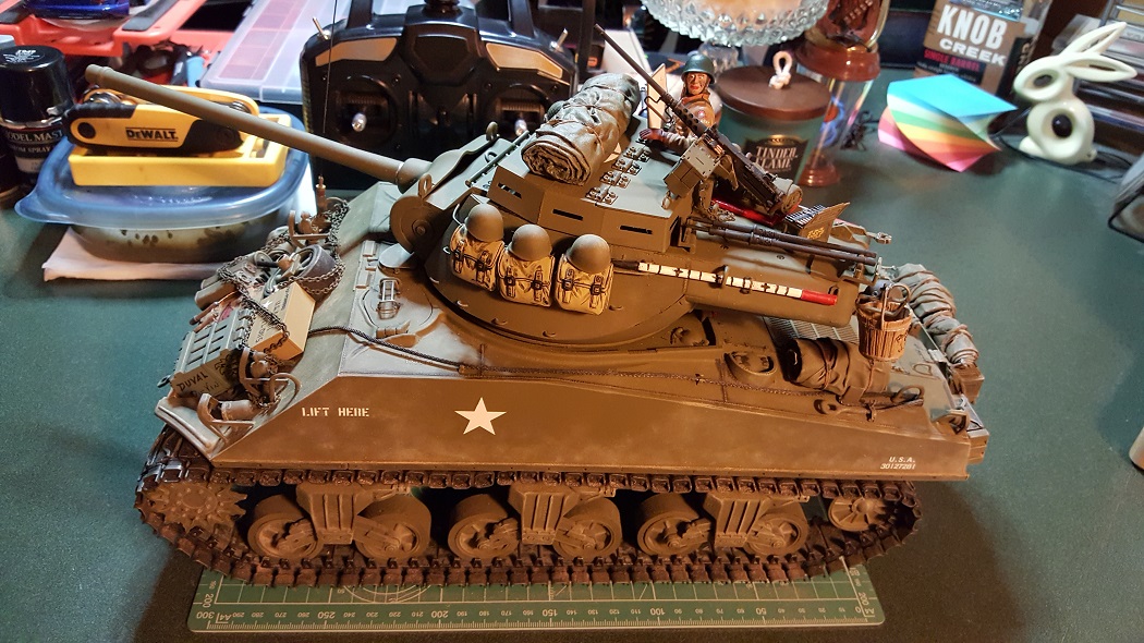

07 12 2017 Complete...
Fresh off of the spray table with a couple of coats of Model Masters Flat Lacquer.

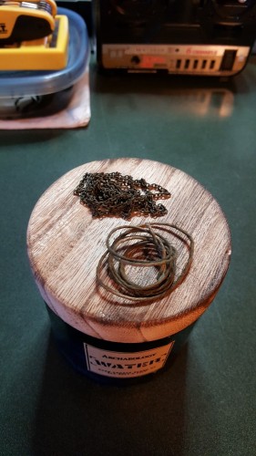

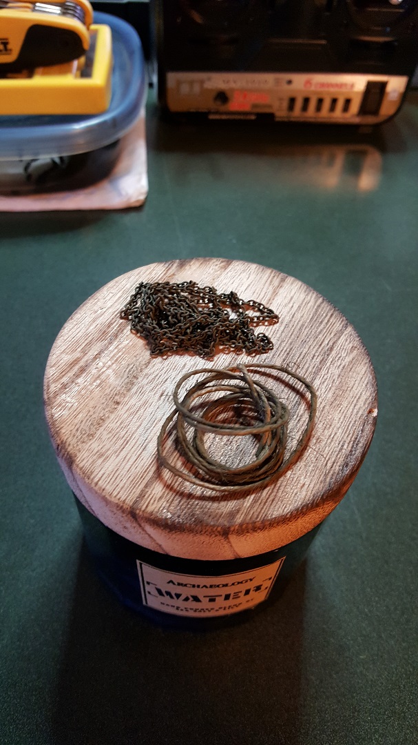

Scale chain and rope from Hobby Lobby

One thing I was wondering and meant to ask you (and trying to figure out myself) is with the tow cable arrangement (i.e. retained across the glacis plate, under the stowage plank/platform, and clamped to the lower gearbox cover) how do you go about removing the upper hull for routine maintenance and battery charging/replacement, etc?
Posts: 7877
Re: 1944 M36 B1 Tank Destroyer
Doc Phibes! Good morning!
I learned a valuable trick here on the Board back when I was trying to figure out the stowage on 'Maxene'. I was told to use clear, removable 3M double-sided tape to make single blocks of stowage out of all the disparate pieces. ( as many as was manageable ) I still use that trick and in the case of the front stowage on the M36B1, the block I made of all the pieces is attached to the stowage plank with the same tape. So, to remove the upper, you have only two additional steps added.
1. Pull the stowage plank straight out from it's mounts. This will remove all the front stowage as well ( excluding the spare road wheel and small pack which are fixed to the upper )
2. Open the Schumo snap friction clasp holding the tow cable to the front mount and move the cable out of the way. This will allow you to remove the upper normally. ( open the rear grills and remove the screw there )
The chain on the front and the rope on the rear rack is all for appearance sake. The hidden tape mounts are what holds everything stowage related in a secure mount on the tank. I'm looking forward to relaxing and watching what you and the rest of the guys who have these vehicles do with them. ;o)
