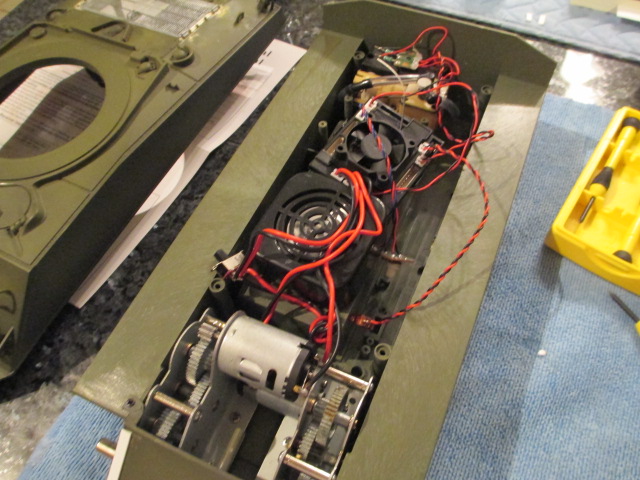

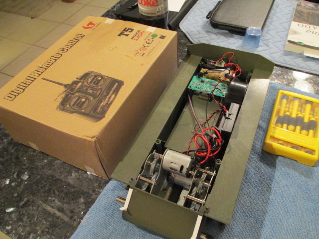

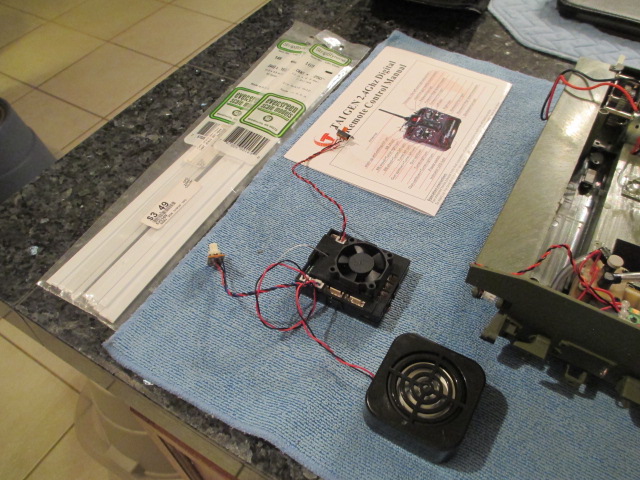

46th Day: Tonight was electronics night and sadly, I was limited to an hour when I needed two. I satisfied myself with swapping out all the plugs on the two RX-18s and unscrewing all of the switches and the pot so that they could be remounted in the back under the engine bay grills. It was interesting to set aside the receiver board with it's attendant antenna wire and crystal. I now have a complete RX-18 set with #1 crystal that I will have to think up a use for. I do have two old Tiger 1s and my Pershing which could all benefit from an almost direct swap out. More thought required. Back to the Sherman at hand, I will try to mount the speaker in the back there as well to make the best out of the clearer sound from the Taigen speaker. We will see, I have to sleep on a mounting plan and come back to it tomorrow. Pictures:
A pattern begins to emerge

A wiry mess

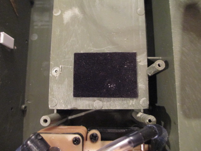

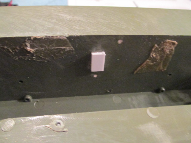

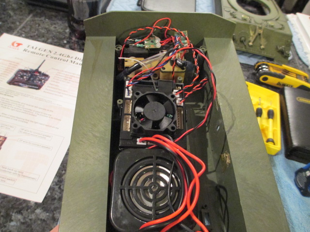

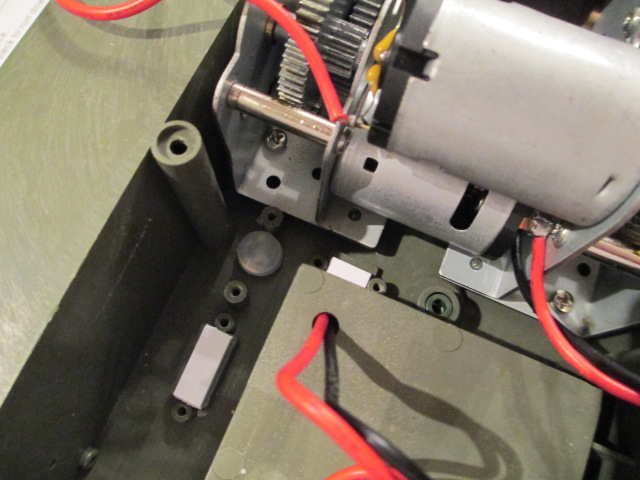

47th Day: Some items anticipated in the post now, optical fiber rods to complete the bow .30 cal and yet one more bit for the turret. Tonight was Electronics Night #2 and I spent it cleaning up the lower hull and sealing off the slots for switches and the pot. I have figured out a way to mount the switches, now I need to make sure that the airgun will clear the components off to either side of it when the main gun is elevated and the turret rotating. The fan on the RX-18 is a nifty idea but it makes the board more cumbersome than it should be...Pictures:
Crystal slot cut down and filed smooth and sealed with a plastic card with velour on one side for cushioning

Old and empty selection switch slot on the lower hull sidewall sealed off

Switches and sound pot hole sealed off with plastistruct

Hi Painless,
I have fitted one of these systems in two shermans and found the best way to mount the MFU with the fan on is to pop off the bottom plastic cover and replace it with insulation tape. It will then fit in the same gap that the old rx18 did between the battery box and hull side.
This is actually a ploy that Taigen use to fit one of these into their Pzr IV where space is very limited for the MFU. They come from the factory with no bottom plate on the MFU and with the bottom of it hot glued directly to the hull.
Another way would be to leave the bottom plate intact and remove the fan. The fan looks great but I have run these units with no fan with no problem what so ever. They don't seem to overheat anyway. I wonder if it is perhaps a bit of a sales gimmick or only necessary for the very heavy tanks which will draw more current when moving. It is all extra draw on battery power whether it is serving a purpose or not :)
I suspect other solutions may require removing the battery box and having some sort of quick release system for the upper hull to remove the battery. I have moved on now to other control systems but this still seems the best option for MFU mounting.
With the switches I swapped the main switch for a mini toggle switch which is positioned in the rear hull plate above the left track. When the top hull is in place the switch cannot be seen at all, but is still relatively easy to operate. The smoker switch I don't need now as I am using the IBU2 board which has the smoker controlled from the TX. The speaker pot I upgraded to a better quality one with a metal base and hot glued it direct to the hull.
Hope there might be something you can use there :thumbup:

Good Morning, Scalawag,
Those are all excellent ideas. I will end up going one of those directions . It was that or lose the airgun capability which I kind of like having. This gun is a good one. Thank you, Sir.
