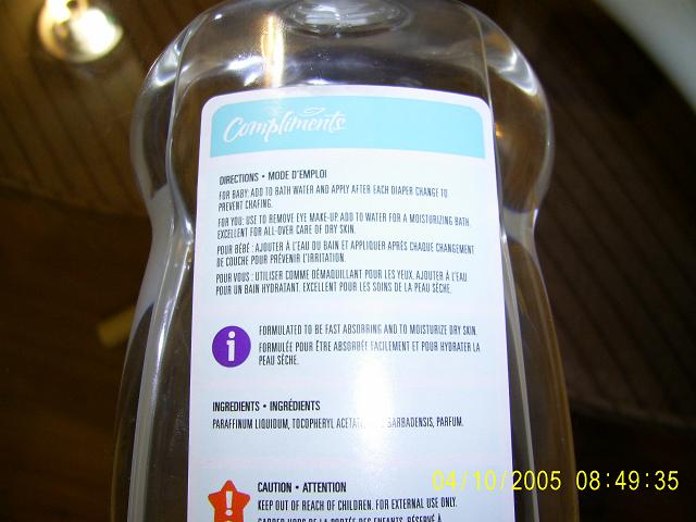

You can buy the mineral oil at any drug store ; but I personally prefer baby oil ( which is mineral oil with added perfume ) that is available at any grocery store and cheaper ...I drove my tank inside my 1 bedroom apartment this winter and appreciated the "baby powder' smell of the baby oil .... :haha: :haha: :haha:

Baby oil , when heated past a certain temperature will produce a thick smelly white smoke ; which is probably toxic ; given the fact that liquid paraffin is a by-product of oil refining ...
For that same reason , you cannot mix baby oil with oil used in aromotherapy because those are water based ....
