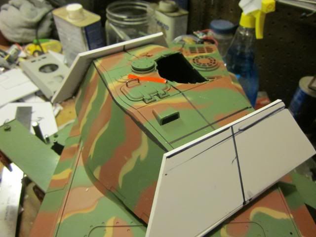

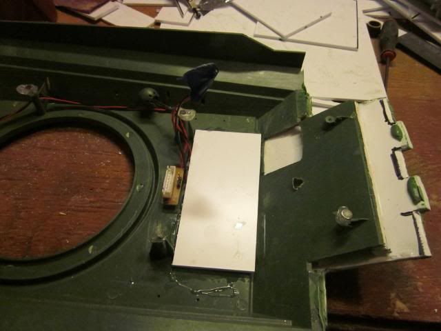

Still trying to get up the currage to cut the top off of the turret....it needs to be done to get this look...
But that means I will have to mess with the gun elevation thingie.....

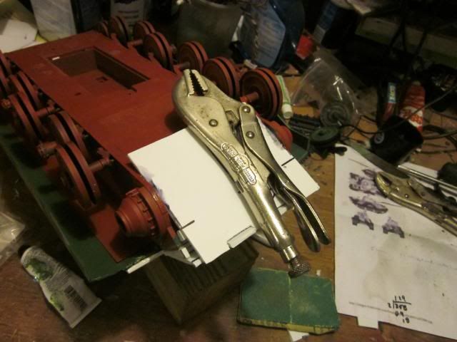

I'm back....started on the lower front plate.....

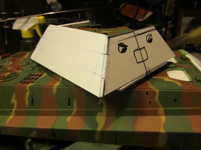

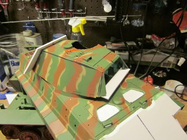

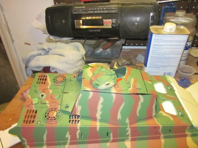

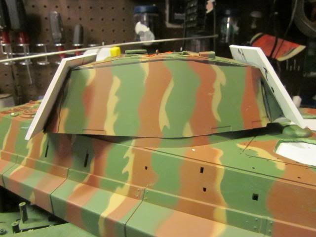

Last night was productive.....started on the toeing hook mouning points.....
and then the mounts for the working hatches......
omg, what have I done!

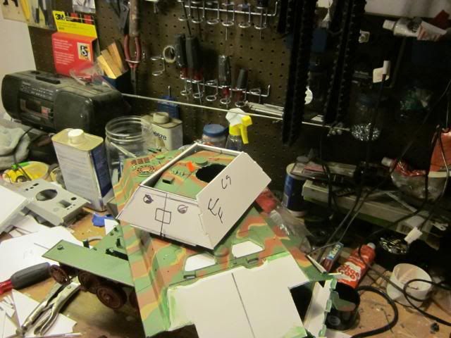

here is the rear of the turret and the shelf for the front of the turret....
another angle....
and the fitting of one side.....E50 mad!
I better do the other side.....
the e50 has a clubhouse on top of it.........Well the glue has set so back to the lower hull...
I'll see what I can get don this weekend...

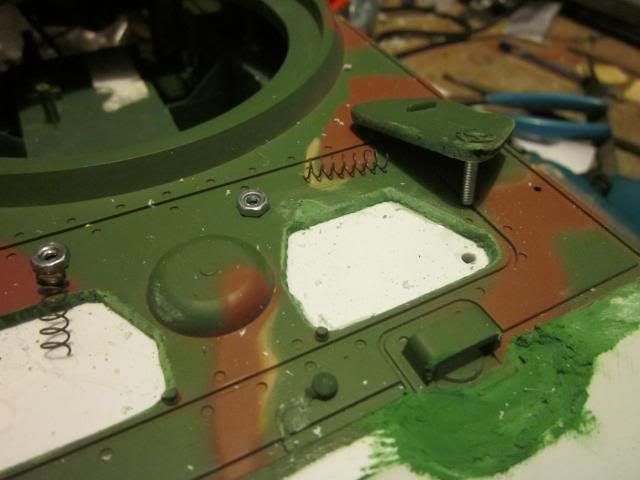

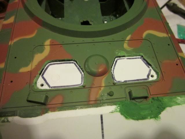

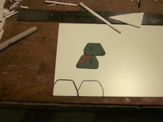

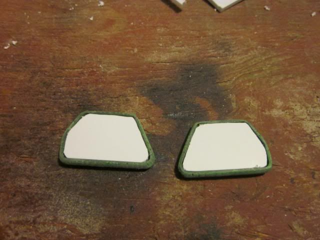

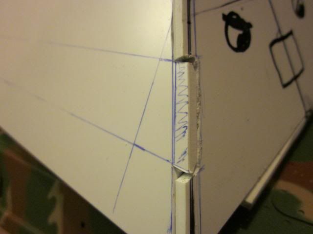

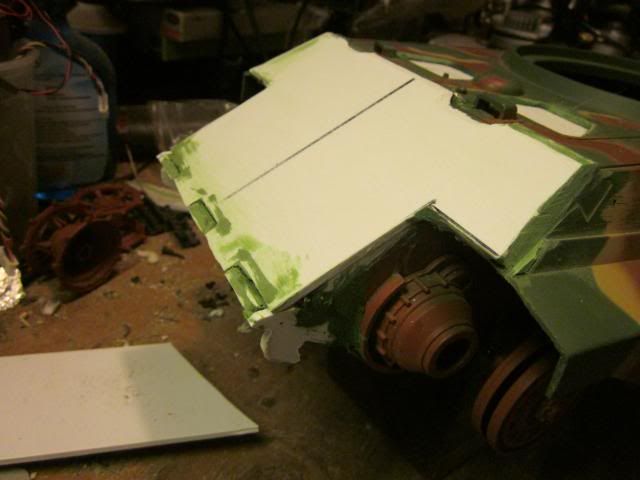

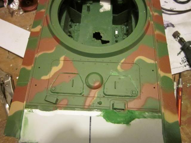

For the one or two people following this...here is the next step....hatches, they got to open imo. Here is how I make them work.....
I already cut them out using the drill method. I cleaned up the edges and added some green puddy....I also added a sheet of 2.5mm plastic card under them...
next I need some liners for the under sides....
and "like a glove!" * in the Ace Ventura voice*

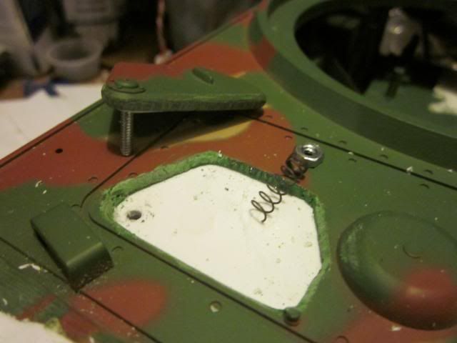

next its time to find the center line for the mount....

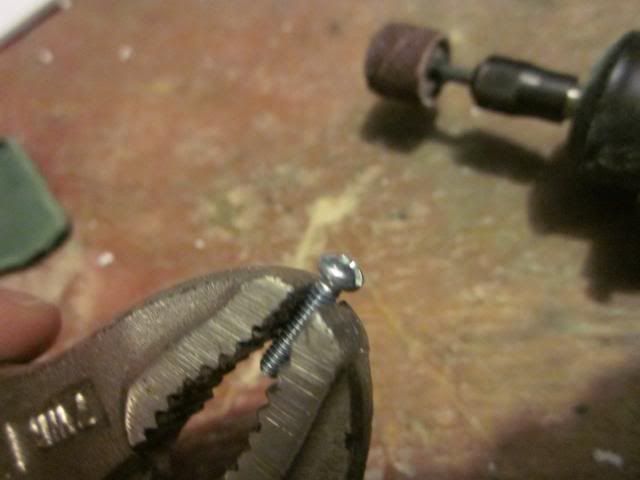

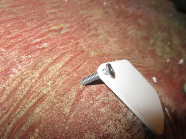

Time to mod some small bolts.....
then you sandwitch bolt in the liner and glue the whole mess togather...then add a small spring and a nut and tou have a spring loaded hatch...

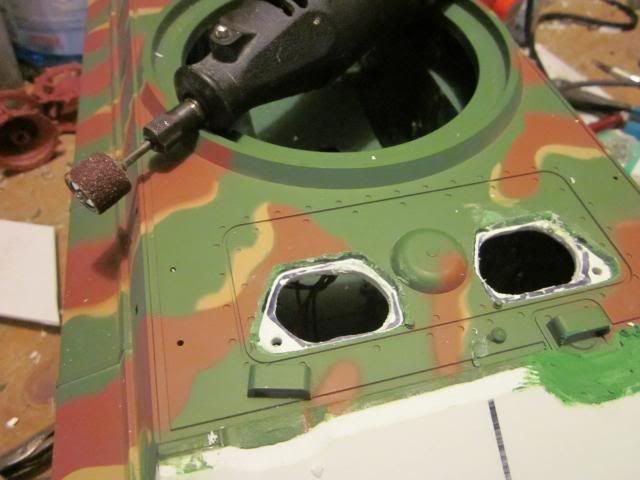

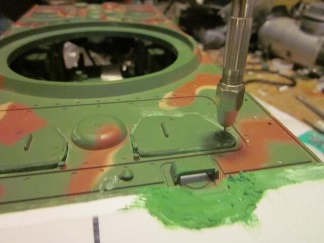

Time to mark the hatch openings....
and its dremmel time....
well that was last night......
