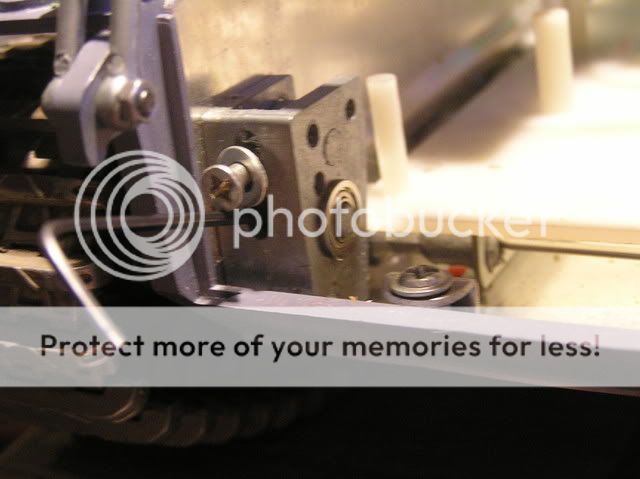

HELP ive bored out where the tensioners go where the original idlers were but i cant get the arm on the tensioner through the hole ?

Sorry for the late reply Steve , I take it you have the cast metal type ? - If so you can undo the grub screw holding the axles in the adjuster block , pull out the axle , fit the blocks and reinsert the axles from the outside . :crazy:
  • Image
Mine came already fitted but this shows where the screw is , It is a fiddle but unless someone else that has done the conversion can say otherwise , it is all I can suggest :problem:
