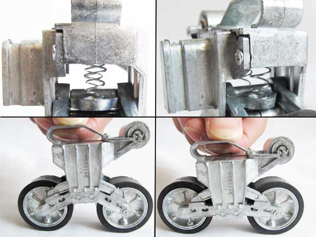

This continues to be a great Firefly build, Dan. I am taking notes & saving pictures to help me with my own - all of your details are both well thought-out and well executed. I enjoyed watching the video of how smoothly the barrel recoils & elevates, too. And you're right - it does look funny sitting on the larger Tiger hull; I didn't realize the difference in size between the two turrets.
With these new metal bogies, and the option of converting a Tamiya sprocket to work with these tracks; all we need now is a metal idler wheel for a pretty bullet-proof set of running gear.
-Mike
-Mike

Thank you again. I used all the reference material I could find. Many color photos of the different variants that I could find. I did what I could with the idler. I had the idlers bored on a lathe to 7MM and used 7X4 MM flanged bearings. Being the plastic on the Mato idler is so thin, I reinforced them with Miliput before having them bored out. It worked well. I'll post pictures of that tomorrow.
I agree that Mato, Impact or someone else needs to come up with a metal idler bracket and idler wheel. If they do release the T54 metal tracks it will be almost a necessity for durability reasons.
The metal componets will be the answer to Tamiya durability. I look forward to seeing them.
-Dan

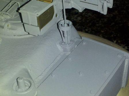

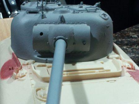

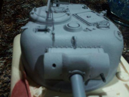

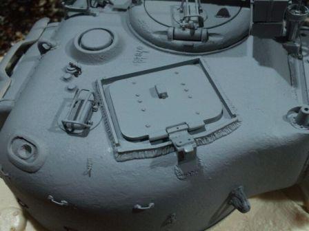

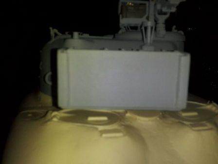

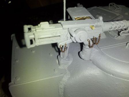

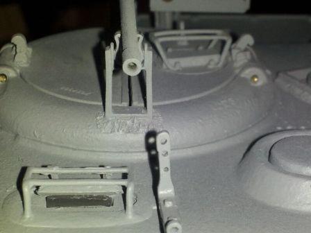

I finally completed the turret. I tried to catch all the details I noted on the protptype. I even put the spot light cover on with the retainer chain. Anyway, here it is in Tamiya primer post completing the cast texture with Mr. Dissolved Putty. I'm starting the hull before I do the suspension next, Enjoy!
-Dan

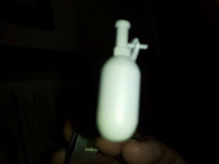

I completed both of the fire extinguishers common only to commonwealth armor.
A bit of plastic tube, plastic hex rod, a punched circle and brass .028 rod.
-Dan
-Dan
