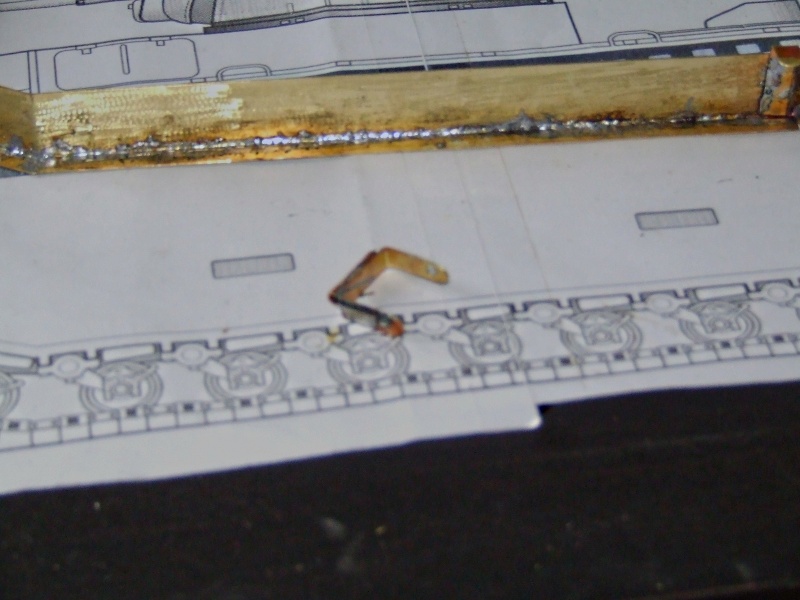

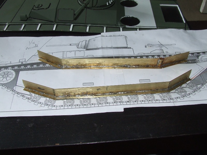

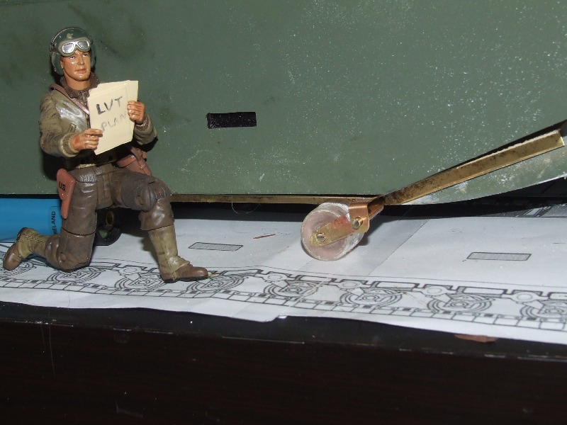

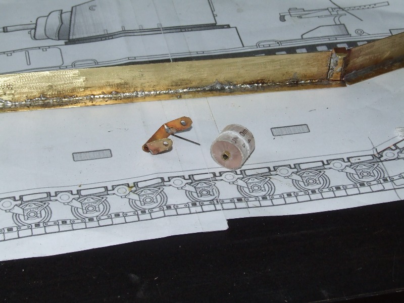

Tracks arrived so now on with the suspension fit. This is very much prototypical so I am open to suggestions. What Ive done for strength is fabricate a brass mounting frame across which are support arms for the 12 wheels each side. Each wheel is mounted on a "U" bracket with a Steel Wire spring for suspension. Each "U" bracket has a brass tube soldered to it to attatch it to the support arm and give it a movement for the suspension. I am still waiting for wheels so the wheel in the pictures is one of my prototypes made by filling a 10ml syringe with resin and cutting to width. I will screw and epoxy the completed frame to the hull sides and pontoons.
