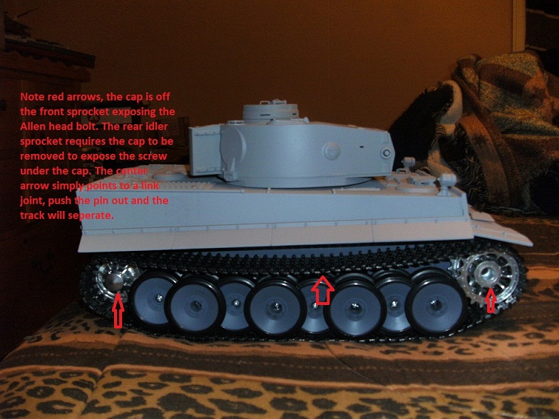

New to all this, just got the Tiger 1, when running it there was a clicking noise coming from it when turning, thought it was a gear at first, but on looking I found that one of the idlers wheels had a chip out of it, the drive wheels and the idlers have play in them?, would like to take the track off but don't know where to start.

Best way to remove the tracks from a tiger 1 is to remove the center of the drive sprocket (this is only a push fitting so pulls out easily) & theres either a philips screw or an allen bolt in there to undo then pull off the drove sprocket,
then put a screwdriver through the hole in the center of the idler wheels and unscrew them & the tracks should come straight off.
primer2 005.JPG (210.53 KiB) Viewed 2293 times
This may help, Sax

I've taken one of the tracks off to try and mend or replace a broken idler wheel, chunk missing, I think its plastic?.
