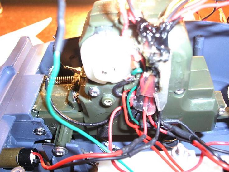

It is the best thing about this forum,and these problem's keep the interest alive.Phil is a very skilled person and I can understand your frustration.I have a gun system that has cost well over 240.00 and it still does not work correctly,the vendor I purchased it from has given up long ago,I have been waiting since March for the new system to replace the one I have.I went through all kinds of trouble,I disassembled the turret so many times the screws would not hold any longer creating another problem,fried my RX18 and Receiver board.not to mention burnt wiring.check this out.
